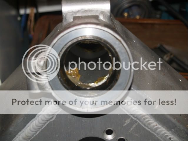

The standard FAG brand bearing allows variable rake angle to be used. You only need to change the top spacer (make progressivly offset ones) The bearings (barrel shape) will automatically align.
neat idea aye.
Insert is a piece of cake to make & press in the race.
Glen
trying to work out what the top spacer is. Do you have a part nos or able to describe in more detail? Looking to reduce the rake on my Yb10.
neat idea aye.
Glen
Thanks
Presume it's the same system as the SB.....Bimota's simple adjustment system.....offset spacers for the bearing to sit in. HTH Wink

Hi, I have some of these bearings in stock. I used to work primarily on Bimota's and serviced pretty much all Bimota's into the UK between 1994-1998, and therefore have many parts still in stock.
The reason you are finding it so hard to find the bearings is because FAG did not actually produce bearings for Bimota and Bimota had to have these specially ordered and produced.
I have 9 in stock if people are interested?

Many years ago I was told that the steering head bearings used were shared with a Mercedes truck
Keith
chazawatsit
Joined: 15 Jul 2013
Posts: 25
PostPosted: Mon Jul 22, 2013 10:32 pm    Post subject: Reply with quote
Yep they were, I have emailed they company who used to supply them however they no longer supply them, he said they would sell them for £45.00 so my price is the same as any other company and are the only supplier Smile
