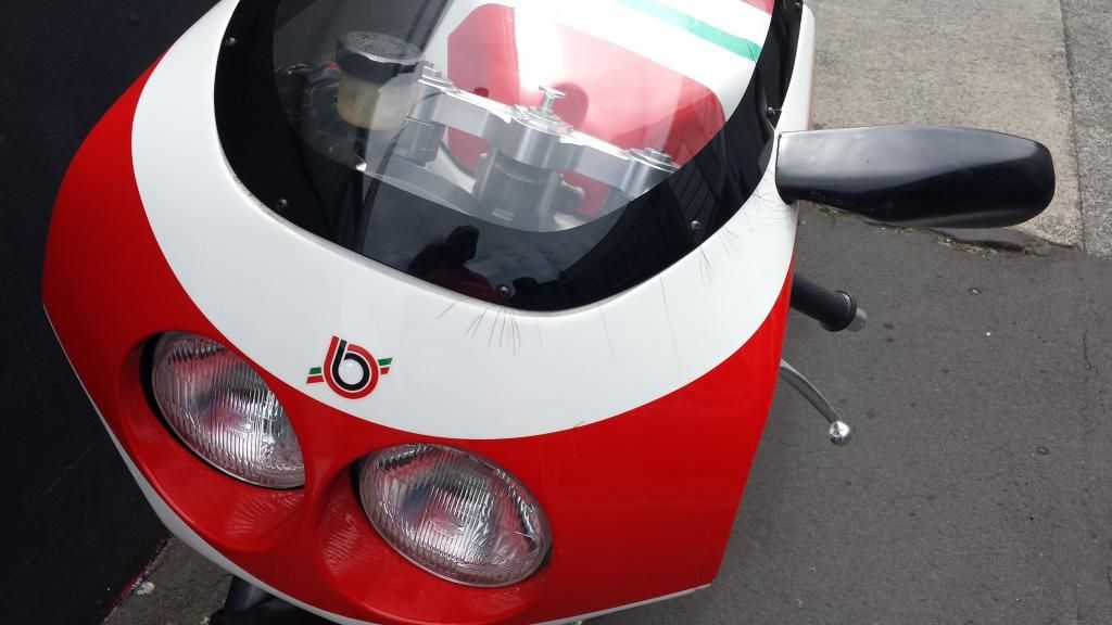

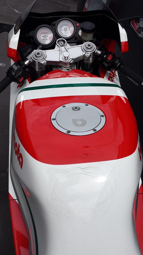

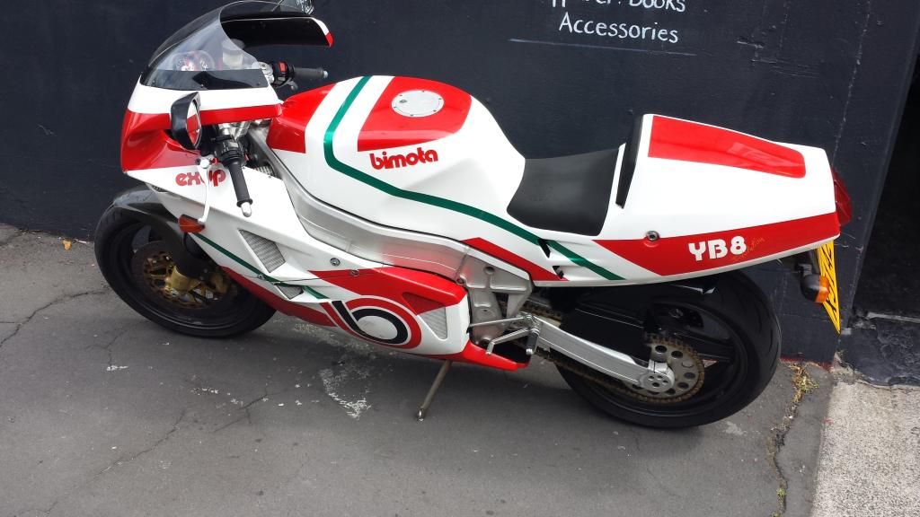

This has just arrived at the
http://www.carbon-garage.com/shop/superbikesforsale.html
Its in need of a bit of tlc
And has a side stand worse than my SB6 had
Shocked
Made me appreciate how mint mine is with the same mileage but of course its a lot rarer bike Wink

Somebody definetly had sore nuts on this YB8...... Laughing
Funny cracks around the windscreen....
