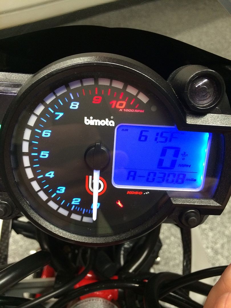

Well, I finally had a chance with good weather to ride the Tesi 3D. I purchased it with only 450 miles, so Saturday I reached the fist "service" interval. I've serviced the bike before I put any miles on it and was hoping someone knew how to reset the service light on the Koso meter. I found documentation on the Koso North America web site, but nothing on the reset. Any help would be appreciated.

Hi 2Bims cracked this for me some time ago. Basically start the engine and then hold in the start button for 15 seconds and the light should go off, dont do it why you are on the move as it will start the lap timer. Hope that works.

Yup...confirmed as Waggy says....The koso clocks are a pretty simple set of clocks...that Bimota have coded up for themselves and the service intervals for the Ducati engine.......They work independant of the engine/ecu....so the first service interval clicks in and the spanner light comes on at 1,000Kms....around 640 miles.....it should then appear again after another 6,000miles or 9,360kms,...
Even if the clocks are disconnected and removed from the bike...once installed again they will show the same mileage as before disconnection

Thanks Waggy light is off! Brian, I took the Tesi up to the North Georgia mountains. From my house its about 35 miles on the Highway until you reach the back roads to the twisty's. So the riding position is similar to a sport bike with clip ons, but much "tighter". I'm 5'7" 155lbs so it fits me really well, not sure if a taller rider would be comfortable at all. I adjusted the handlebars before I rode the best I could. I found myself on the Highway riding with a hand on the hip for more comfort. At low speed (below 65 mph) you are really pressed up against the tank, and it's not a good feeling. But once you get up to speed it's better. When I reached the more challenging roads and turns, my first impression was I had to really work to get the bike to "turn in". I instantly thought I needed to adjust the rake to get it to turn in better. But I just opened my mind to the fact that the bike is different and just really got my butt, head, and shoulders off the bike and dropped it in the turns. Of course I was a little nervous at first and didn't push right away. But I did push the bike a little and kind of bonded with it. I've read you loose front end feel with the Tesi, so that was on my mind. But I felt pretty good and could feel ripples and bumps pretty well while in a turn. Braking and handling bumps is where the bike excels to me. On a few occasions I felt the bike was "plush" over some bumps. That was surprising. It was my first ride so I still feel tons more confidence on the DB6, but the Tesi is such a cool machine and you really feel like your on something special when riding. Not to mention the excitement people have when they see it. Like myself, most people just see this bike online, so they are happy to finally see it in person.
