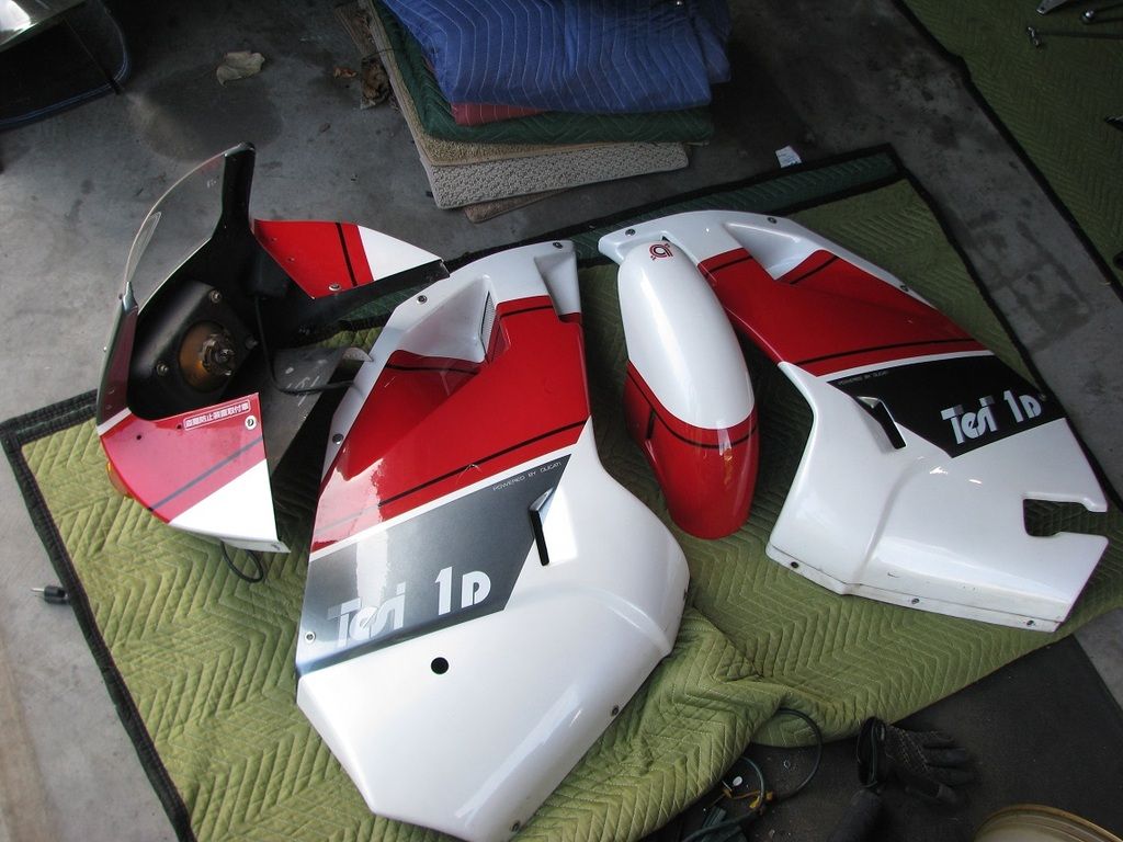

Finally got it home. Slightly crusty but complete. Everything is there for me to build my dream bike.
I continue to post build pics in this thread as I go along
