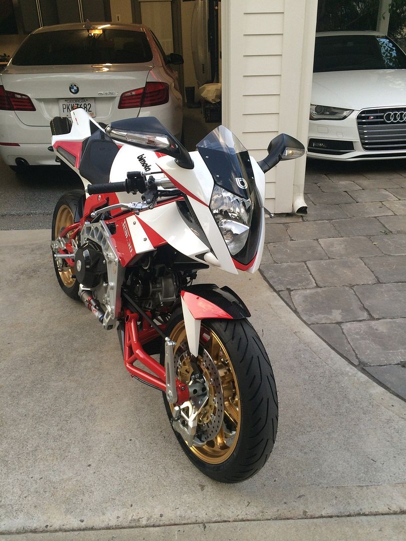

I spent so much time on this before I put on a new set of tires. I purchased the balancing "tool" also. The issue with my tire shop was the balancing machine "axle rod" needed to go through the wheel. The Tesi's hub steering does not allow this. On the old style static balance stands. the weather seal on the wheel bearing does not allow free enough movement to show small balance issues. In the end I slapped on a set of Michelin Pilot 3's, left the old weight on and it is perfect at all speeds to 100mph.

Here's the pictures of the process. I found working on the Tesi to be very enjoyable. You can get a sense of just how "hand built" the bike really is.
The new Michelin's

Awesome looking machine mate and nice pics too.
