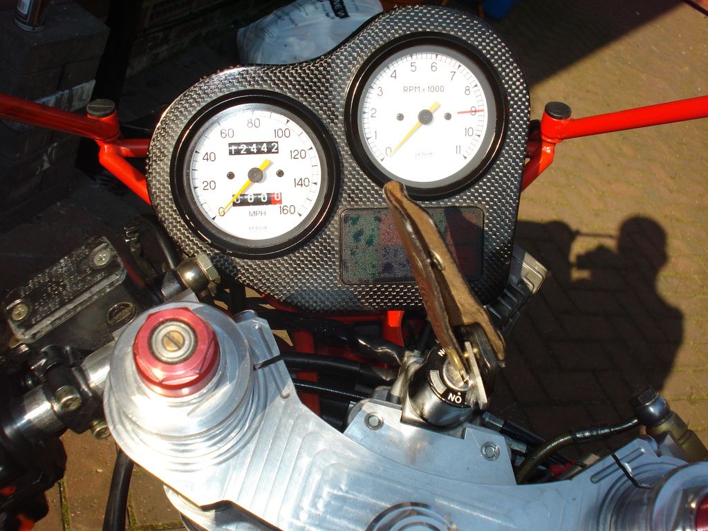

Heres my mirrors, I see what you mean steve, the ones for sale at BCP don't seem to have threaded studs!

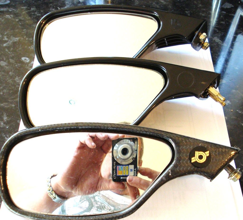

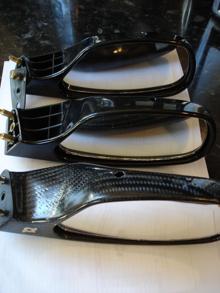

Looks like a another famous Bimota "constantly evolving development, products may be changed"......early stuff were blank mirrors with 3 holes in, the outer 2 being used with bolts to locate to DB2 bodywork and those extension stays...although I do have a set where the ball end of the brass studs has been cut off and the remaining hex section brass pin has been turned and threaded to accept fastening nuts......I see that you are "missing" the plastic plugs to the tops of your stays....still available from BCP I think....
Mirrors and changes....although mine are carbon fibre....just another change by its previous owner....

| Quite a collection you have there!, great info as usual, thanks, that saves me buying the ones from BCP. I will look on the site for the caps, mind you I find the BCP site a bit difficult to find things on!!. Are the relevant mirrors with the threaded studs off any other bike? |

I'm not aware of the threaded units being used on other Bimotas....ones I'm familiar with or DB4, Vdue and YB11...and they all employed the brass pins with spring clips on the back and one central bolt hole.......Mirrors are made by Italian company far....still available with the brass pins new or used...under Cagiva Mito...Plenty of stock left...and these could be turned up with a tap and die set to work
