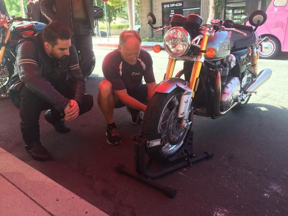

There were several dozen bikes parked as well as a lot of others coming and going and Dave Moss was under a pop-up canopy feverishly working on the suspension of various attendees bikes, one at a time. I slipped into the que and before long Dave was working on the DB6. He asked how aggressively I rode and I had to admit that while I could still go like a scalded dog, I tended to be a bit more cautious due to age and previous injuries taking their toll.
After what appeared to be 5 very fast minutes of work, Dave looked at me and said “Go ride it now”. I grabbed my gear, backed the bike up and took off around the adjacent neighborhood to try out the suspension on various dips, potholes, bumps and the like.

Well, all I can say was WOW! What a difference! It might still need some minor adjustment after I try some of Dave’s recommended riding techniques and suspension adjustment directions but it was WORLDS better.
I weigh around 185# (210# with full gear) and the bike was definitely more responsive. While the rear shock was setup close before, the forks were way off re: compression and rebound damping causing the suspension to pogo over all manner of road irregularities. I will continue to experiment but for now, the bike was a completely different animal to ride.

The suspension clinic also included a condensed, common sense explanation of how suspensions work, how and what measurements to take to help determine then what adjustments needed to be made to get a motorcycle to handle properly based on the rider’s weight, riding style, etc.
It is interesting that it doesn’t really matter how old or new a motorcycle is. It is either set up correctly re: the suspension or it is not. Some of the common fallacies are that the dealer or the factory must have set it up correctly, or the prior owner, etc. You really don’t know until you learn how to properly measure and adjust the suspension. There isn’t any “magic” but really just procedure and common sense.
Interestingly enough, many or the participants couldn’t tell when they last checked their tire pressure or changed their fork and shock oil. All of these will have a direct effect on how the suspension performs and can require some fine adjustments as the fluid ages. Personally, I change my fork oil with every oil/filter/belt combined service which is around 6,000 miles. It really is cheap insurance.

OK. So here are some pics from this event courtesy of the PI Facebook page. I can't seem to make them pop up smaller though...

HA quikduk, I just saw your thread. The clinic was a great idea, Dave was both knowledgeable and entertaining and it was a Saturday afternoon well spent.
