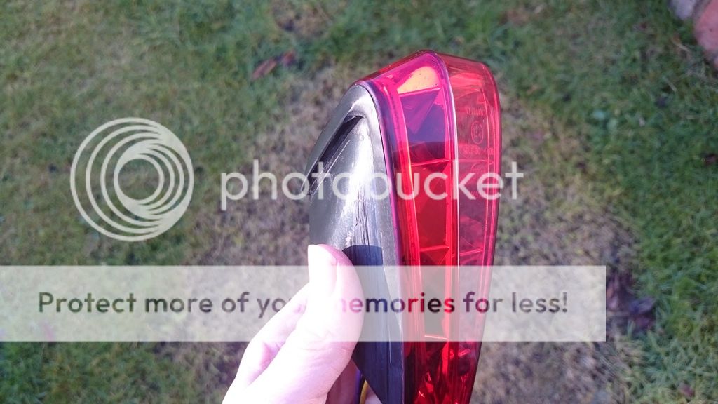

OK, finally got light to fit, been cut down a fair amount , literally down to the lens
LED internals look like they will go in the old light casing but the new lens is a different mount system so will not fit the old case.
Going to run with it as it is for now and see how in goes.
Will post pictures when I finally get it back together.

PostPosted: Mon Jan 07, 2019 2:24 pm    Post subject: Reply with quote
Realised I did'nt post any pictures of the completed led installed and as others have asked questions recently , thought I better had.
I wish to state :-
NO BIMOTA BODYWORK WAS TRIMMED OR MODIFIED IN THE FITMENT OF THIS LED LIGHT .
So here it is in all its glory.

PostPosted: Wed Jan 23, 2019 6:18 pm    Post subject: Reply with quote
Believe me I had to seriously file the body of the light housing down to get it to fit as I refused to modify the body work.
The original light on the left does not have the flange on it the LED one on the right does
This flange had to be removed in the area highlighted in yellow on the image below.
I removed so much material in the area highlighted in white that I created a hole in the case.
The actual light once fitted had a black silicone bead run around it to get a nice neat fit/finish as shown below.
