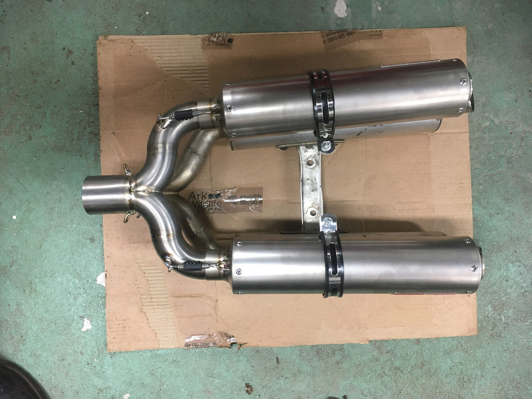

of course it took ages to be delivered. The can diameter is not a standard size so the 'tubes' had to be hand bent and welded. Then of course the end caps (which are 'spun' an a former) had to be custom made and the guy doing that was moving premises.... you get the picture !! After many txts and messages the cans were finally ready to collect.
very nice and clearly lighter than original but not quite as much as you might expect, as the central perforated tube is still steel. The OE twin exhaust and 1-2 section (incl bracket) weighed 3.7kg. The new set up was 2.5kg. However its all part of a plan to shave 20kg off the weight of a standard(full faired) DB2. Also its weight away from the C of G and high up.
However a quick mate up to the bike showed a problem. Due to the different bend shape of OE and Ti exhaust 1-2 section, that bit was fouling on the main frame
You can see the difference here with the TI and OE exhaust overlaid on each other
So 1-2 section sent back and a new one made.

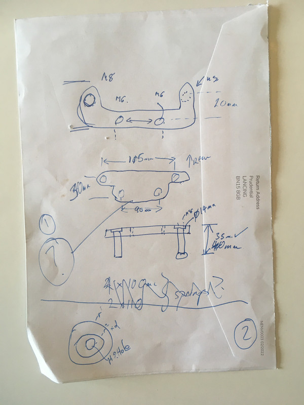

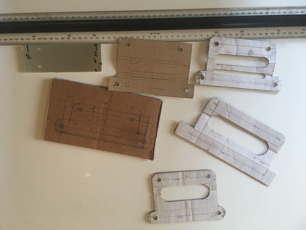

I then needed something to attach the clamps to and quickly came up with several sketches and tried various cardboard templates, each time trial fitting the seat/tank unit to check fit.
When I thought I had got it right I cut out a metal template (not pretty but all critical dims correct and tried it in place for a final check

satisfied with that I made a final dwg and sent this off to a company that would make it with waterjet cutter EVEN AS A ONE OFF ! at a very reasonable price also doing the bending and hole cutting. (themachine bending meant I could dispense with the 'slots' on my cardboard designs which were only there to ease home bending. Finished product wight is almost the same and now a lot stronger.
I picked up the final pieces in person as I didn't want at this stage anything getting lost in couriers/post! Here it is alongside my metal template.

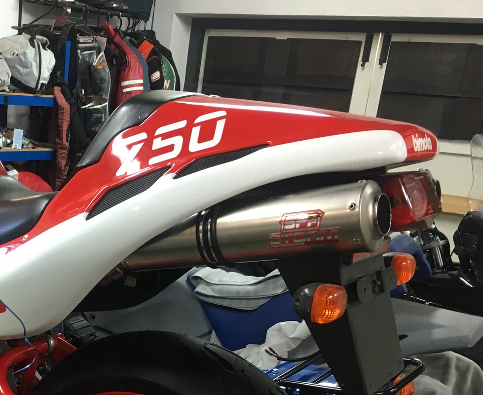

All that remained was to mount on the bike and check no cock ups made ! (Had to go for the Ti fasteners, vanity got the better off me!)
Looking good I think.
Apologies if the preceding posts are a bit long winded but I think its a good example of all the twists and turns involved in making custom parts to fit.
