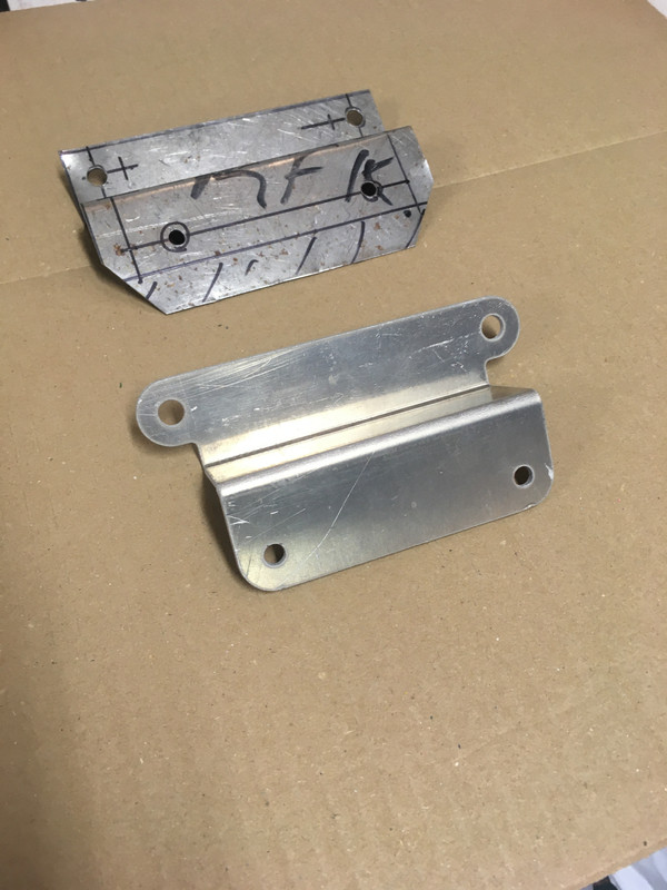

I then needed something to attach the clamps to and quickly came up with several sketches and tried various cardboard templates, each time trial fitting the seat/tank unit to check fit.
When I thought I had got it right I cut out a metal template (not pretty but all critical dims correct and tried it in place for a final check
[url=https://postimg.cc/bsmV2SVD]
[/url]
satisfied with that I made a final dwg and sent this off to a company that would make it with waterjet cutter EVEN AS A ONE OFF ! at a very reasonable price also doing the bending and hole cutting. (themachine bending meant I could dispense with the 'slots' on my cardboard designs which were only there to ease home bending. Finished product wight is almost the same and now a lot stronger.
I picked up the final pieces in person as I didn't want at this stage anything getting lost in couriers/post! Here it is alongside my metal template.
