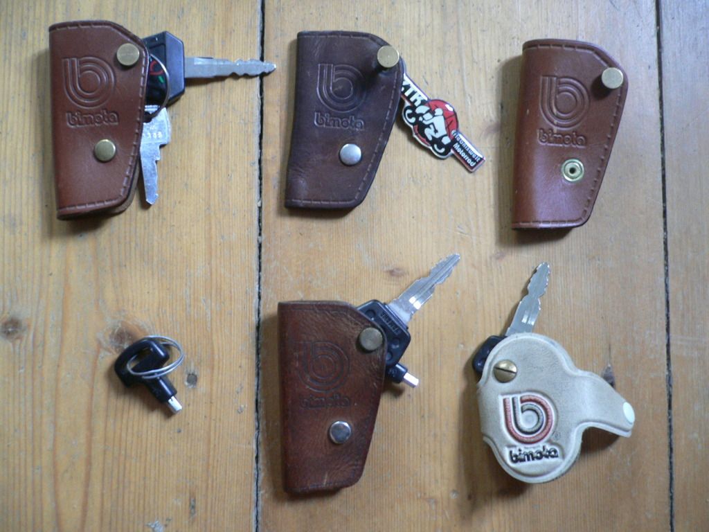

continued to collect key rings
finally got a proper plastic YB4 job (bottom right), instead of those flashy leather things. Much more sporty and very eighties.

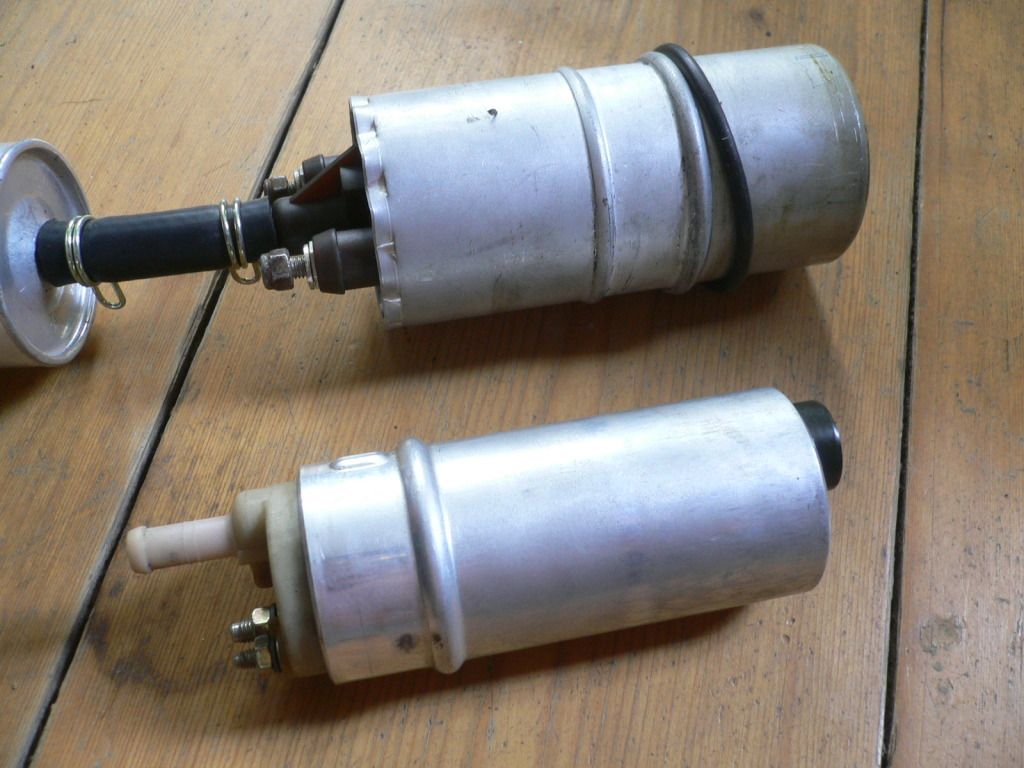

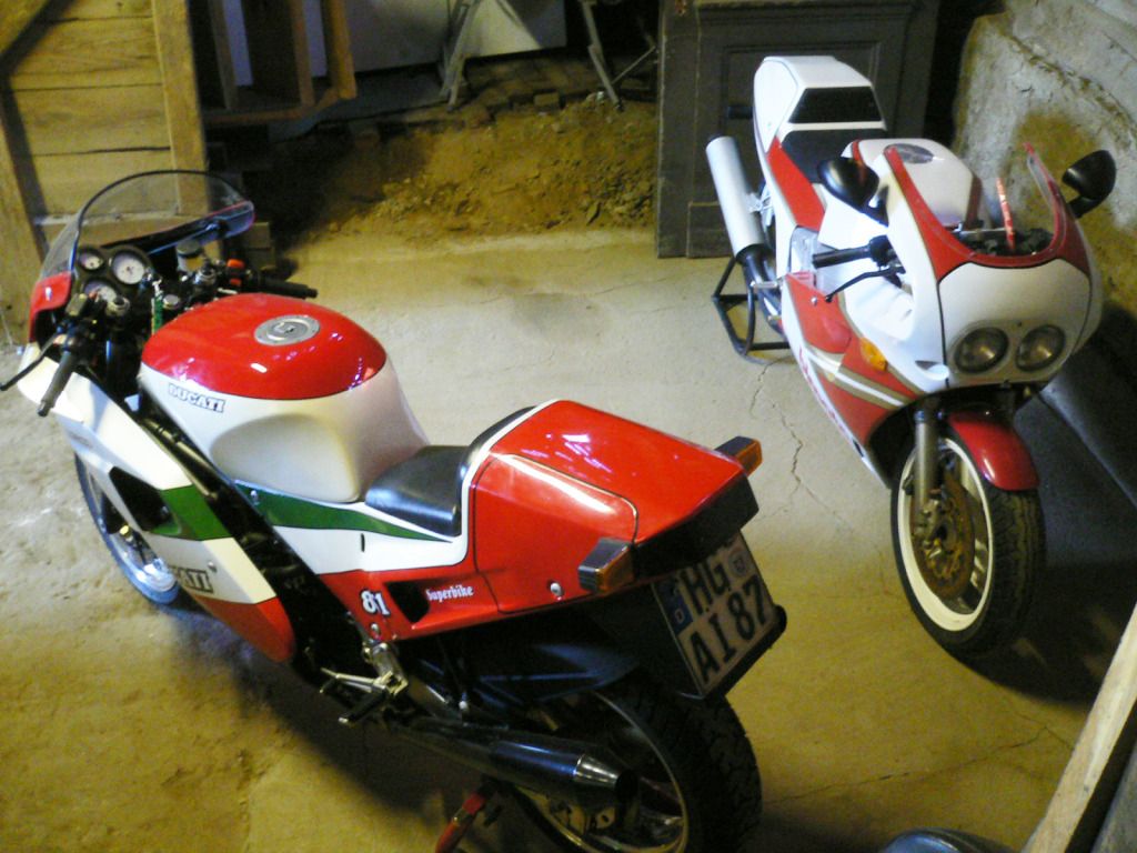

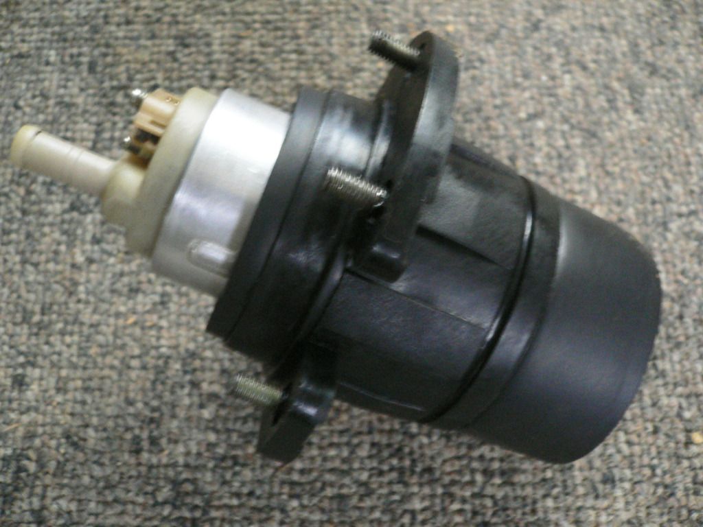

got a BMW fuel pump for the 851
which needs a sock on it to make it fit the hole.
but it means I can have my pump back please. Be able to get on with something.

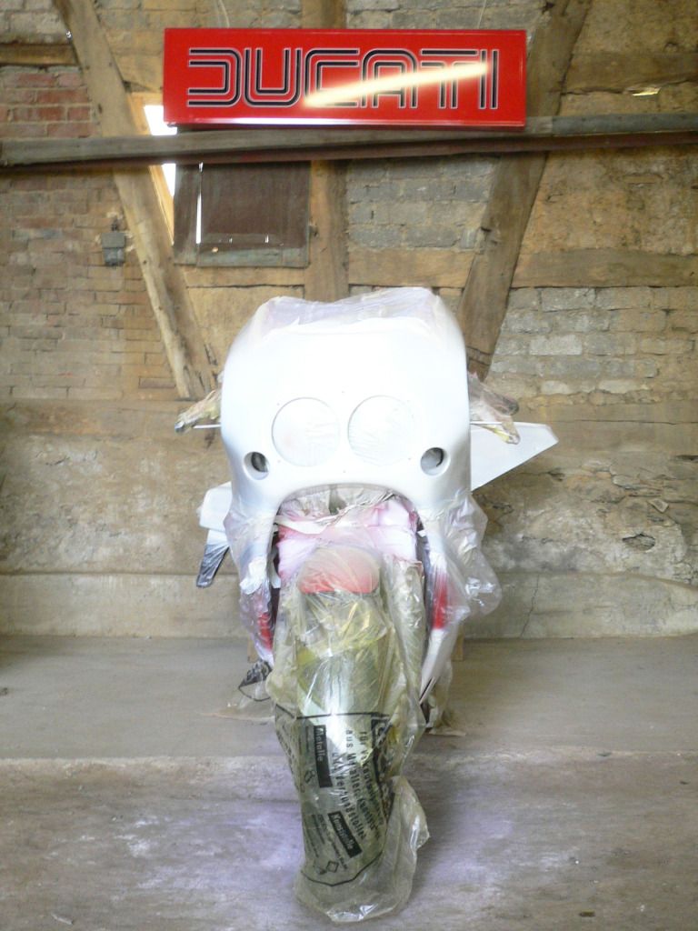

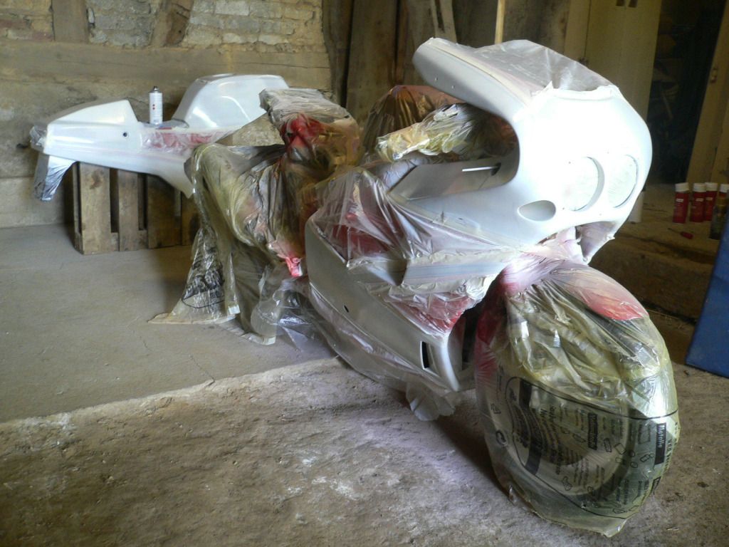

Then we arranged for friend Bruno to make some films about the bikes, which would be a lot nicer with a 'complete and painted' YB4, at least in the background. So bike out of the living room

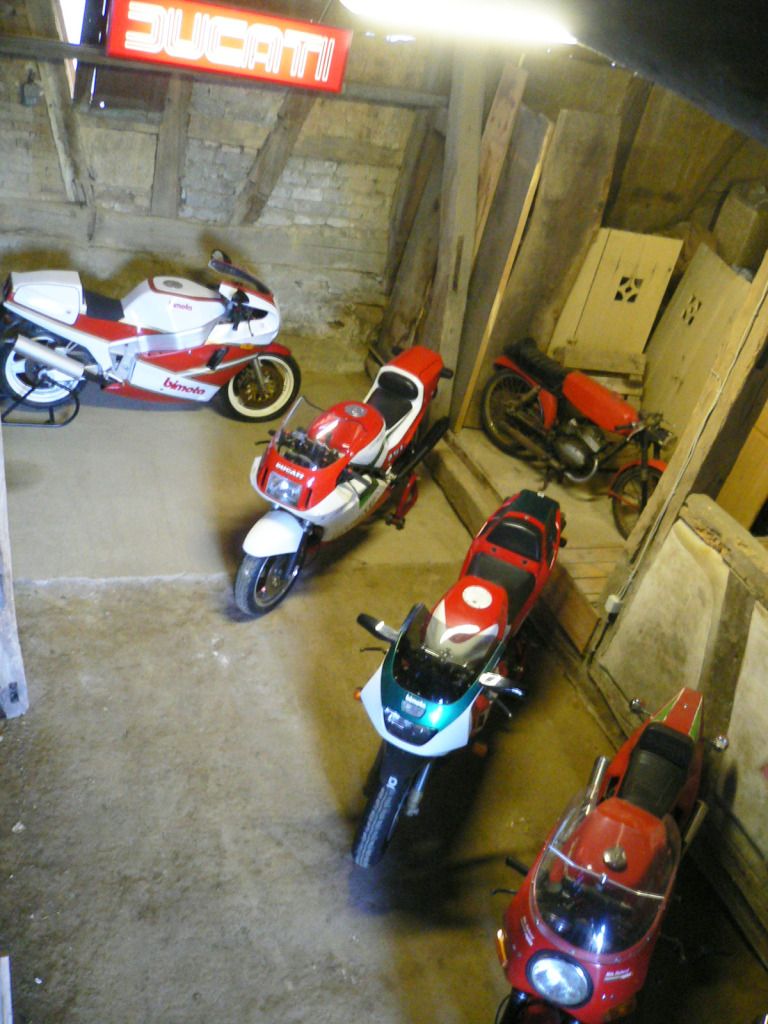

always nice to have a YB4 in the hall

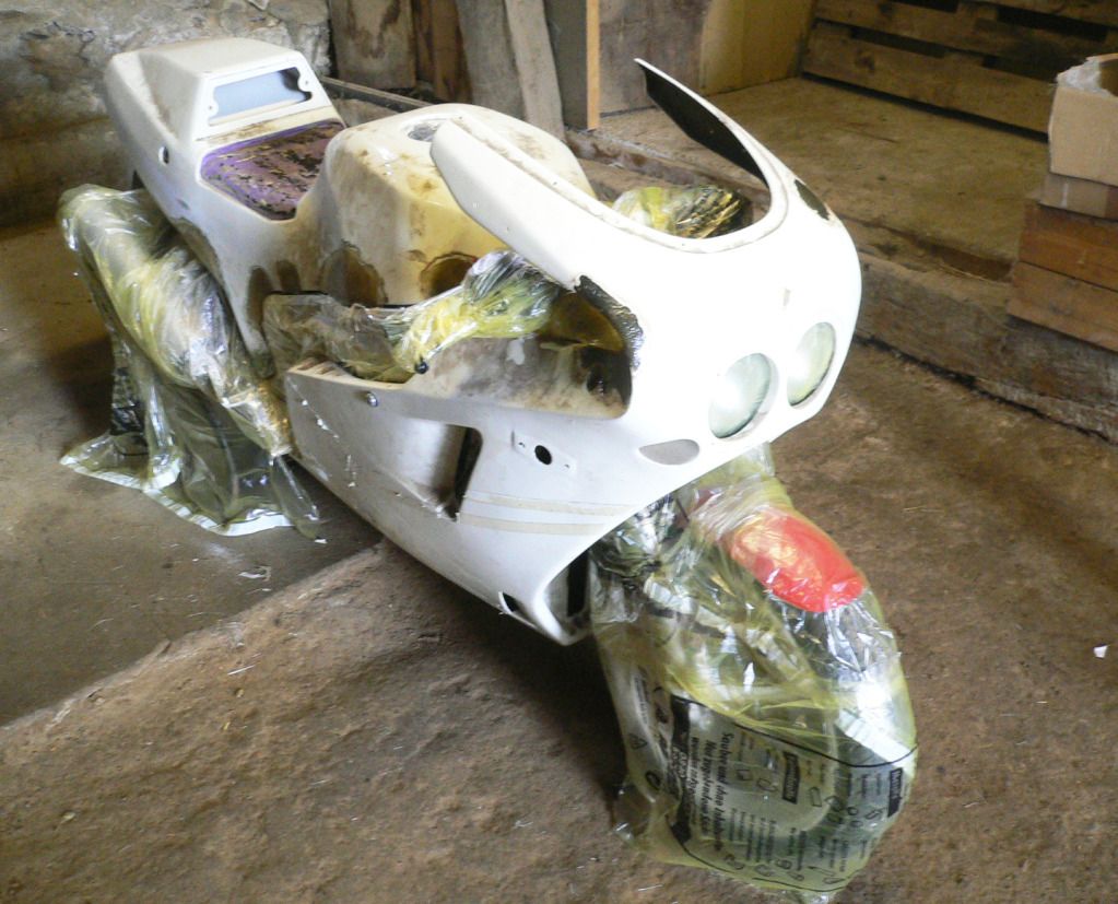

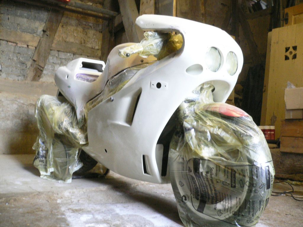

repair all the fibreglass cracks that I ground out 5 years ago
so it will only crack in the places between the repairs next time
some filler

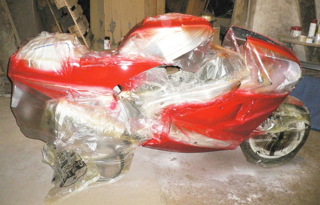

and a 2 day, spray can festival . . very rough and I only did the right side as it's all got to come off again to be rubbed down properly and prepared. Was missing a spray booth, proper materials and a few stress free days this time around. Anyway good practice.
Actually thinking about making some moulds before the final paint- if anybody is seriously interested in parts- we can talk about that. Who ?

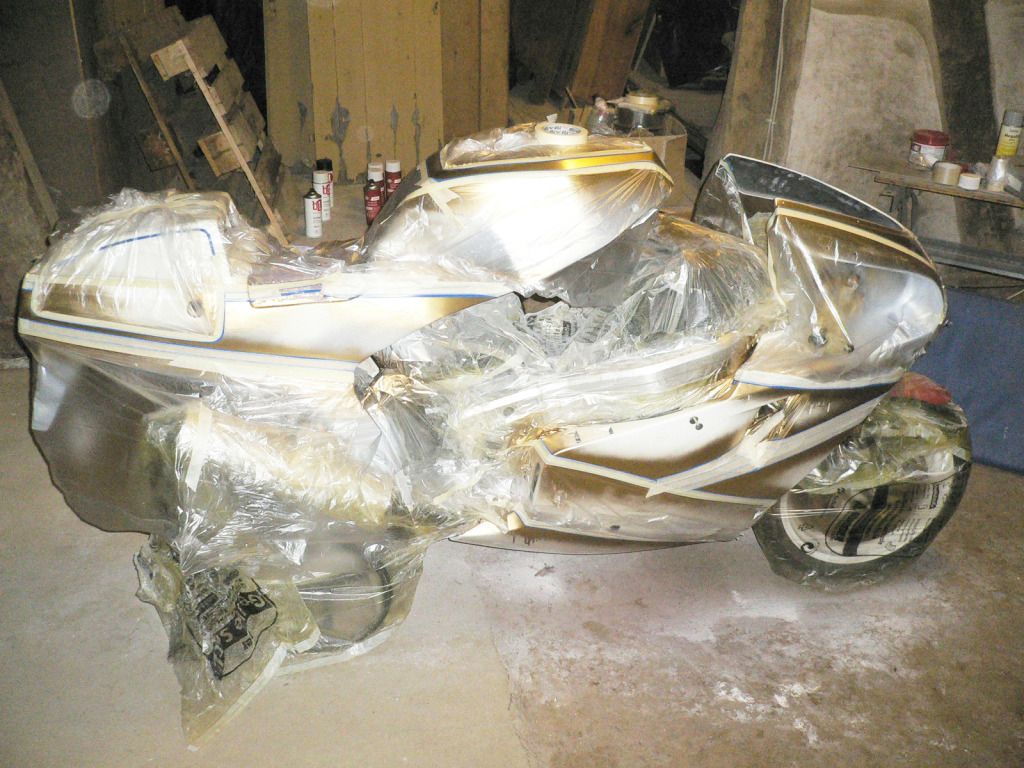

gold goes on first- it's easier to mask for the next colour coat
looks a bit seventies!
then red
then mask that and chuck masses of white on
all over the place
even had time to get my new sign up- dooh ! sorry that's for another forum

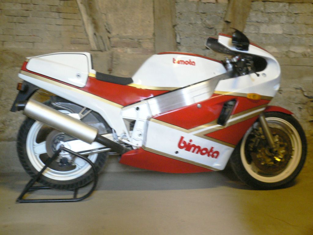

then a few tape lines and stickers- easy as that
Missing YB4 logos- need to get some cut for the final job.

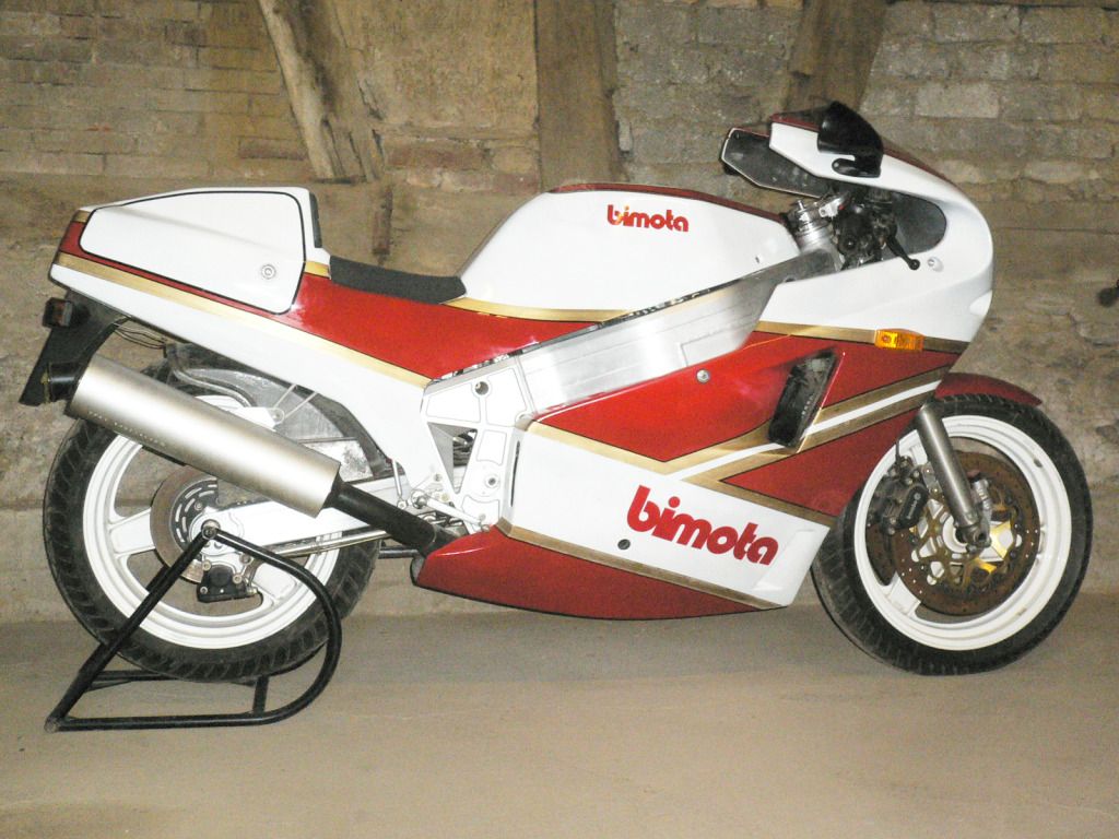

And I didn't get it exactly right- the gold line at the rear is a little too high and I think the area on the fairing where the big Bimota logo is is too high? good practice though.
Red is a bit dark on this pic- how about this one?

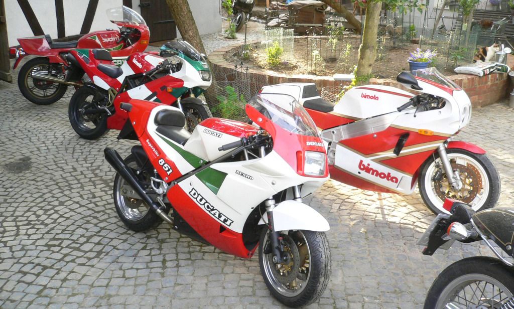

just don't look too closely. but it'll be ok parked at the back.
or even in the yard
eyeing up the competition, 1988 again.

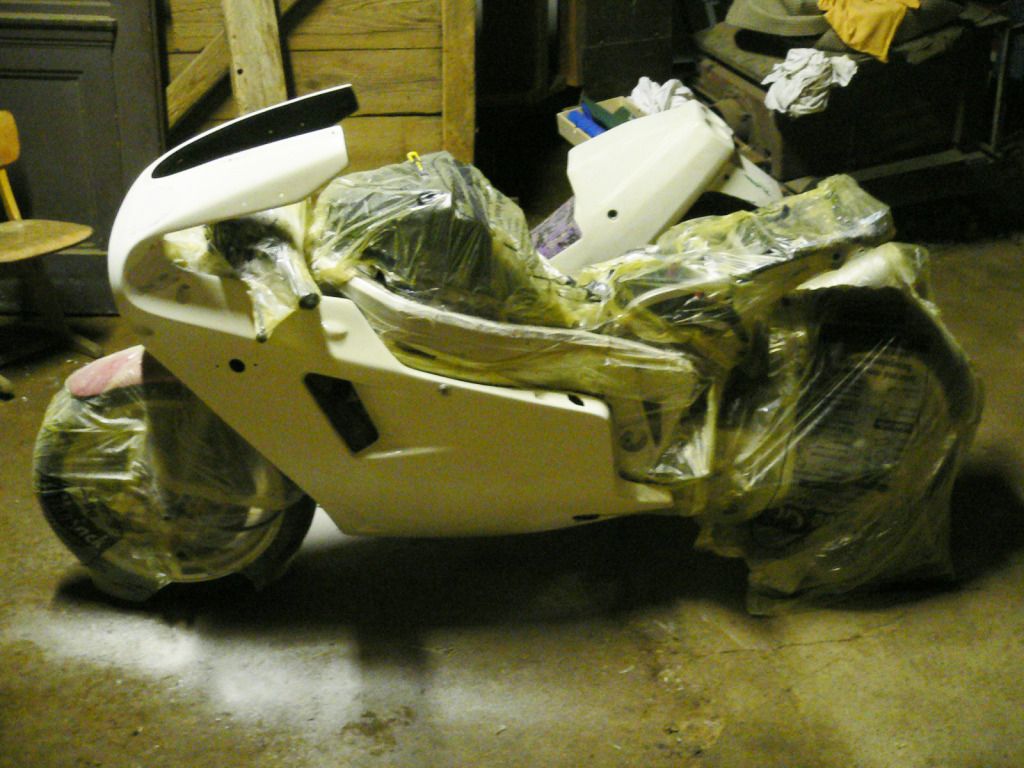

it's paint job round 2
had to strip everything off again to sand it properly.
Found a custom sprayer in Frankfurt who still uses solvent based paint and will do it for 1500 euros, which is not bad these days. So long as I prepare it.
Local paint shop will blow on the primer filler for 50 euros- getting good.

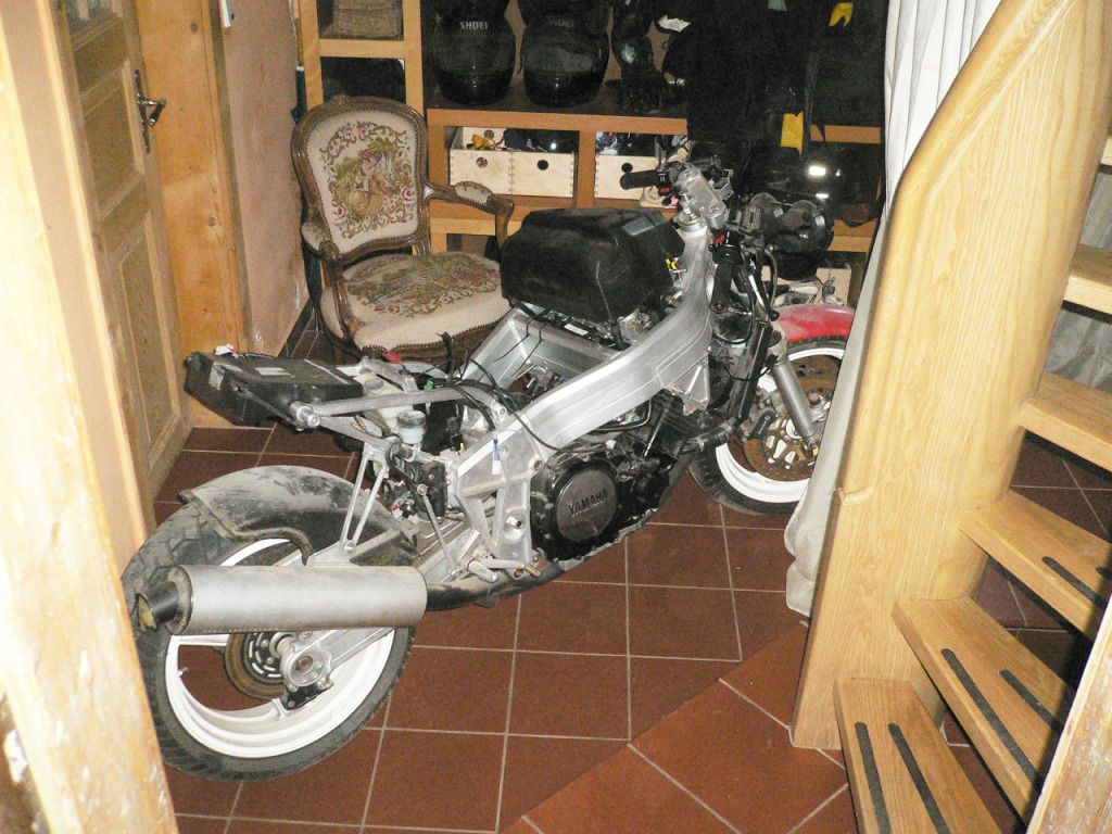

Been held up ( a lot ) with boring day time things, and just finished a 3 day/squeezed in between other stuff valve adjustment and belt swop on the DB2, which is now running gorgeous : )
So while the YB4 body bits are at the painters, I'll sort out the wiring loom finally (promise) and get it all running and lovely for the tea party, 2 more YB4s are planned to come over on Friday 16th : )

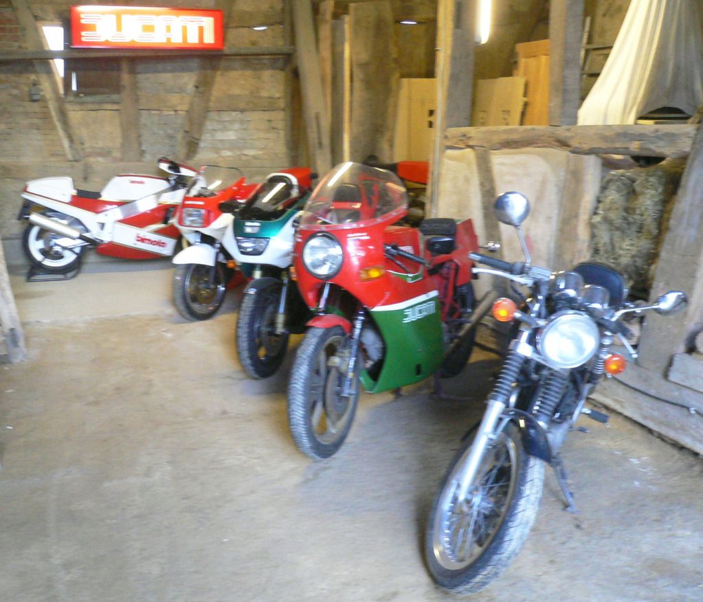

Posted: Sun May 19, 2013 12:43 am Post subject: |
jeez, the back disc on that 851 is huge Cranky! _________________ 03 YB11, 03 Aprilia RSVR Edwards, 94 Ducati Superlight III, 95 Honda NC30, 04 Ducati 999S, 91 kawasaki KR1-S C2, 91 Ducati 851 USD Strada, 89 ZXR750H1, 90 ZXR400H1, 205 16v Rally Car, A6 2.7TDI Avant, STM R1 engined Phoenix |
Posted: Tue May 21, 2013 8:11 am Post subject: |
hi Phil
I think it's a 260mm
definitely a full floater- very period.
looks bigger because it's a 16 inch wheel
Going to change for a 17 incher with normal 245mm (?) Ducati wheel, along with the front- handling should be nicer, and I'll be able to get tires : )

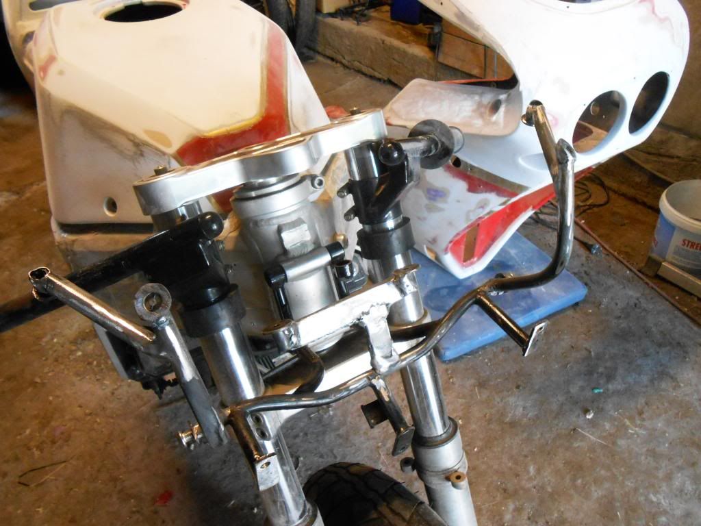

and as you can see I've got to weld the missing brackets onto the front subframe.

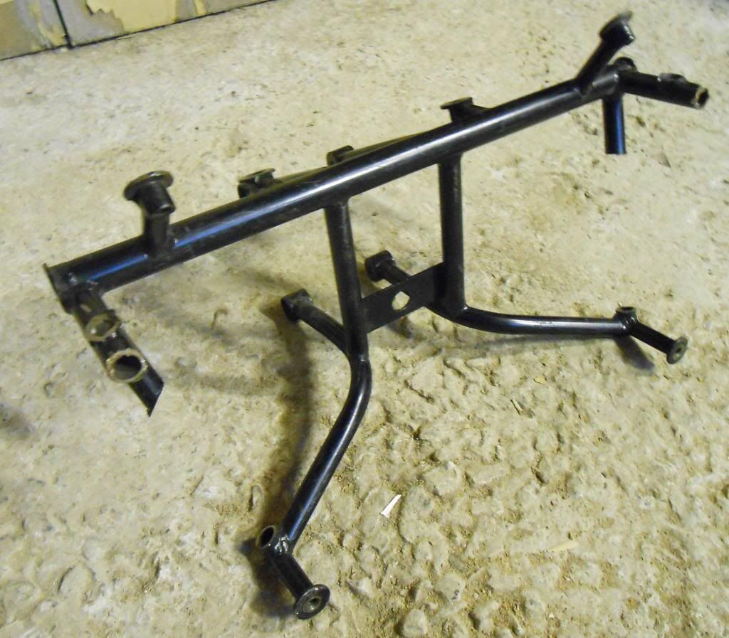

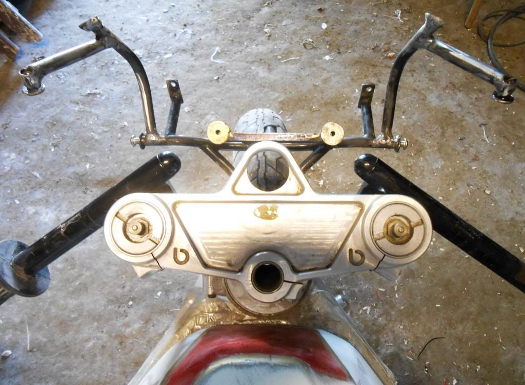

front subframe repaired
finally somewhere to fix the clocks and support the upper fairing arms : )
and where to get nicely bent tubes and fittings the same size as a Bimota YB4 front subframe?
from a Bellaria front subframe of course- I know it's not exactly correct behaviour, but when needs be . .
and a bit of sanding going on . .
but I keep finding places that need repairing . .
this is never going to crack again.

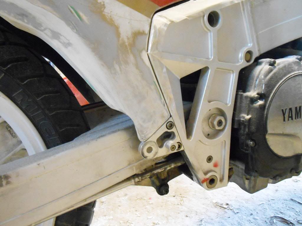

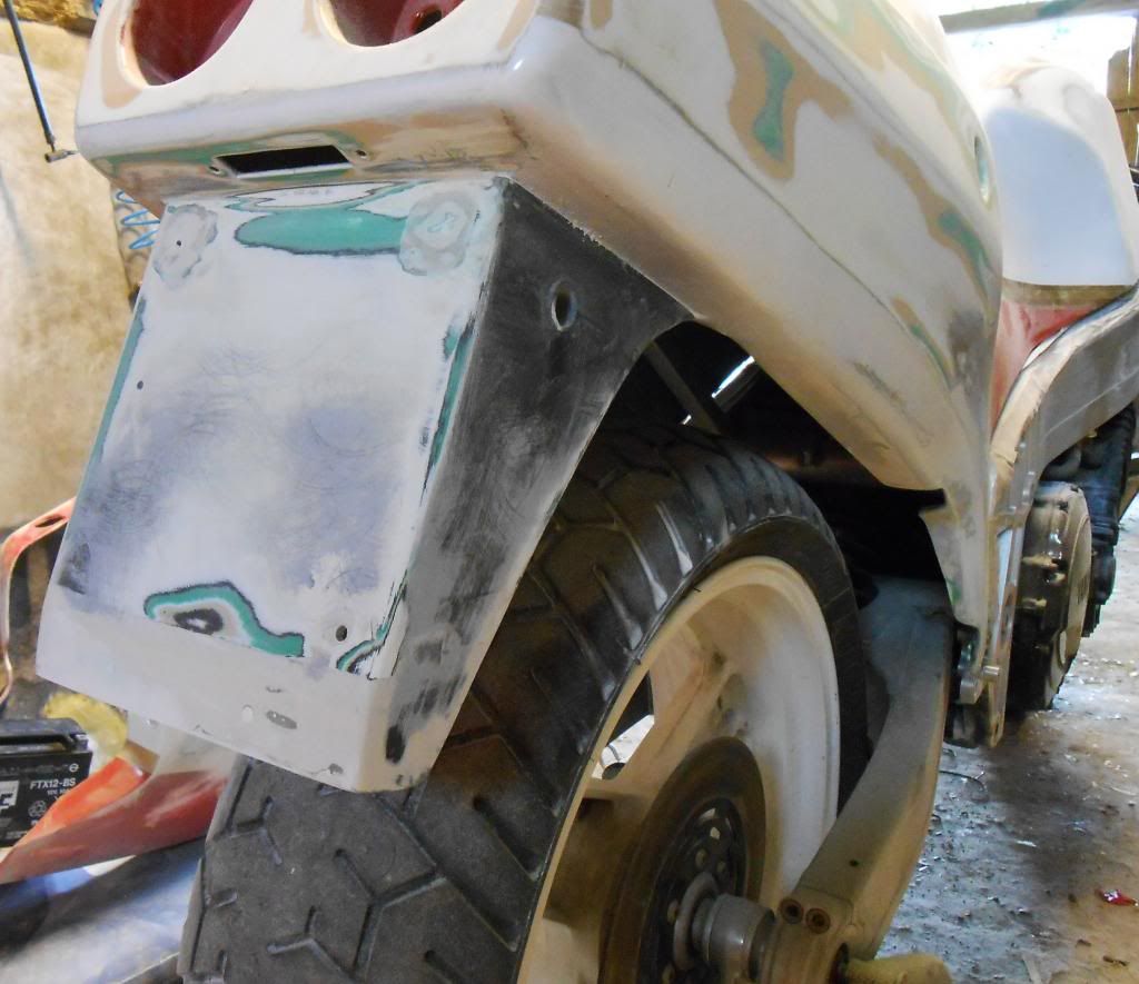

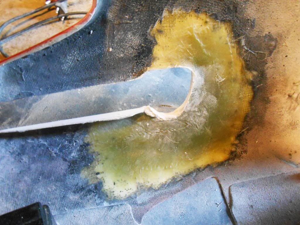

relaminated rear mudguard area- the bit for the reflector had been 'cut off' : (
and this 'heel' guard/ tab thing has now got a moulding on the back to keep it from flapping about- the one on the left side pushes in- the right side was pushing out !

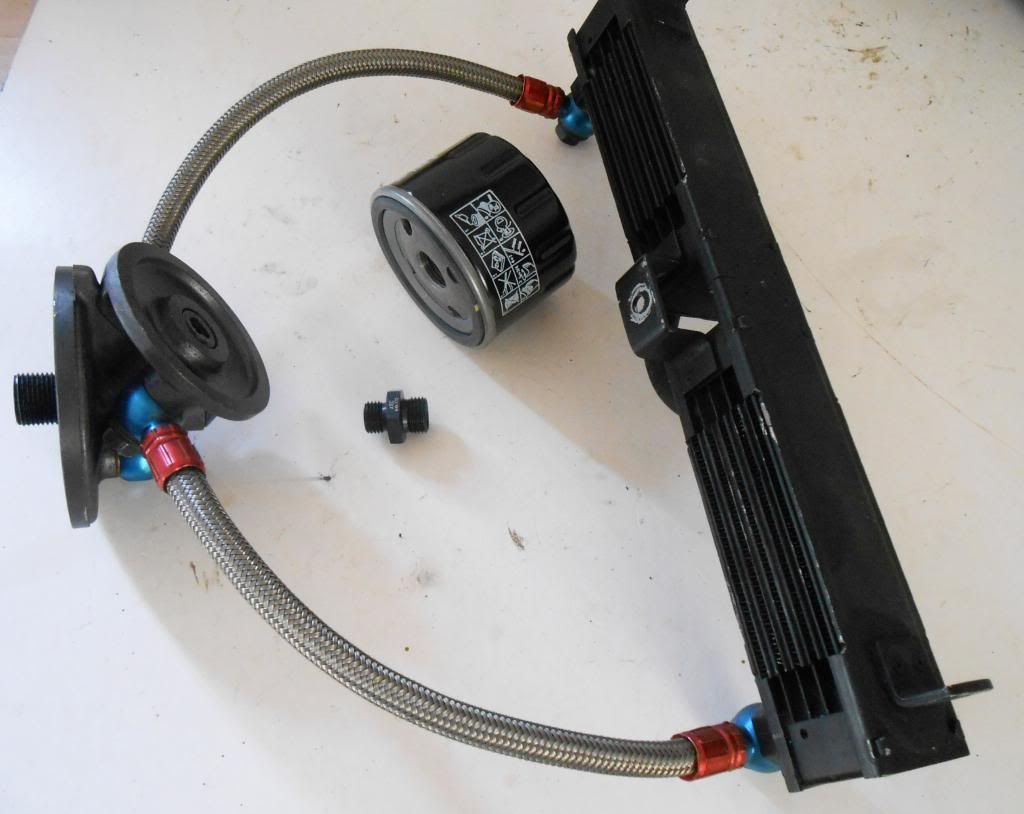

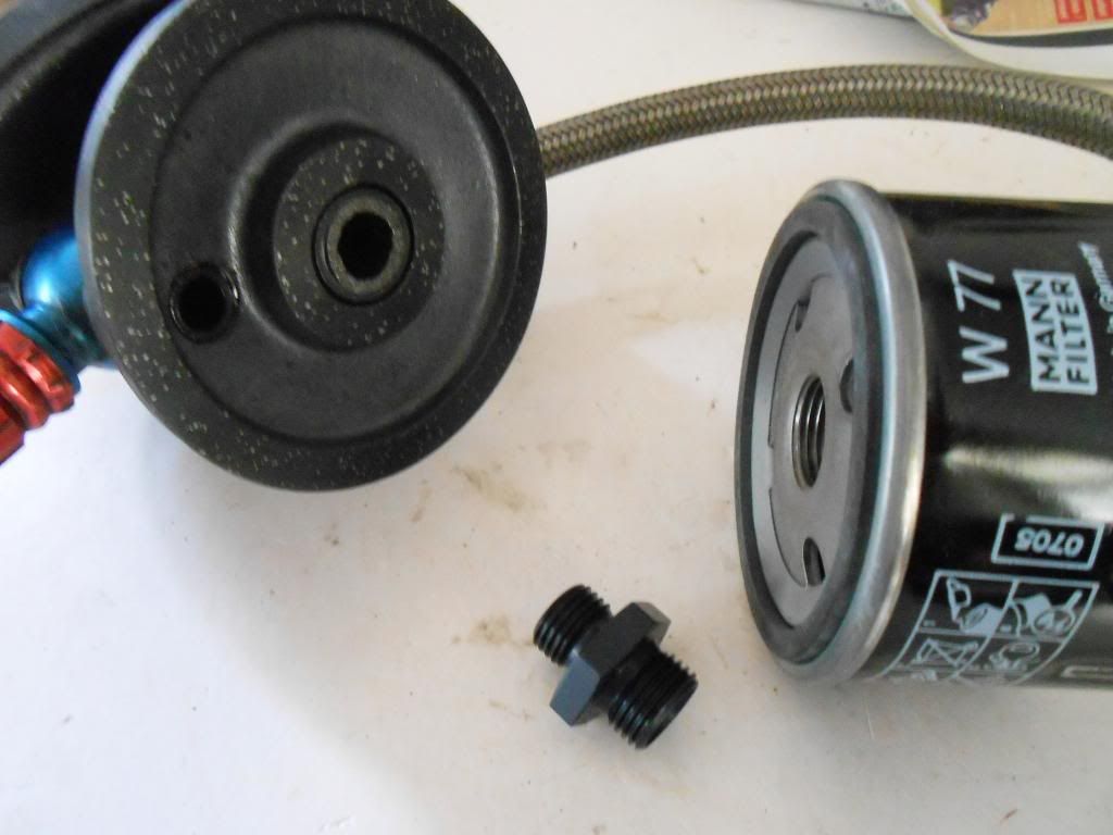

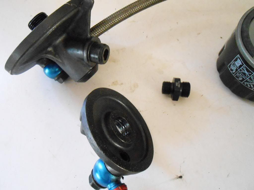

And got a nice oil filter fitting screw to repair the broken off thread on the original YB4 filter adaptor.
Need to drill and tap a 14 x 1.5mm thread, then reduce the height of the hex a bit- hopefully stronger than original.

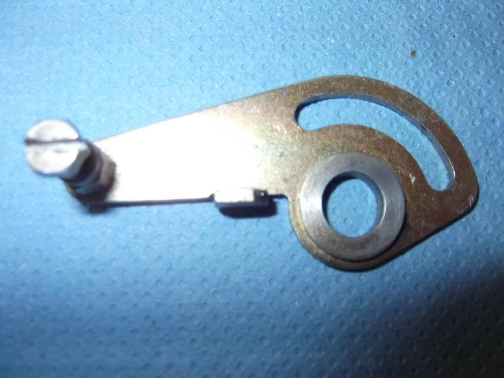

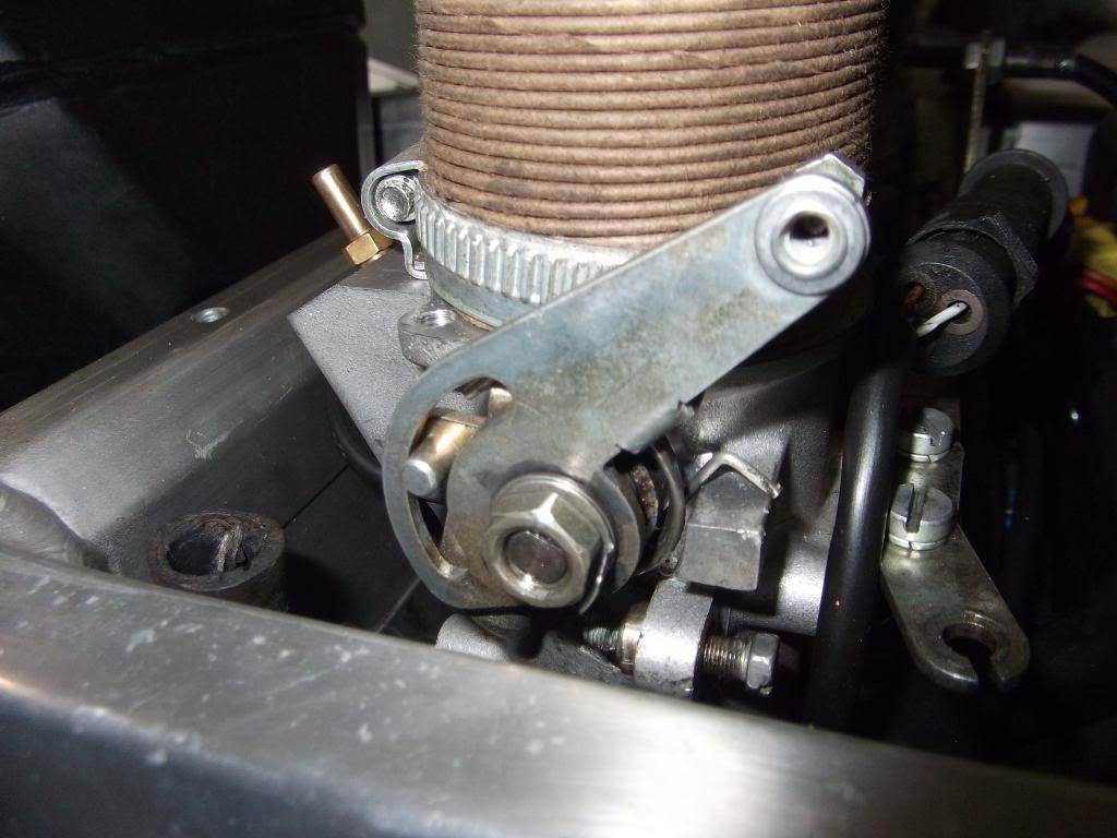

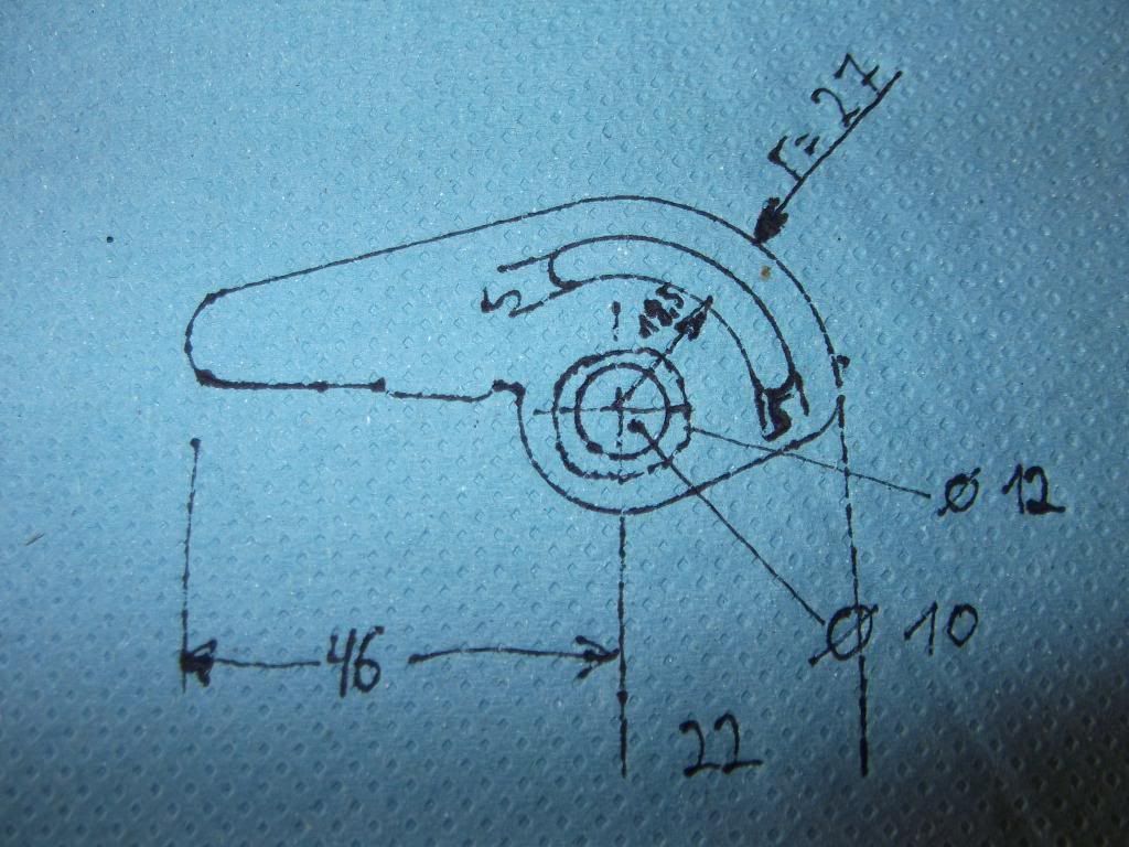

and a very wonderful reader of this forum, who is also restoring a YB4- made a nice drawing and took some photos of the fast idle cam lever that I'm missing : )
Best to get it laser cut- wonder how much that is going to cost?
Unless somebody has one that they don't need?
Thanks Michael : )
