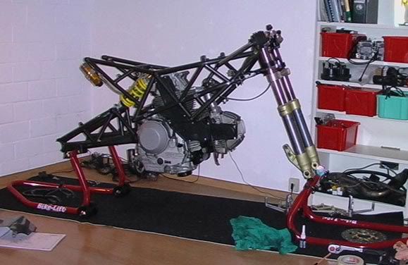

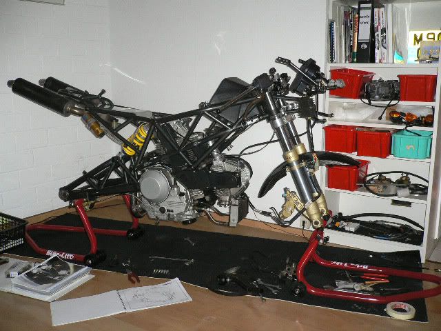

But decided it needs a proper going over anyway, which led to a 2 year rebuild. For which I got a couple of mates to carry it up the stairs to my 1st floor flat where I was living. Mostly it just needed a good clean up and polish, but I also changed as much as possible back to original and touched up some cracks and chips in the paintwork. The paintwork by the way is gorgeous in the sunshine: red with a gold metallic and metallic green.

And more finally I just managed to fine the 2 black plastic screws that hold the monocoque on between the seat cushions.
definately one of those bikes that looks sexier with it's clothes off

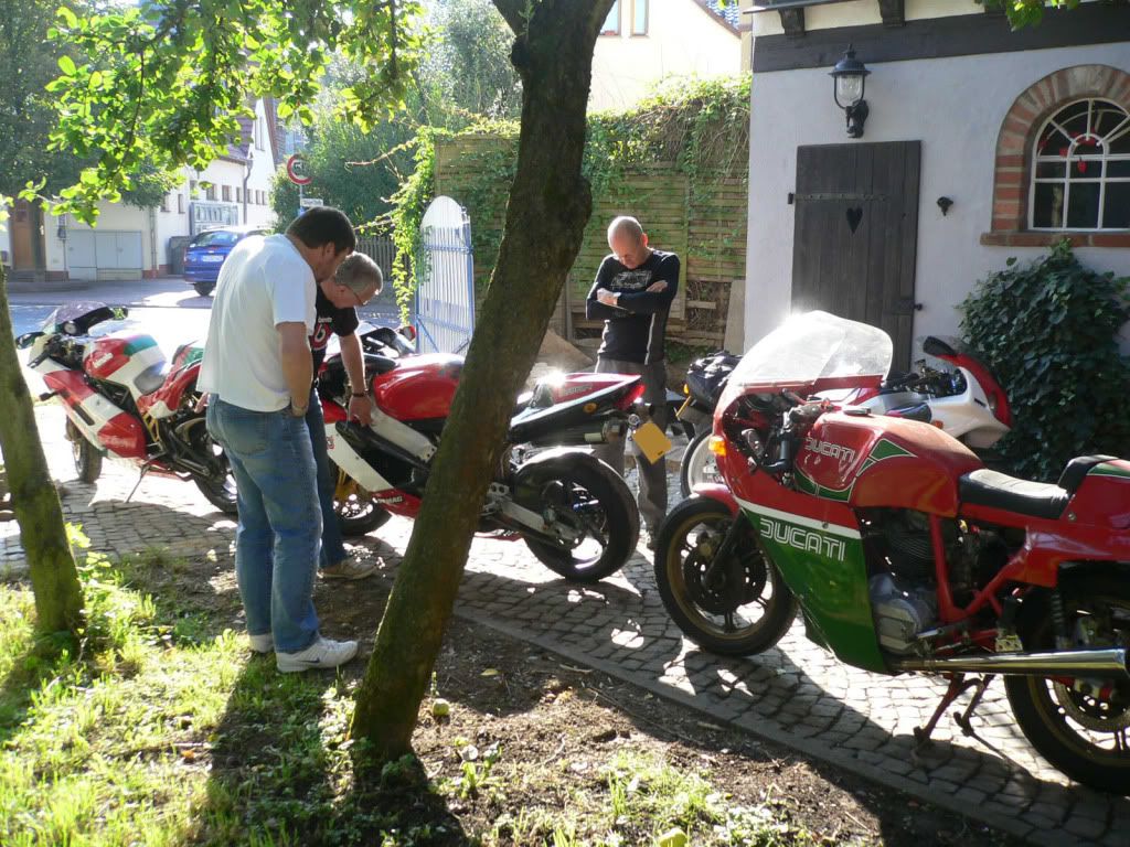

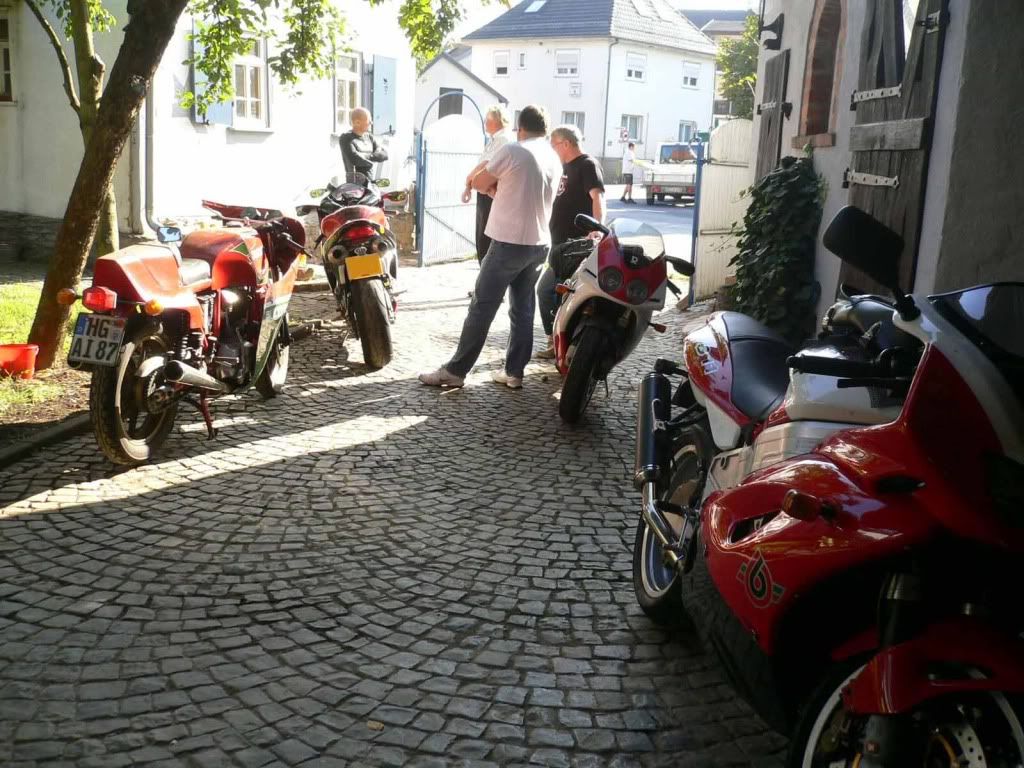

a couple more pics from the weekend with the yard full of toys and their riders, lovely.

love the fact you built it in your flat
