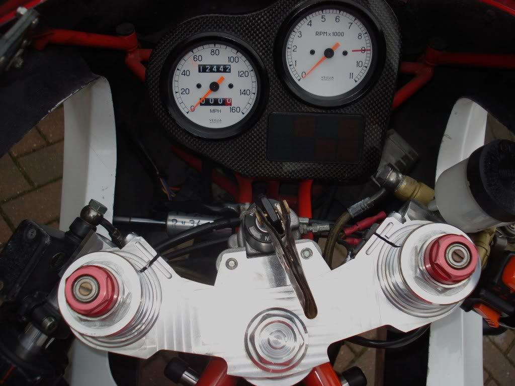

Posted: Thu Jul 14, 2011 10:11 pm Post subject: Mantra in latest form |
Here it is with Sport Classic silencers... |

Yeh Gary, to top of slider. To help Robin, the height when the bike is on its sidestand would do, or when sitting under its own weight upright, from underside or top of stanchion to top of slider. If the balance of his bike is off to the rear then this gap would be longer on the front than yours, which would be adjustable by lowering the compression. Not so sure with your bike if it has preload adjusters on the top of the forks, they were available as an option, so maybe fitted? The hex nuts on the top . Mine shouldn't have had them but seeing as the forks were changed for 51mm Paolis it does have them. And each leg has a compression and rebound adjuster also, whereas the standard had one adjuster for compression on one leg and the other leg was rebound, strange but thats the way they were
The red ally billet hex nuts are the preload adjusters for static sag when the rider is on the bike, and mine has the seperate compression and rebound clicks on top and bottom of each unit.
