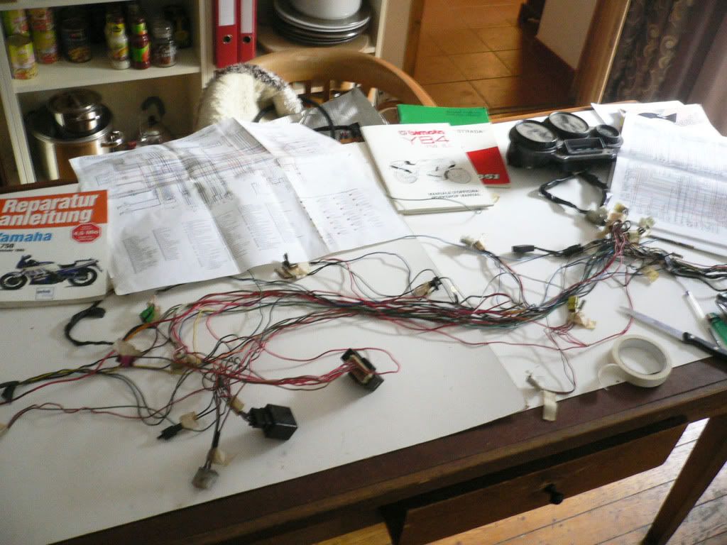

After checking over the Yam loom, I decided that the best thing would be to fit it as best as possible on the bike before I snip anything off. Quite sure that anything to do with the ECU, fuel pump, coils and reserve switch can go because that is all covered by the YB8 loom.
Apart from removing sections, the only other 'big jobs' should be relocating the fuse box to the top right side of the radiator from the rear and maybe maybe extending the ignition switch connector as it's now under the tank.
with help from the YB4 and Ducati manuals plus a Haynes and another 'German' manual for FZ750s and a wiring diagram for South African and Australian FZs (no idea where I found that but might be the correct one for the 2MG base engine of the YB4). I found everybody uses different colours etc for everything. There are even big differences between different Yamaha looms depending on year model.
The Bimota manual doesn't have a wiring diagram, but the Ducati 851 manual has 2! however all colours are different Confused as are the YB8 colours Confused Confused

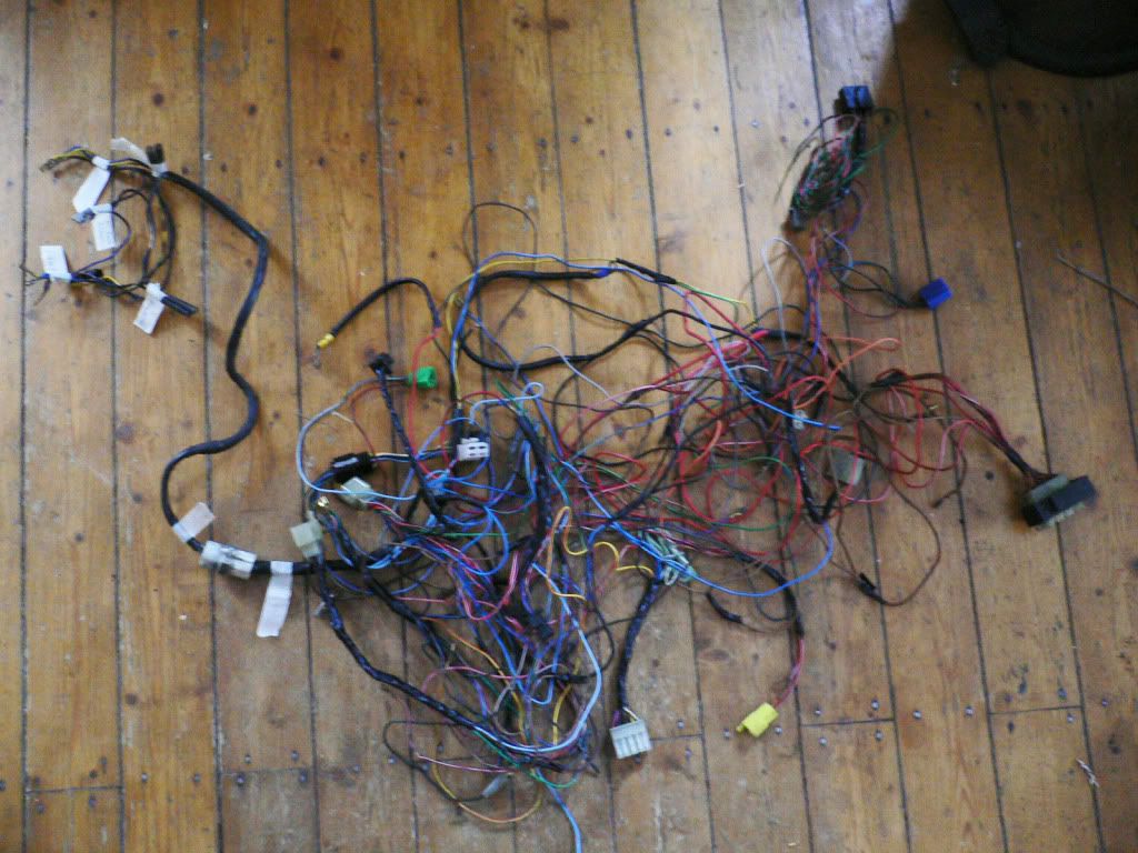

This is the loom I got with the bike
nice!
funny thing is the rear lights section on the left is not standard Yam- it's exactly what I need for the YB. But everything else is just hashed Yam. So it looks like somebody has started to modify a loom (very badly) or did Bimota use a modified loom but still left the unused connectors on- I can't imagine it.
So for a bit of fun, connect up the YB8 loom first, sounds so easy

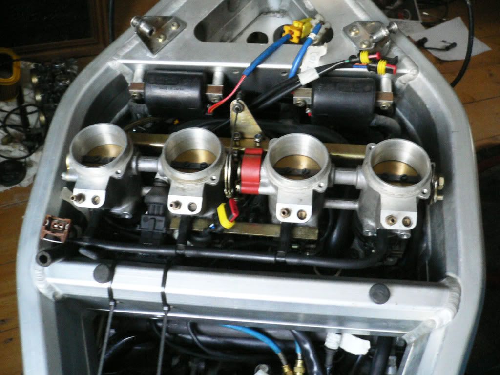

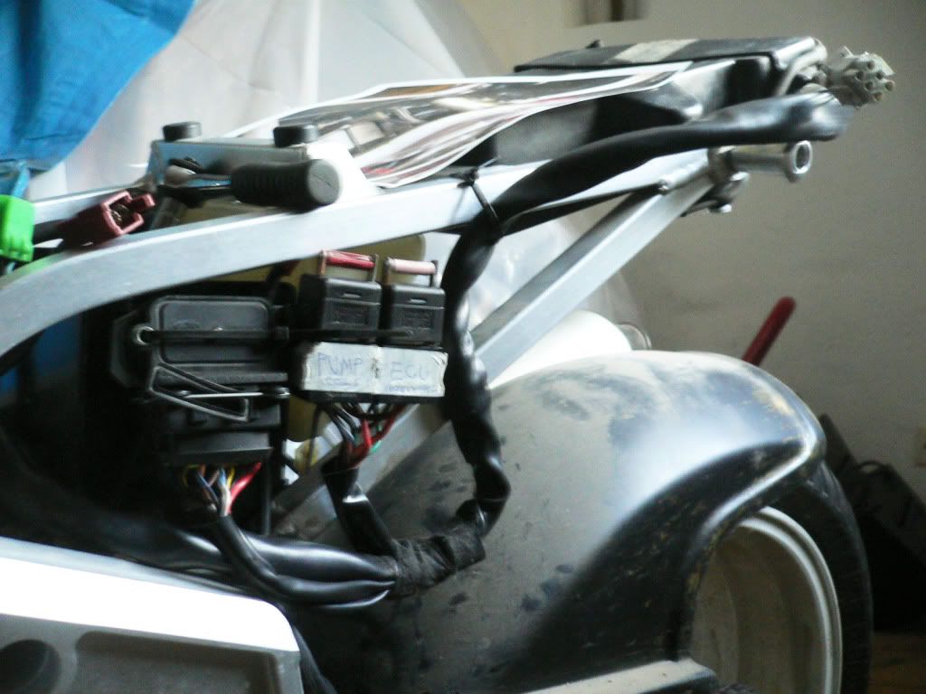

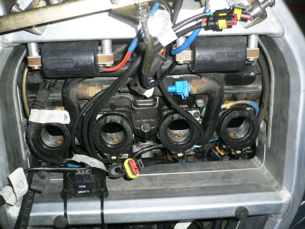

ECU connected, ignition boxes and relays on, held in place by tie wraps for the moment.
Had to pull off the throttle bodies to get the injectors and sensors connected
everything is so damm tightly packed, will have to consider the final build sequence to get it all nice.

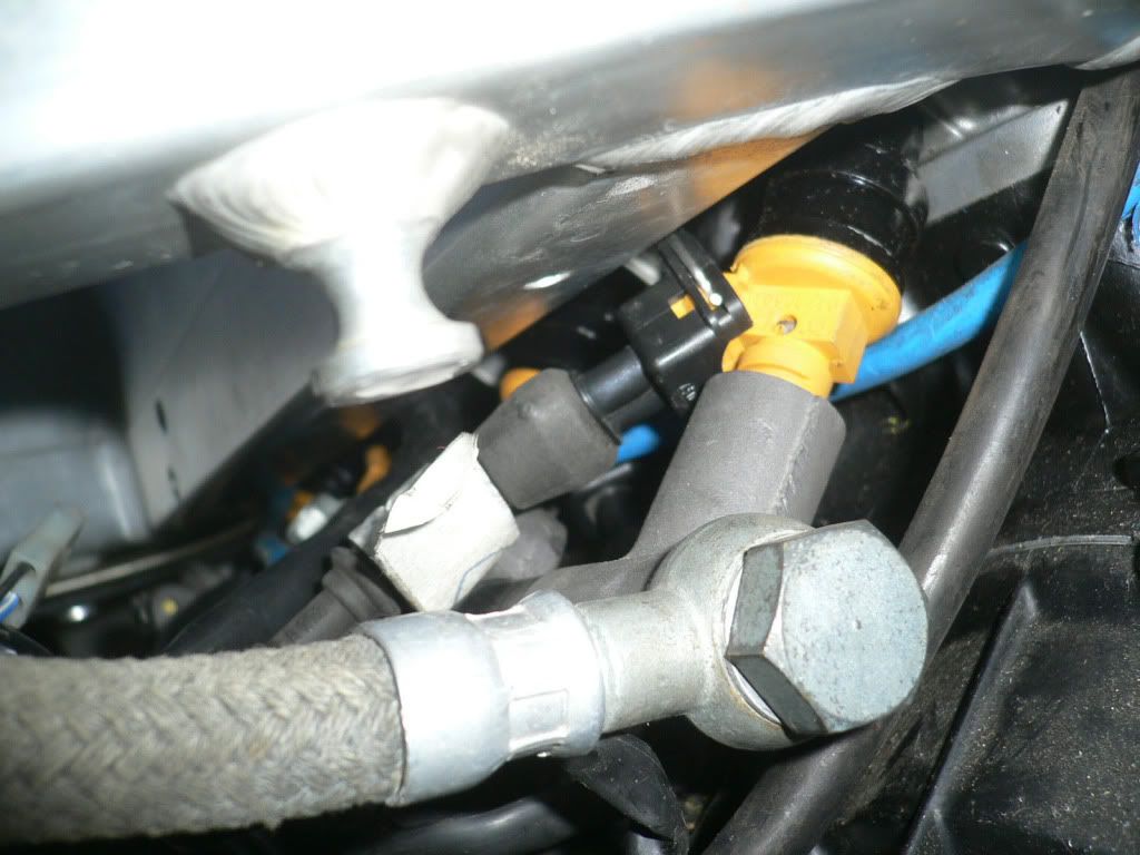

those 'squirting up' injectors are a particular pain to connect. I hope I won't have any roadside repairs to do in the future . . .
throttle bodies back on,
but I need to replace 4 of the plugs because this loom was made 10 years after the YB4 with some later style AMP connectors. I'll fit Yam connectors for the coils, old style, round 3 pin AMP for the TPS, in case I replace that with an NOS one and I think I'll put a Yam style connector on the crank sensor too. And the fuel pump- 5!

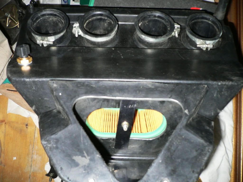

new air filter element in.

I spent the afternoon comparing ECU, relay and ignition box connections between the Ducati, the YB4, the YB8 loom and Laminators wiring diagram.
Not sure what the conclusion was, apart from I'm just going to carry on as best as I can because they all have different colours but seem to be doing the same thing.
But the suspected EXUP 3 pin connector has a blue wire going in and back out from crank sensor to Ignition box, a violet wire going in and back out from a coil to ignition box, plus an extra white wire coming out- this is quite possibly probably where I have to connect a power line from the handlebar RUN switch; as it goes to the ECU relay- source of power for everything. ha ha HA! Twisted Evil
Are you following this?
so I can ignore the blue and violet, but I need to connect the white to the Yam RUN switch.
it's as simple as that.
obvious really.
don't know why I didn't notice it before.
It's just dawned on me- I can connect the violet wire to the tachometer for the signal, yes yes, that's it. No other connection you see.
