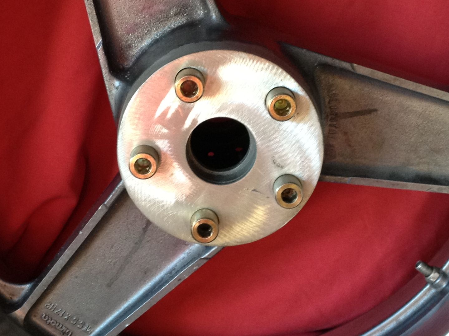

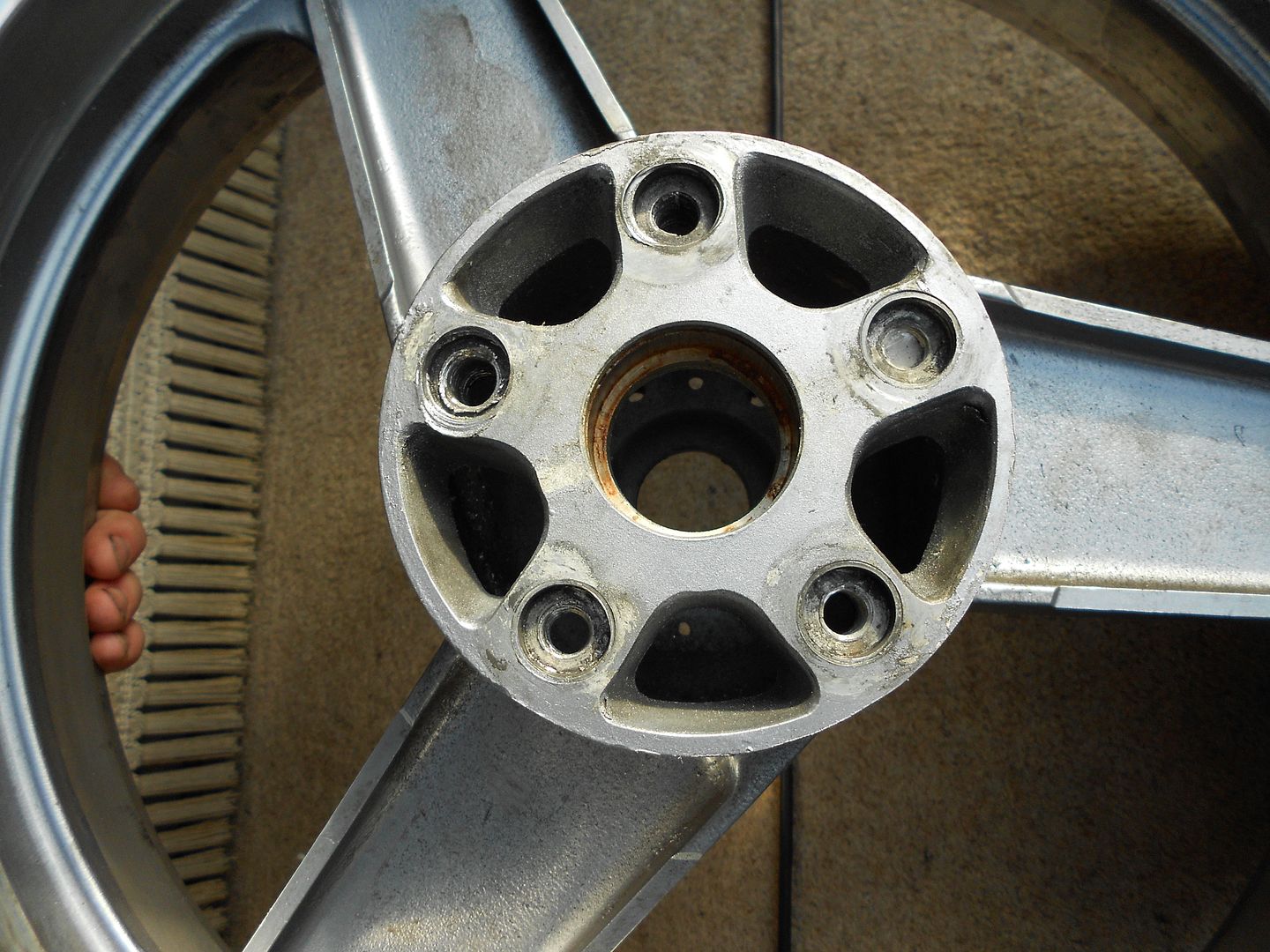

Looks like it is DB2 rebuild year. Ive just acquired the FF 944 one that has done the rounds a couple of times on here -looks good with excellent spec but as we know its whats hiding under the covers that counts. I'll put a few piccis on but here a few issues -wrong sprocket offset, 2 sprocket retaining studs put in upside down, welded repair to cush drive stud wtf (Ive a good idea who did this and they are on the forum!) Smallbore brakeline used instead of oiline, stripped threads in front and rear mountings for discs, poor attempt at respraying it where the original powder coating has faded, low grade aluminium bolts in the fork clamps to name a few. Will be good when its sorted!
Posts: 582
PostPosted: Thu Dec 15, 2011 11:11 am    Post subject: Reply with quote
Here we are
Tasty engineering! Sad
result of above (2 like this)
treads all stripped and stretched oval, lucky I checked
new strengthening fillets welded in, 14mm diameter thread studs fitted from Rudolf in Germany, holes rebored and rethreaded.
SORTED!!![/img]
That stud weld job looks pretty good. snerk. Shocked Sometimes people simply don't have the resources to fix things the correct way and have to improvise. I've been guilty of that a few times. Rolling Eyes I saw on another thread where the cush drive rubbers, bushings, and the larger diameter studs are still available. All of my studs look good, but it is tempting to buy a set of the larger ones to keep in the toolbox.
I'm still shocked that one of my rear sprocket studs was glued in due to stripped threads. I could see someone making it really difficult by using some type of epoxy, but GLUE? May as well used dog snot for how effective it was. I had a Helicoil installed in the hub. It was a quick, easy, and cheap fix.
As for the sprocket offset, mine still has the funky, OEM Bimota sprocket retainer and had to get a buddy to machine a Ducati front sprocket to fit the bike. I've been trying to locate a spare sprocket retainer, and haven't had any luck yet. If the retainer fails due to worn teeth, there is a concern of the tranny output splines getting chewed up and allowing excess movement of the front sprocket (and premature wear on future retainers). I had this issue with my Ducati ST2. I got creative with a repair/retainer arrangement, but if I ever have to split the cases, I'll be replacing the output shaft.
For my bike's improper sprocket offset, the previous owner had used a regular, flat-side Ducati sprocket and not only did he turn the OEM retainer around, but he added washers between the retainer and the sprocket! Rolling Eyes This made the offset about 10-11 mm closer to the engine case. The offset was so bad that the chain ate through the exhaust heat wrap and the chain was completely to the inside of the chain slider/protector on the swingarm. Shocked
