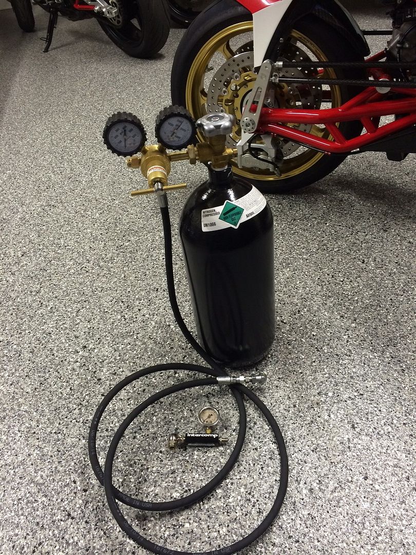

| I have a question about the front shock. I've picked up a low mileage Tesi 3D and I'm going through the bike before I ride it. It seems the front end has some sag when sitting with no rider and I wanted to know if the shock uses air or nitrogen. The manual says 9.5 Bar of Air is standard. Thanks for any help on this. |

| I contacted Bimota Spirit and Bob confirmed Nitrogen. He also told me to put some miles on before I made any changes because the Tesi likes a softer front end. |

Just received this from Extreme. Thanks 2bims for the contact info
Yes is correct to fill from main body , the small reservoir is only for hydraulic/damping purpose , you can use air or nitrogen , nitrogen is better but air is ok.
Regards
franco |

Posted: Sun Apr 19, 2015 7:12 pm Post subject: |
