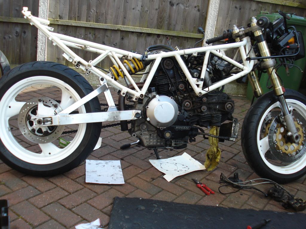

Had a few spare hours in the sunshine over the weekend, so progressed a little further with the stripdown and ordering of parts.

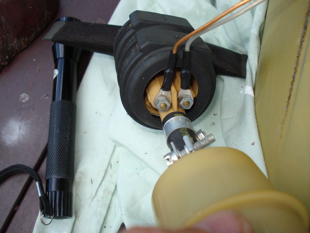

Stripped the tank of all its sundries, caps, paint, fuel pump, connectors etc.

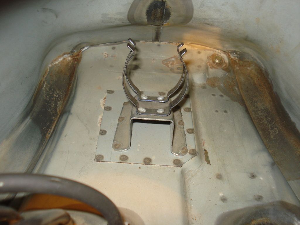

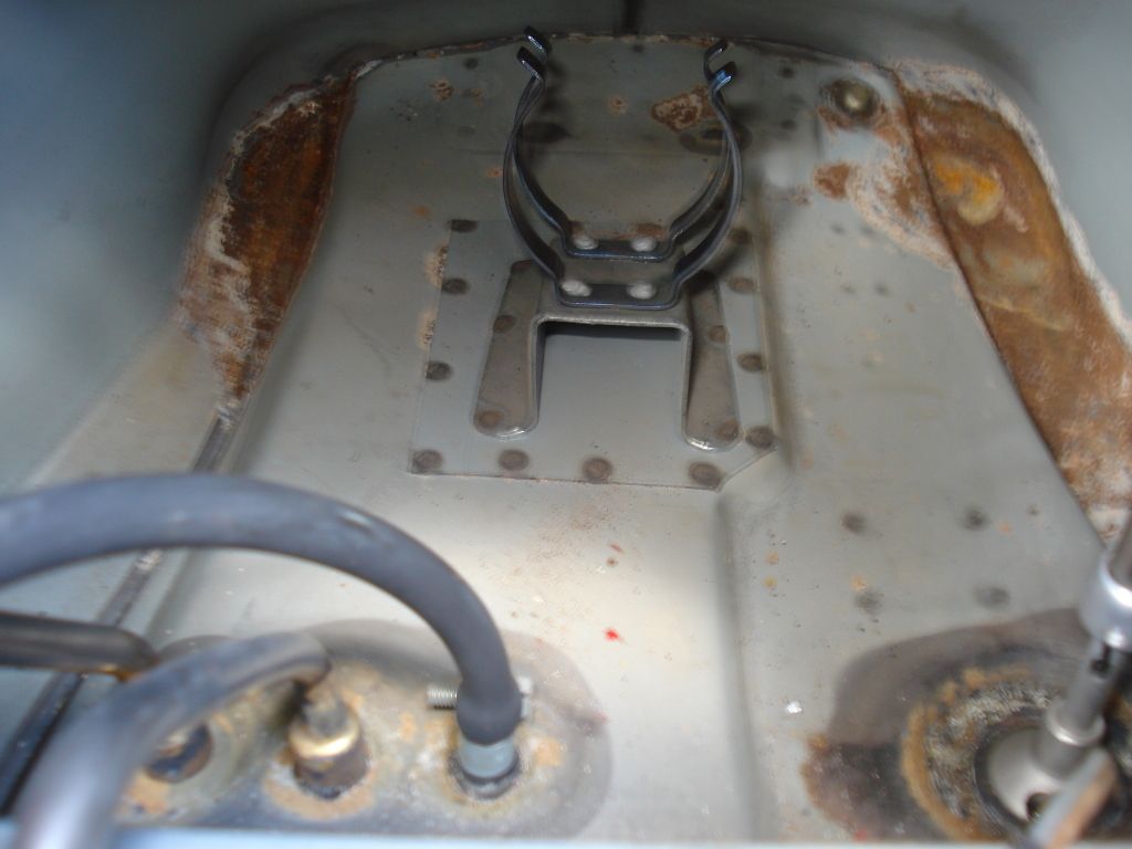

A little corrosion in the bottom of the tank, but nothing a little rub with wet and dry and some stop rust treatment won't fix, not bad for a 21 year old Italian tank

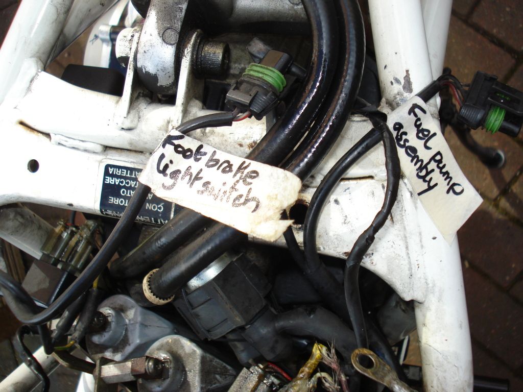

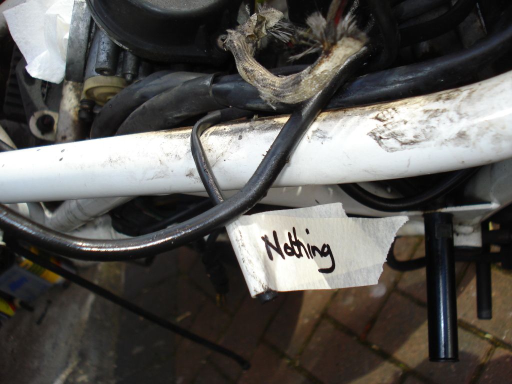

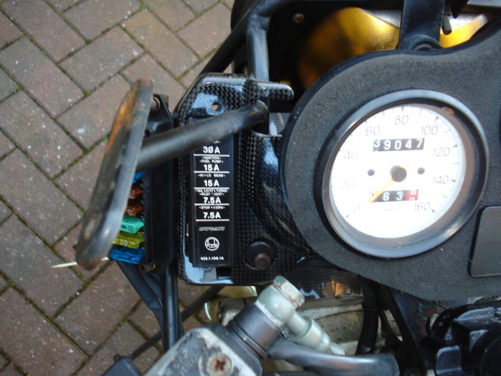

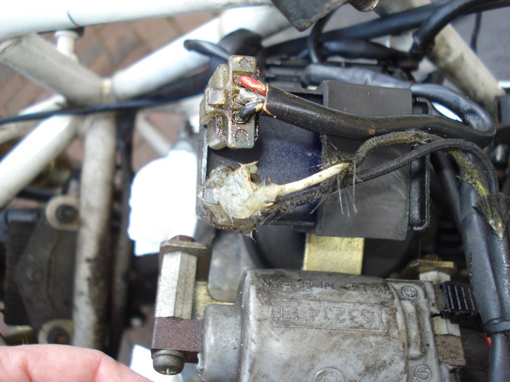

Carefully stripping the electrics and labelling all the connectors
Especially important to label those that go nowhere, saves frustration later (probably the lick stand cut off switch, gone a long time ago)

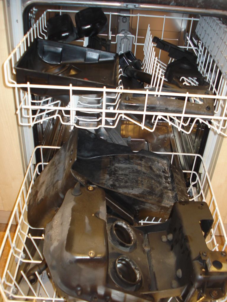

All plastic parts taken off, a staggering amount of plastic for a 21 year old bike, and its time to do the dishes Laughing

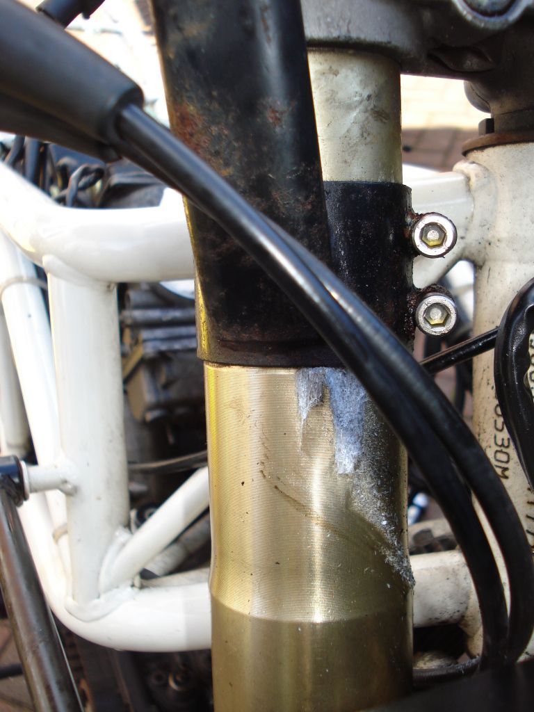

A fair bit of corrosion on the anodised forks, but they're making way for some NOS ones i've picked up

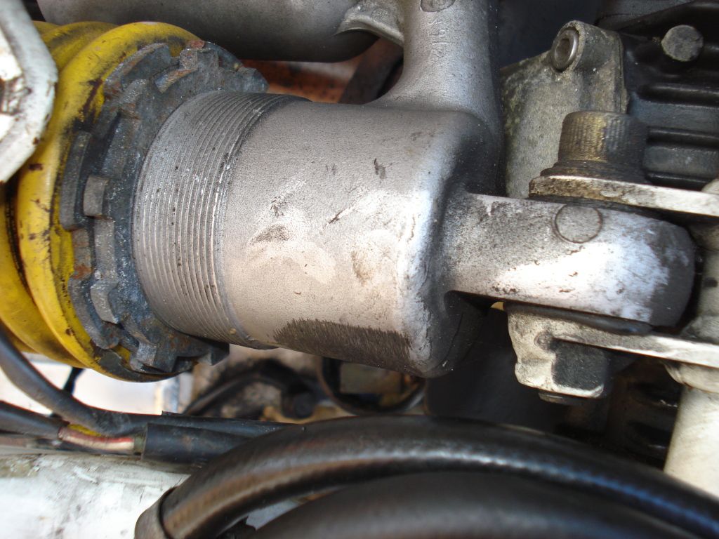

Still toying with a possible Ohlins replacement for the rear Showa, will see when its stripped of its spring and how it cleans up first, spend is already at a "makes the bike a "keeper" level" Surprised
Excepting sundries such as bearings bolts and fasteners, belts, fluids etc, everything is now bought and arrived or arriving, Thus next item will be sending off panels and tank for paint, and metalwork for powder coating, wheels, frame, engine cases, clip-ons, yokes etc
Another day with the electrics and other sundries to be removed and it will be frame and wheels off

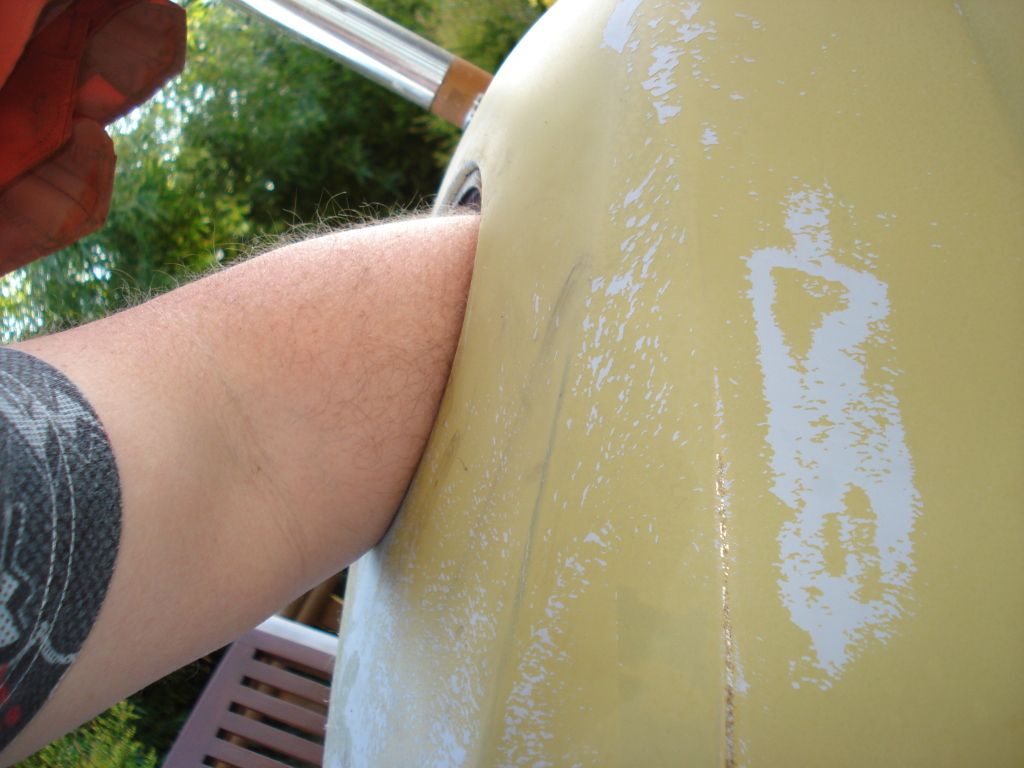

the bikes looking really good but how are you going to wet and dry the inside of the tank? Do you have very small hands or am I reading the caption wrong Shocked

Mike Jennings wrote:
Hello Steve,
Cheers, MikeJ
P.S. Thinks: must get a dishwasher Very Happy
No, you are reading it right, the camera and hand got inside the tank to take the picture, the early dukes were over engineered with the filler cap, theres the pop up sealing cap, that fits in a ring and this fits inside an outer ring, all have to come off for a tank respray. Later ducs just have the cap and inner securing ring, although the Desmodicci went back to the old ring. The petrol pump is fitted inside the tank and hand access has to be engineered to get it out and change the filter, so can be reached with my soft Northen hands for remedy and treatment, must be 130-150 dia complete size of opening, will update with "hand inside" piccies Laughing

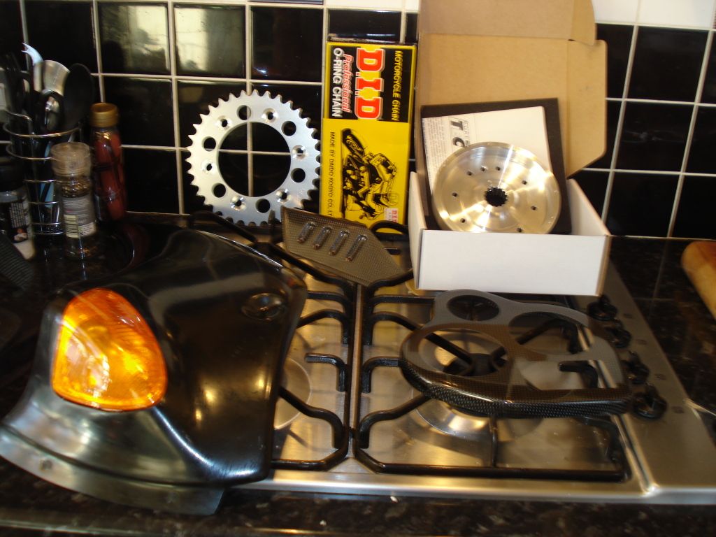

Hhmmm Big boxes in the post. Have to say though that I HATE HATE HATE with some passion DataPost. This is the 3rd time in succession they have delivered to a neighbour but can't bother their fat lazy arses to even leave a card saying that that is what they have done? Once a neighbour had gone on holiday leaving my package in the hallway as I had no idea he had it. Doh!
Anyhow, back to big boxes
Hhmm, whats inside, bleeding light though, have to say....

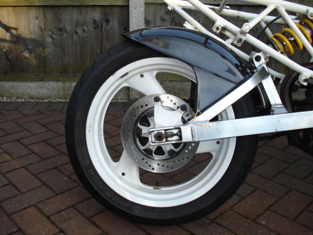

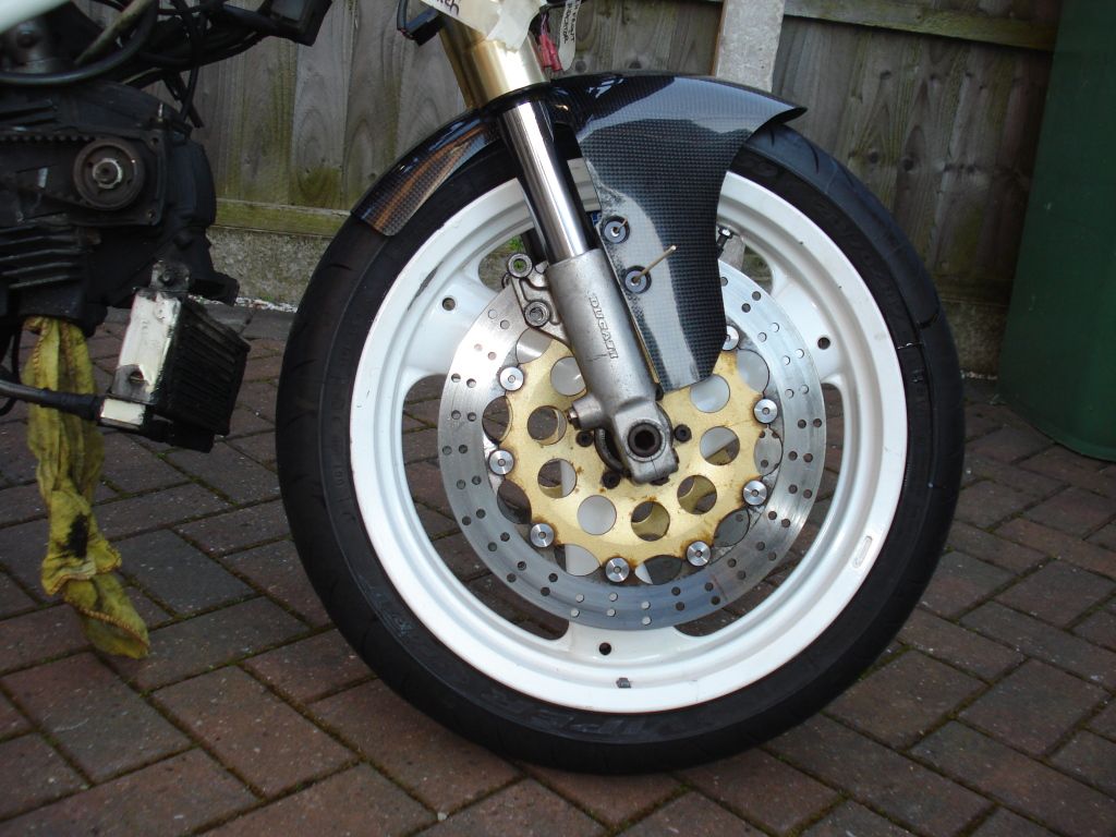

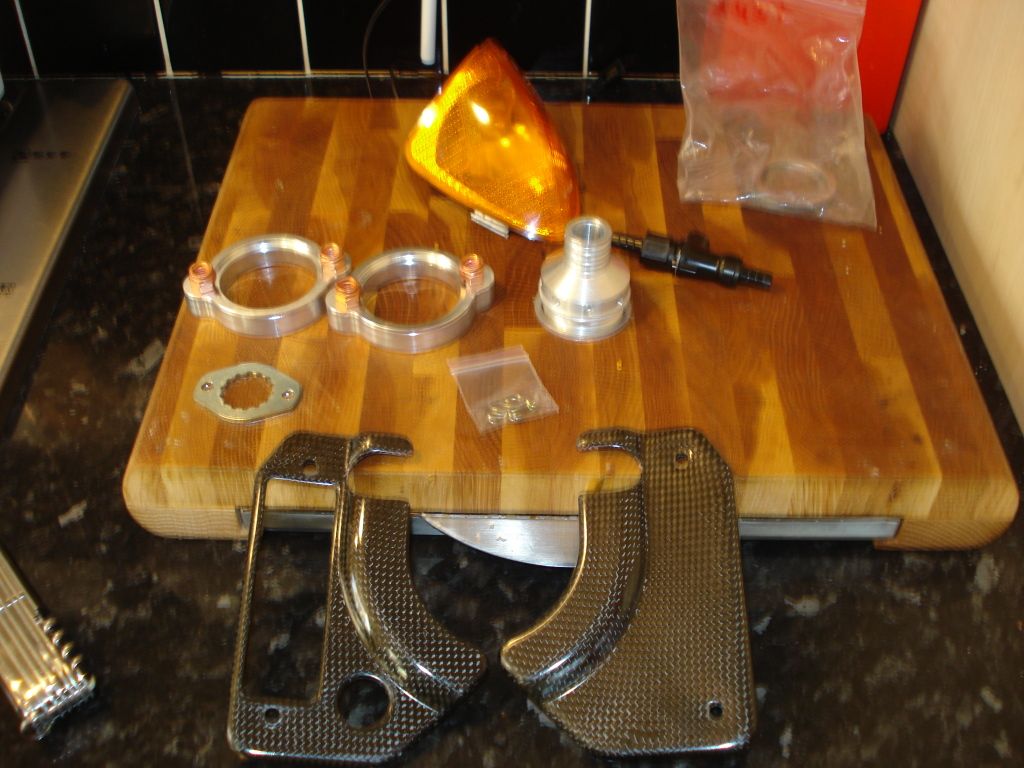

Oh yeh now I remember, Carbon front and rear guards, all predrilled, nice to see
And a few more carbon bits for the dash, and one for the DB2 also, some new exhaust clamps, with copper nuts for dissimilar metals, crankcase breather, fuel break, nose fairing winglets and a shiney hand turned billet fruit Bowl??? How did that get in there? And before you ask GeeKay, no it won't be visible, fits inside the crank and gets covered by the left crankcase cover Laughing
Sprockets and chain and front sprocket cover plate, chainguard also.

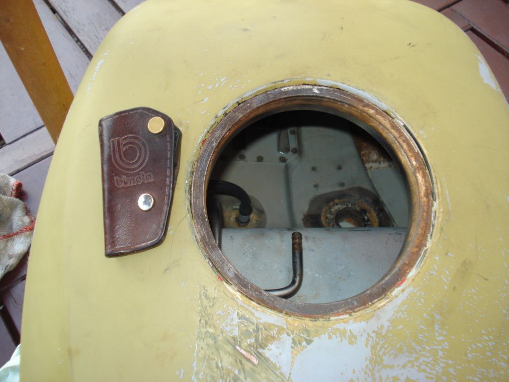

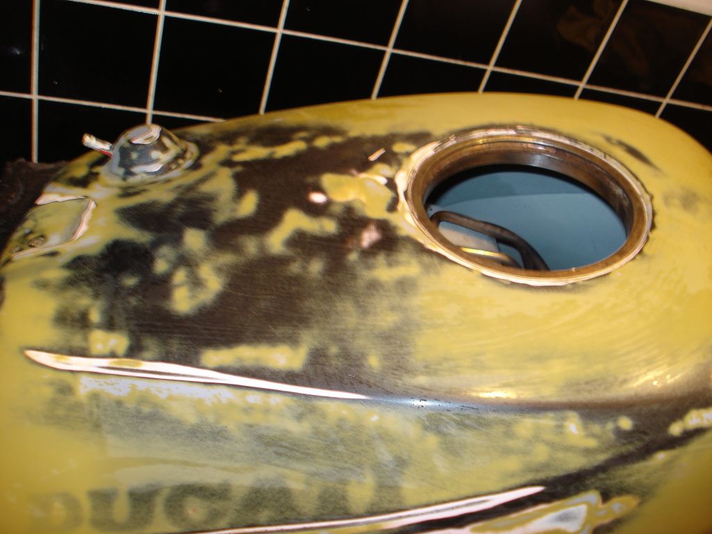

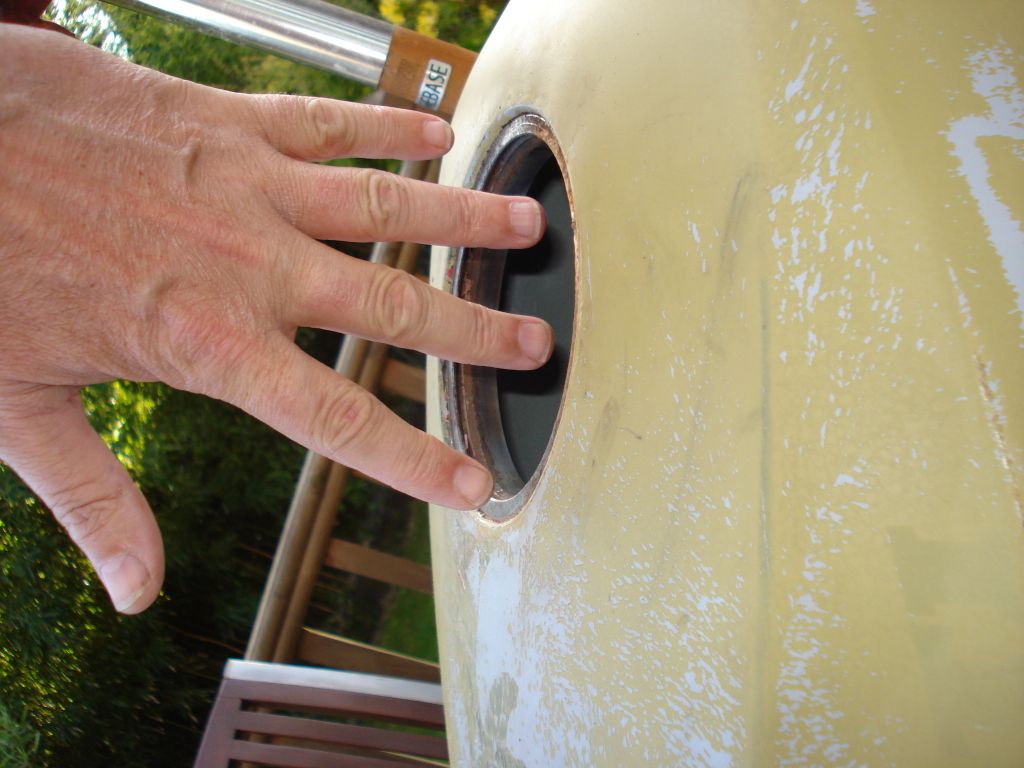

Well some folk were interested how to wet and dry inside your fuel tank (Bimotas need not apply? Thank God!)
So heres the hand, now you see it...
And now you don't, used to be a gynaecologist, down at the elephant park Laughing
Quite a large opening, Bimota Key Fob for scale, came in handy for wrapping the wet and dry paper around to get into the crevices

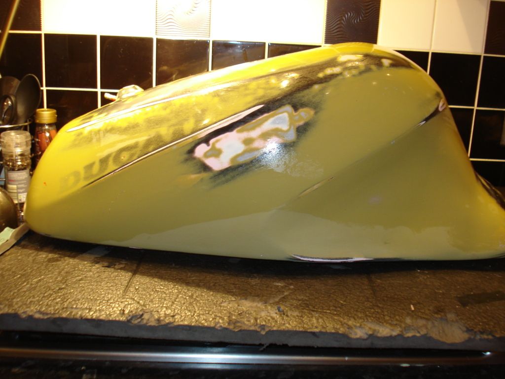

Quick rub down with the wet and dry and surface rust gone, time for rust remedy treatment and then tomorrow, tank liner fluids and flush out, tank stripped ready for paint shop, once the seat unit turns up Crying or Very sad
Not too many horrors on the outside of the tank, all flat and level on the inside, shows the work they put in flatting and filling in the factory prior to paint, as tank is original from 21 years ago, about the only bit not needing much work

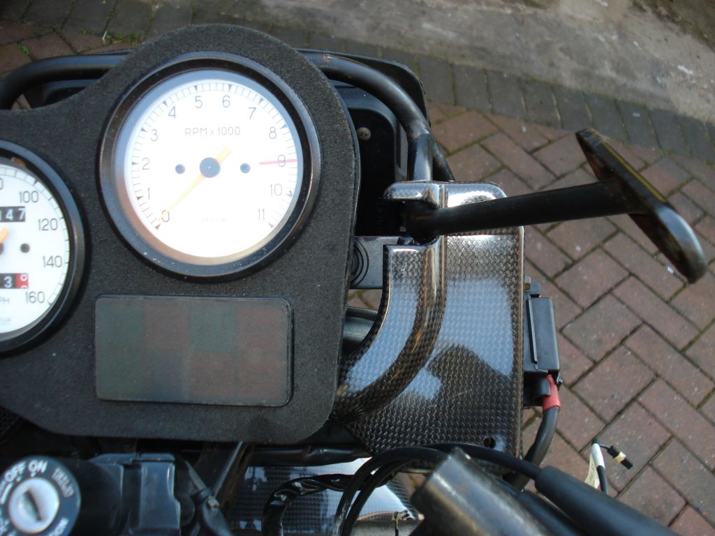

Dash surround carbon bits
I have a spare set of white faced Veglia clocks with Carbon surround alreay that came off the DB2, rims, bezels etc are in far better condition so old clocks will be ditched anyhow

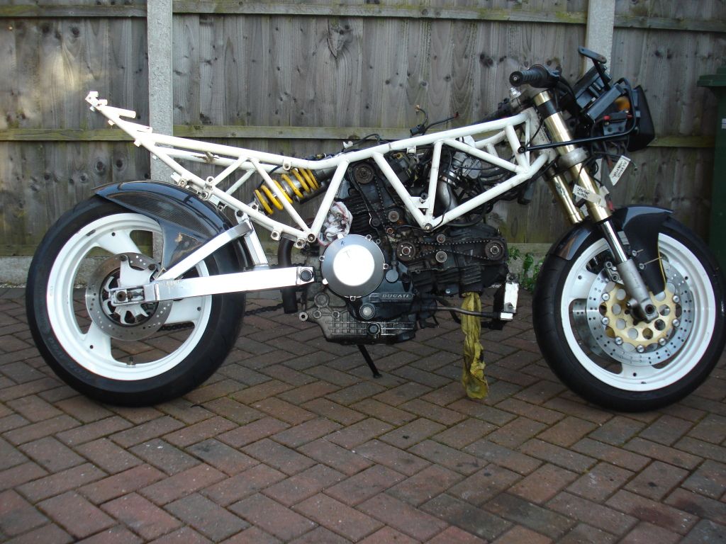

And one final one for tonight of the full bike, once the seat unit arrives, it will all be dry fitted to drill the right locating holes and check panel fit before its all off to the paint shop and I can send the other parts for powder coating and be left with the engine to strip, prep and paint.....
