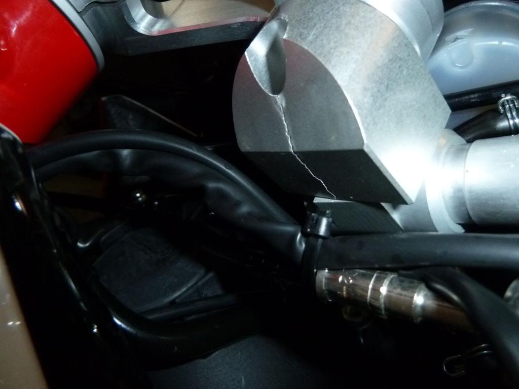

Both small aluminium pieces in mine have cracked!! However they have been replaced under warranty.

I would suggest that anyone who has a Tesi should pay attention to this parts. My guess is that these parts cracked by possibly being over torqued.
Its of course also possible that the parts were just not made strong or thick enough, but over tightening the joint would certainly put the pieces under undue stress and add to the possibility of cracking.
Does anyone know if BIMOTA has a torque setting for these pieces???

wow scary looking cracks there vagabond, as DAO suggested might be a case of overtightening, have no idea of torque values, I didn't tighten mine to much, the tapering design would hold fast I reckon, even if the bolt fell out Laughing

DAO, you're right - there's no torque setting for the aluminium pieces unlike say, the rear axle which is rated to 100Nm. I have never seen torque ratings for an Allan screw head on a Bimota.
However, I think the blocks cracked because it was under tightened, i.e. too loose. When you hit a pot hole, or a bump, the force on the handlebars from your upper torso and arms causes the clip on handlebars to slip downwards making the bike unrideable unless you quickly exert an upward force to pull the bars back in position again (or risk losing control). It is this turning moment I think, that caused the blocks to crack.
IMHO I think there's a design flaw there. If there were friction slots on the aluminium piece and the yoke, there wouldn't be this problem. Just my personal thoughts. Also, the entire rear subframe unscrews itself and you have to constantly check the torsion on the screws.
