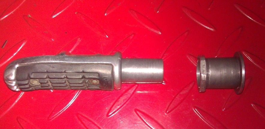

Posted: Sun Nov 18, 2012 9:22 am Post subject: |
Does anyone have a solution for this?
The shaft and the bushing are totally worn-out….
That's not strange when using soft materials for this construction….
What were they thinking when they designed this…
It is definitely not made for durability ..[/img] _________________ vince

Posted: Sun Nov 18, 2012 9:37 am Post subject: |
Vince186 wrote: |
It is definitely not made for durability ..[/img] |
Hmmm......
Very common problem I'm afraid.
Several ways to tackle it.
Easiest is to make a complete new sleeve which I've successfully done in the past along with stainless nuts as the aluminium nuts just split when you tighten them. I also skimmed the footpeg in the lathe to clean up the wear.
I thought of having a batch made but every case has a different amount of wear and a lathe is required for the final fitting so that's out as not everyone has a lathe to finish the job.
Terrible design and a terrible choice of materials.
It requires a harder sleeve shrunk onto the footpeg and a bronze sleeve complete (perhaps) _________________ SB6 mk1 (project mega light, big bore)

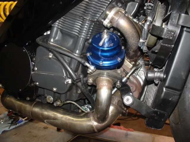

Posted: Sun Nov 18, 2012 10:11 am Post subject: |
loads of space for a turbo : )

about the pedal bushes Vince- there are new ones available, but they will not be any better though- maybe possible to fit a grease nipple underneath.

Posted: Sun Nov 18, 2012 10:13 am Post subject: |
oily wrote: |
It requires a harder sleeve shrunk onto the footpeg and a bronze sleeve complete (perhaps) |
That’s a good solution… why don’t you make a few for us forum users.
I was thinking to make a Teflon layer between it.
Advantages is that it does not require lubrication so dirt can’t become an abrasive pastes.
I have no lathe ... but I do have the ability to use a lathe at work (an old lathe) _________________ vince

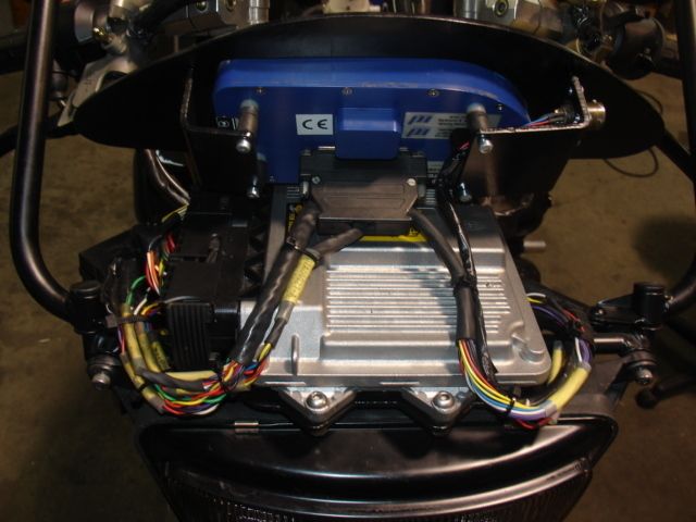

Posted: Sun Nov 18, 2012 10:19 am Post subject: |
Oeehhh....... sexy pictures Ian ..  _________________ vince
Posted: Sun Nov 18, 2012 10:23 am Post subject: |
...Very sexy.....
The ultimate, a turbo Bimota
Even on a 6R, with loads more room than a 6, they can't find room for niceties such as ........ headlights and things  _________________ SB6 mk1 (project mega light, big bore)
