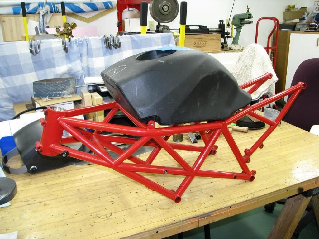

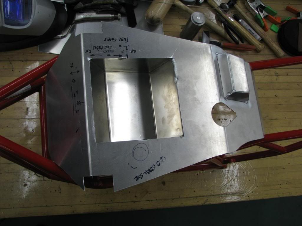

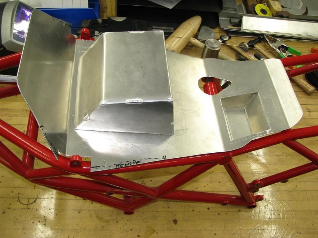

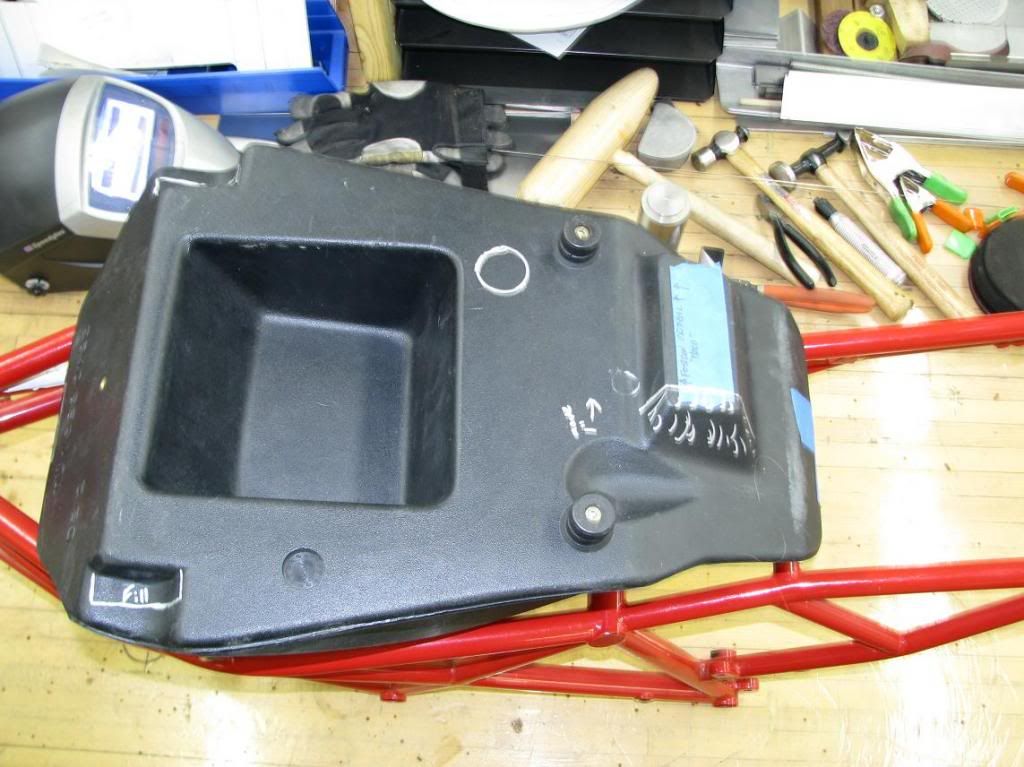

I am converting my DB2 to fuel injection. So I figured it would be easier to add the fuel pump and connections to an alloy tank.
Here are some pics of the start. I will add updates as it comes along.

I for one will be interested in reading this thread, and best of luck...Did you start with a an existing "full" Db2?
Everything looks new so far, and I'm inpressed with the tank building works so far....Always wanted something similar fitted to my DB4 with a cut out for twin throttle cable arrangement and space for flatslide carbs...My DB2 has this and hence lots of room as no need for an air box either then...

I've been a little concerned that my DB2 tank may expand due to all the ethanol in our gasoline around here....just like the expanding plastic tanks of the newer Monster bikes. I always figured an aluminum fuel cell shouldn't be too overly difficult to manufacture. I was thinking of doing something similar with a Paso project I was working on in which the original rusted tank would have the bottom cut off and the outer shell would only be used for cosmetics.....I really need to get back to workign on that project...and all the others I have.
