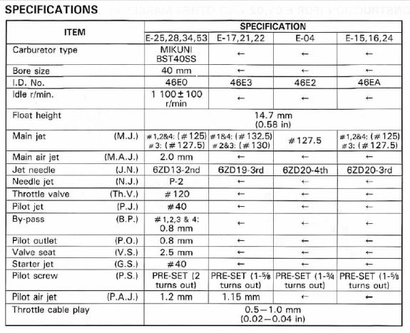

Hello Forum visitors,
Can someone explain to me why in my carbs there is a main jet with the size 122 installed? ( all 4 cil)
While according to the GSXR 1100 manual there should be a 125 for cil 1,2,4 and for cil 3 a 127.5 main jet.
ID number carb is 46E0
Is for the SB6 the jet size 122 normal?
Are there more deviations compared to Table for the SB6?
I want to order new parts but I’m not sure what to order. The parts that are already installed or the parts according to the Table.
 _________________ vince

Posted: Thu Jun 28, 2012 4:31 pm Post subject: |
Hmmmm….. I’m not the first owner…..
The problem is that the bike between 3k en 5k revs is driving terrible. I mean really terrible..
It is not possible to drive in those revs.
I cleaned the carbs and synchronized them but with no result.
Now I inspect the carbs with a closer look and I noticed that the needles are worn out (damaged) That the have placed a metal washer under the needles, that’s not normal according to the GSX manual.
All the jets are damaged by wrong handling with a screwdriver…. Probably they where thinking about there mother in law while they tightening the jets.
So mine idea was to replace the parts and to start again with the original settings….and see what happens than.
But can I use the settings from the GSXR 1100…
I can not find any setting from the SB6 or are those the same….  _________________ vince

Posted: Thu Jun 28, 2012 8:16 pm Post subject: |
stockcar wrote: |
i didn't think the std Gixxer ran the same carbs as the bimota?? |
The W series gixxer ran micky roonie 40 BST carbs the same as SB6 and 6R
In both the SB6 and 6R manual, the carb tables are plagiarised straight out of the GSXR manual so...........
Urban myth or another factory "truth embellishment" ? _________________ SB6 mk1 (project mega light, big bore)
