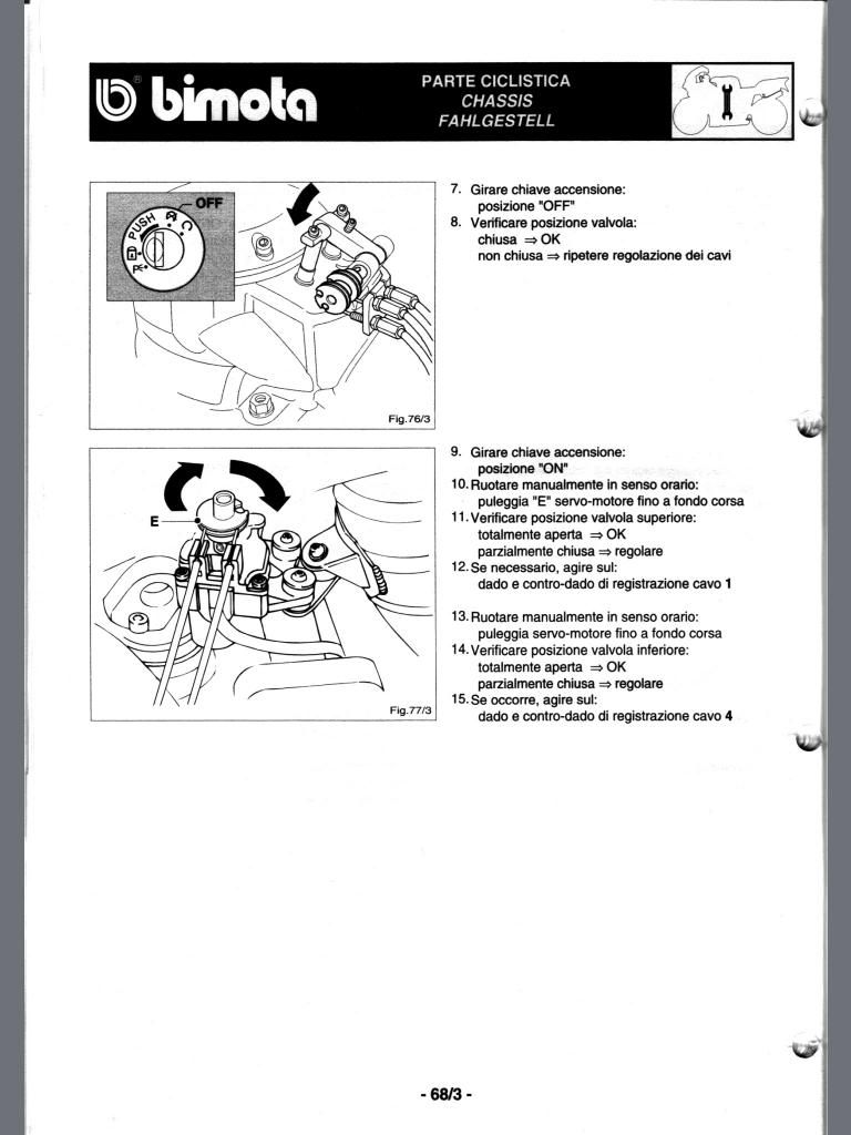

mm500
Joined: 18 Feb 2014 Posts: 121 Location: Norway
Posted: Wed Aug 13, 2014 2:21 pm Post subject: |

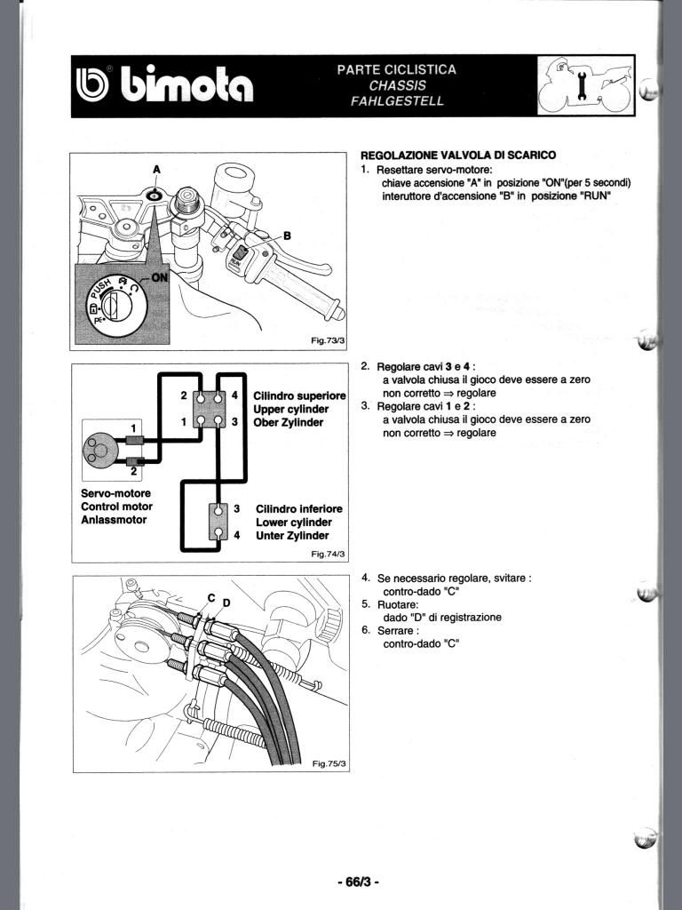

mm500
Posted: Wed Aug 13, 2014 2:22 pm Post subject: |
hope it helps you  |
