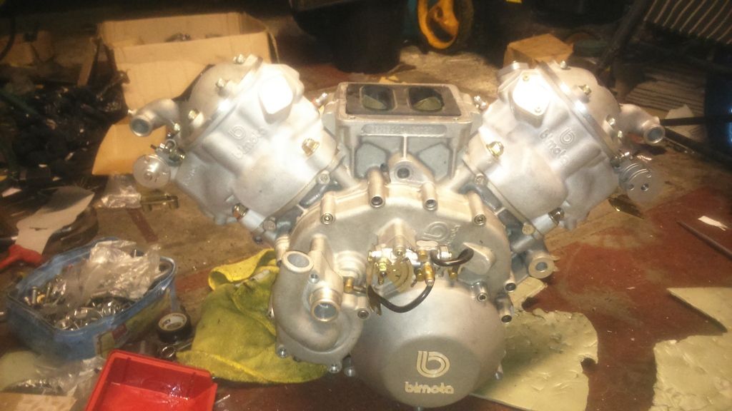

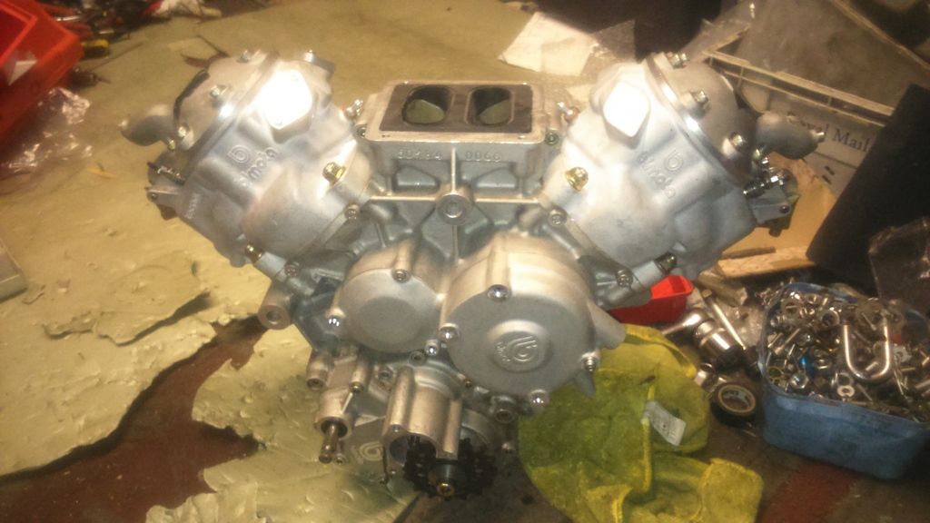

i got it built up trev !
could do wit an inlet manifold if anyone has bought a flashy frp one and will sell there old one ?

Opps
The heads and barrels are on the wrong ends
unless you are running it that way with the
Aprillia chassie ?
Trev

PostPosted: Sun Oct 11, 2015 1:22 am    Post subject: Reply with quote
barrels and heads are the same way as the other aprilia has been done
i might change them round
my mate measured the end float on the cranks if thats what you mean ?

I like what you are doing! Just tagging the thread, so I can see how you progress.
I've got a 1RK TZ250 frame (parallel twin) that I'm going to pop a RZ250, with banshee 486 cc upgrades into. We all need a bit of two stroke action in our lives... When it comes to these things, two strokes and I'm done. Shocked
Are those V-due motors wider than 90 degrees? sure look well spread out, and two cranks by the look of it? Interesting, but porky.
Cheers.

PostPosted: Mon Oct 12, 2015 7:03 pm    Post subject: Reply with quote
i think they are 90 deg and yes 2 cranks
both pistons at the top and fire at the same time
like a big bang 2 stroke
this was only about cranks and what i was doing with the engine
full build thread is on the2strokeforum
