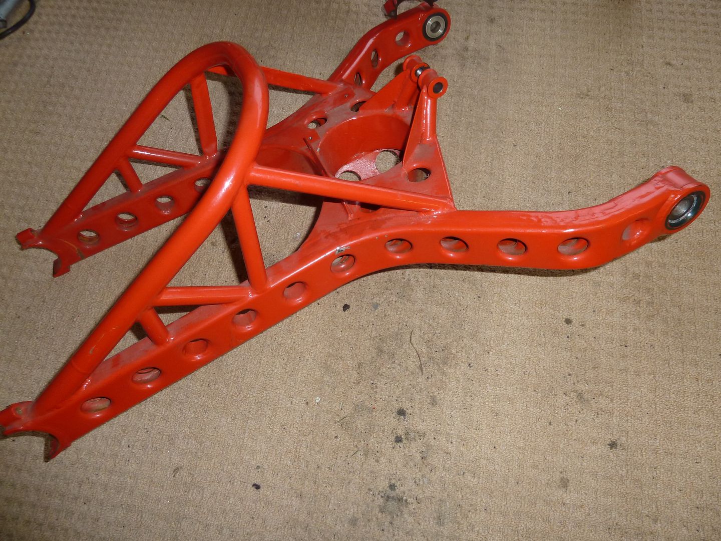

Standard swingarm on the right. The one on the left is drilled and lightened and 20mm narrower at the pivots

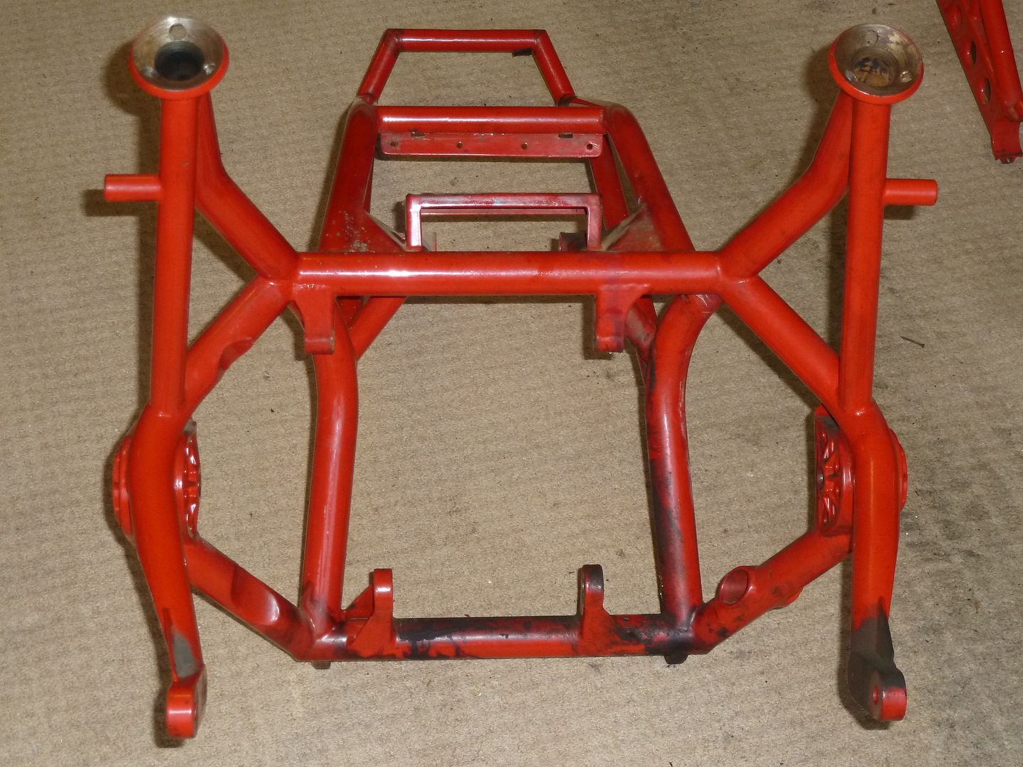

Standard frame, note battery mount, long fairing lugs and distance from lower rhs bottom engine mount to frame.

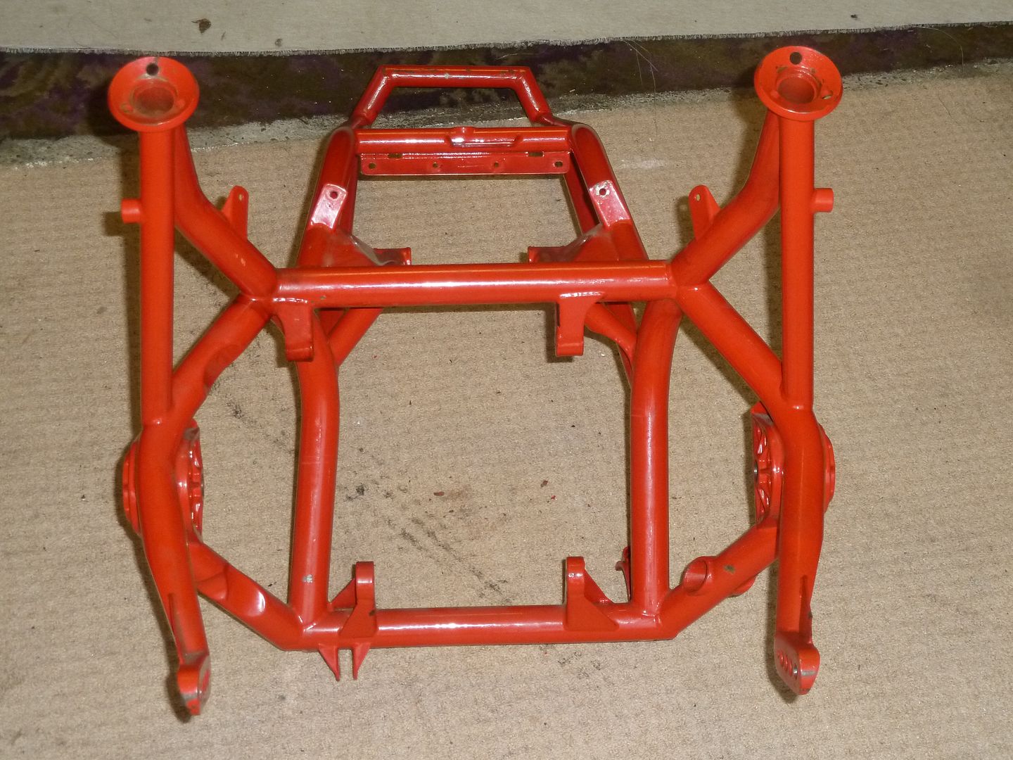

lightened frame, note frame is built different to allow more chain offset for larger width tyre, extra lugs on the top rail, extra lug on the bottom rail, no battery box base. The rear seat support has been added on and the frame originally only had 2 spars that weren't connected at the rear. Spacers with this frame were much smaller reflecting narrower swingarm pivot width
Picci of the swinging arm.
Ive had these parts stripped and all the welding looks original. So far failed to find any pics of this bike. The footpeg mounts are also cast differently to raise the pegs by about 20mm. Currently it has 16 inch, 4.5 inch rear, magnesium Campag wheels with well used slicks on them. The exhaust is also very light, with the collector box being flat instead of the 2x2 square box shape as per the "normal" SB3 and KB1, I suspect to increase ground clearance for the smaller wheels.

PostPosted: Thu Feb 19, 2015 7:41 pm    Post subject: SB3 swinging arm Reply with quote
Hello Nige,
some of the Bimota race frames for the Harley two stroke works racers in the mid seventies had peforated swinging arms like yours - it certainly doesn't look like something that could have been done after assembly,
Cheers, MikeJ
Posts: 582
PostPosted: Thu Feb 19, 2015 8:33 pm    Post subject: Reply with quote
It's defo been done b4 assembly as the swingarm is not just perforated box section, there is a stiffener in the middle. I get them back from the coaters tomorrow fully stripped so I can check before they get redone. See if all the welding etc matches up and see if they have had any repairs done

I didn't know they were fundamentally different sizes and engine offset. the plan was to make one really good one. I've checked the frame parts and it's all matching original welding except a small repair on a coil mount.

another difference I've found is that it's wider across the rear axle, despite being narrower across the swingarm pivot bearings. I'll pen an email to The factory and wait!😡

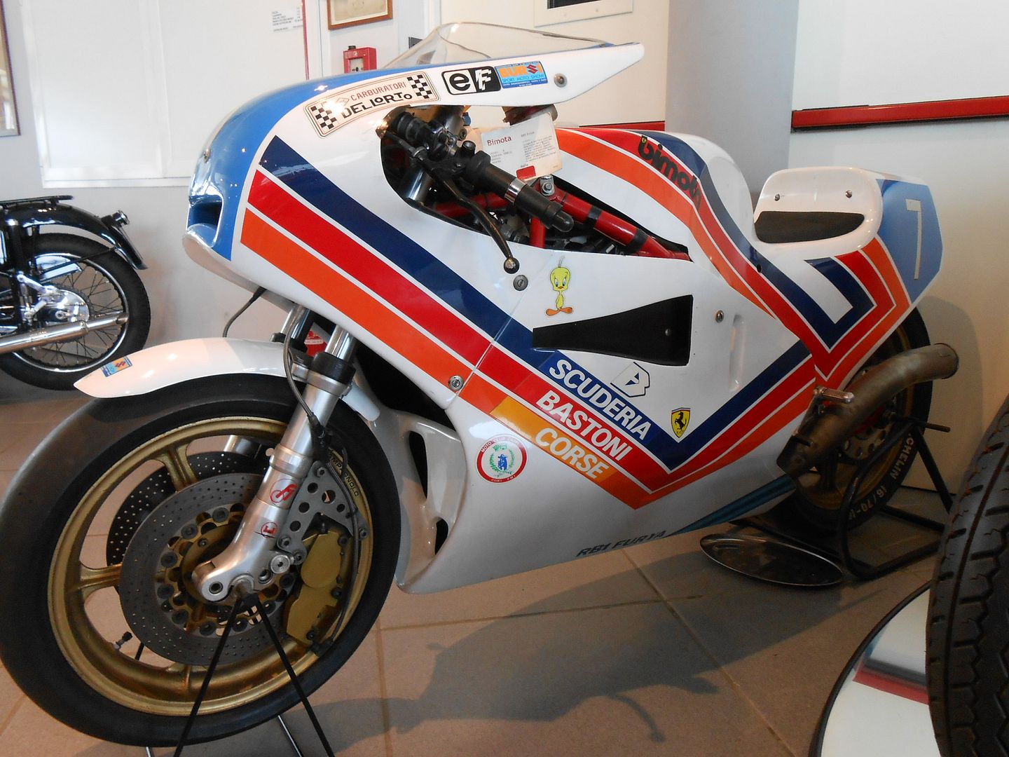

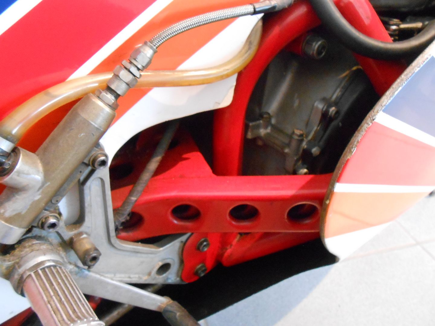

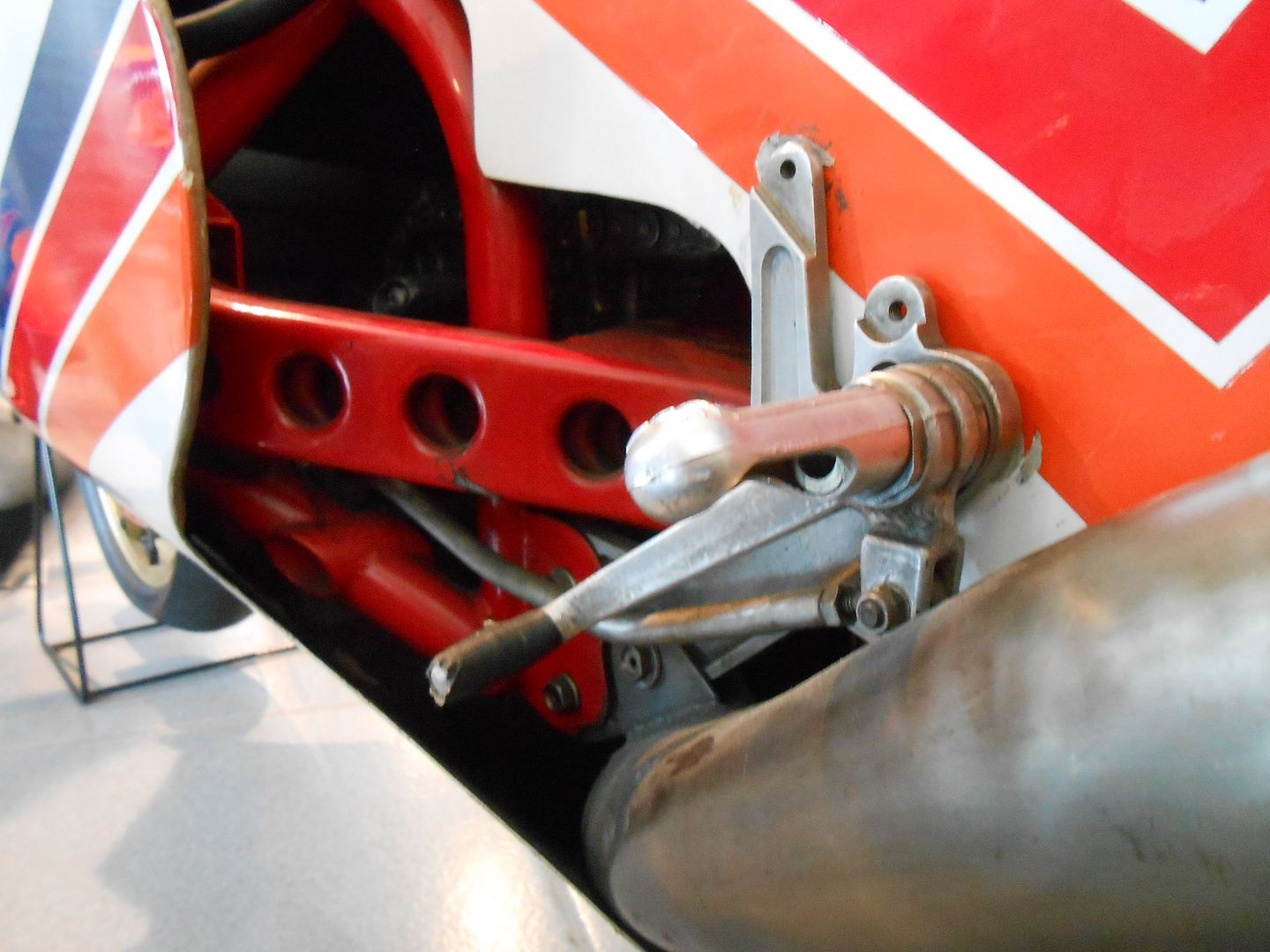

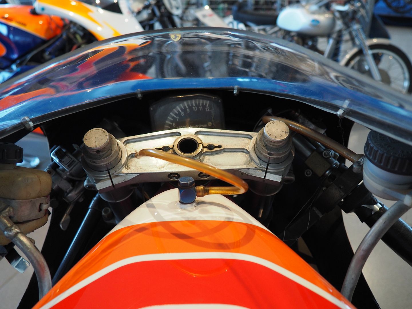

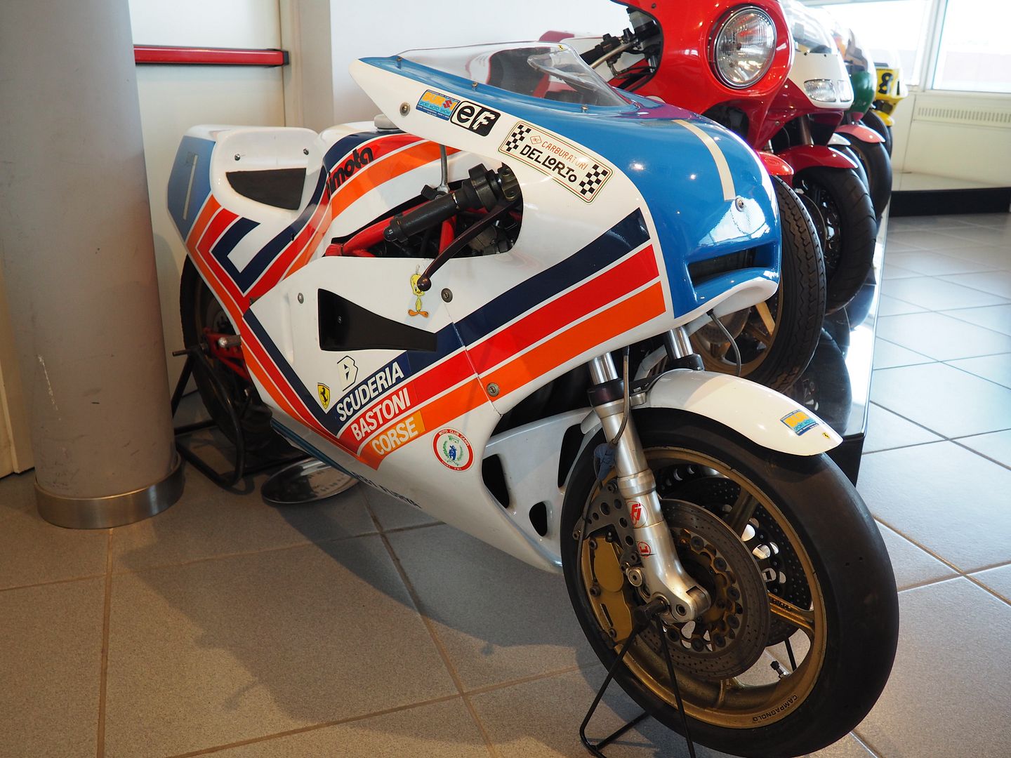

Just sent all my pics to Nige
they are also on Photobucket
http://s1214.photobucket.com/user/thecrankcase_com/library/Bimota/SB3-verona?sort=3&page=1
and a couple here

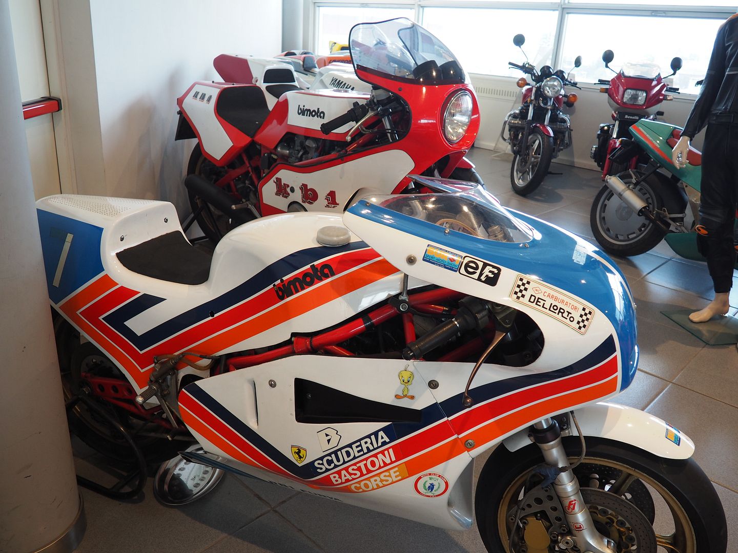

In the Nicolis museum in Verona with a KB1 for company

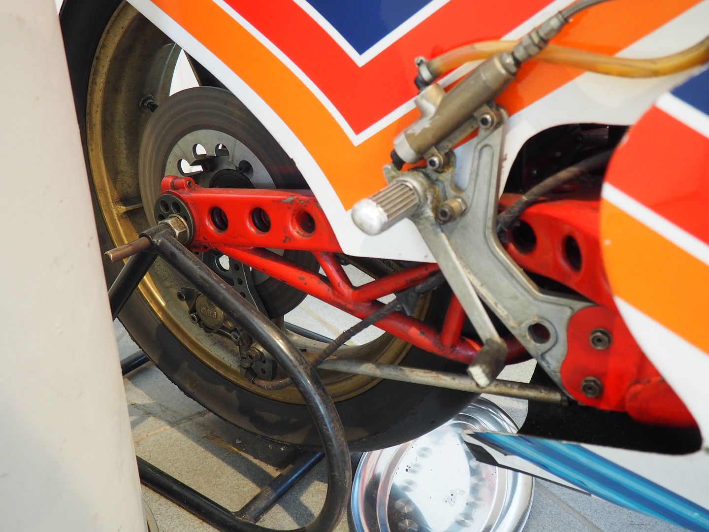

swingarm like Niges' extended footrest plates
Forcella forks with calipers that I've never seen before !
shortened footrests, maybe the brackets were left over from the right foot shift days ?
more holes
Looks like a bit of Ferrari connection ! exhaust plate says: DUERRE FIORANO but the first D could be an O or even a Q ?
The info notice with the bike calls it a RB1 Furya
wonder what the R stands for?
"the initials bimota and consist of the initials of the surnames of the three partners fondation white morri and drummers. This model was developed in workshops Ferrari. Racing department of Maranello. The windshield and a patent Ferrari"
looks like you have a really special bike Nige
wonder why nobody noticed it/remembered it before
We can't have been the first people ever to go in this museum . .
Would be excellent if you could get yours up and running looking like this
good luck
Ian
translation by google !
http://thecrankcase.com
