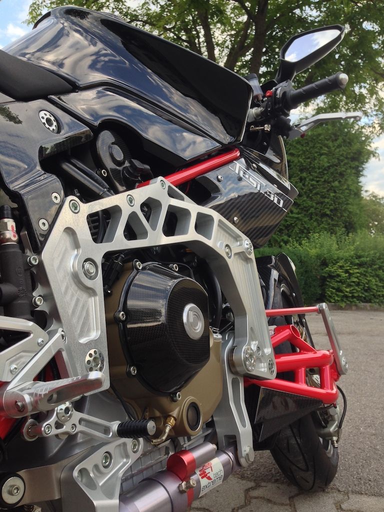

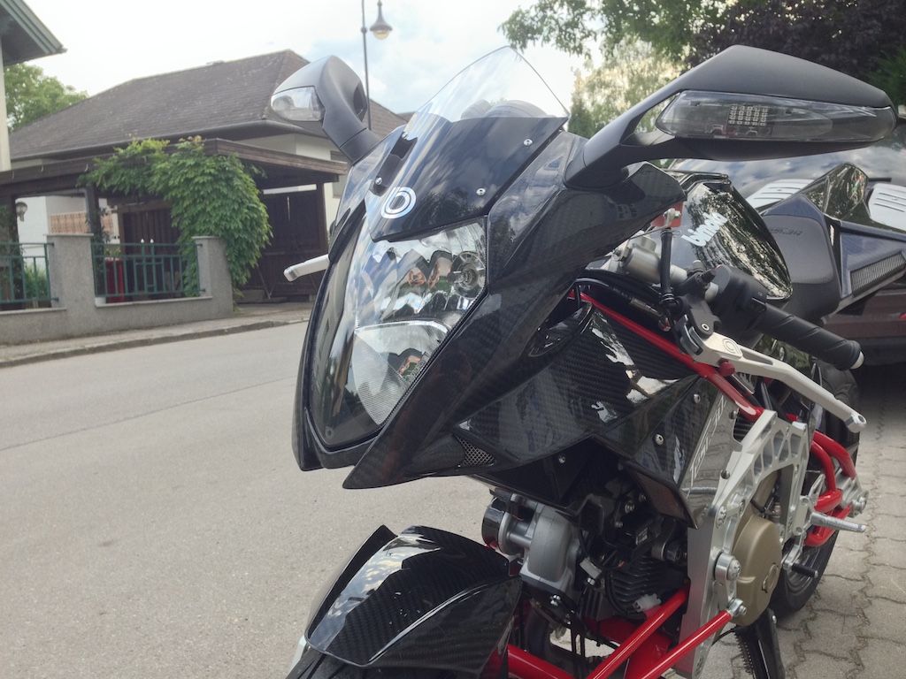

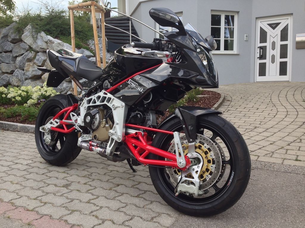

PostPosted: Fri Aug 26, 2016 11:12 am    Post subject: Reply with quote
Hi again!
Here some pics of my Tesi and my other bikes.
@Waggy: Thanks for your reply!

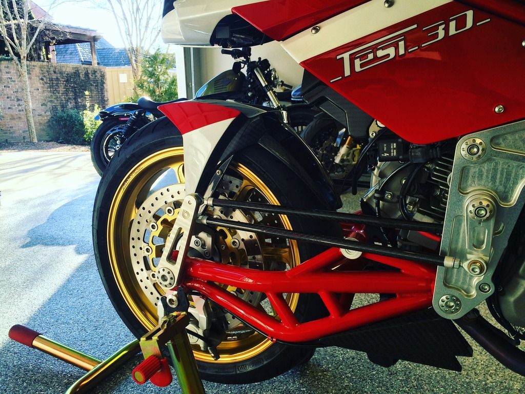

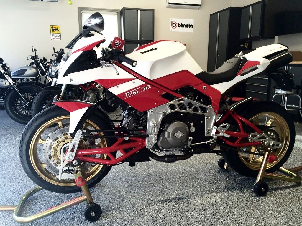

PostPosted: Tue Aug 30, 2016 2:43 am    Post subject: Reply with quote
You can use a standard rear stand like PitBull. There are two threaded holes on the front swing arm that you can attach stand spools. I used longer bolts and found aluminum sleeves that were the correct size. This will get the spools the correct distance from the swing arm. I raise the rear first and then the front. I took off the front wheel with no issues and the stand was not in the way.
