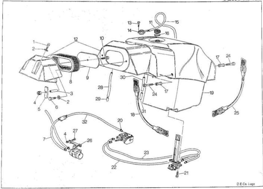

Does anyone know what the fuel tap for a YB6 tank is?
It has two outlets, one for reserve and the other for main. I can find quite a few with main/reserve but they only have one outlet.
I'm after the one that fits into the tank (above item 21 in the diagram)

I was going to refit the tank last weekend but couldn't. I thought about using the one off my spare YB7 tank but that one only has one outlet, the same as all the other YB's I've got.
On the other bikes there is a solenoid for reserve but the YB6 has a fuel tap mounted on the left hand side to switch between main and reserve. (fuel tap next to item 20 on the diagram)

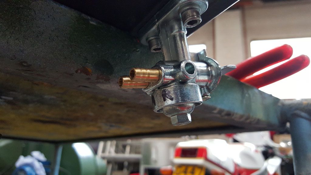

PostPosted: Mon Feb 01, 2016 5:30 pm    Post subject: Reply with quote
Just for a follow up to the OP.
I purchased the fuel valve from an RD250/RD350 for the YB6 tank. I had to slightly elongate the holes for the bolts to fit the tank but no problem.
On the YB6 it has the fuel tap under the tank (to isolate it when removing with fuel inside) and a main/off/reserve tap on the left hand side of the fairing. This meant I required a main and reserve feed from the tank to the auxiliary tap. I checked the newly purchased item buy blowing down the infeeds and turning the tap. On main, only the outlet for main allows fuel through. On reserve however it lets fuel flow through the main and reserve outlets. This is what was required to feed the auxiliary tap.
