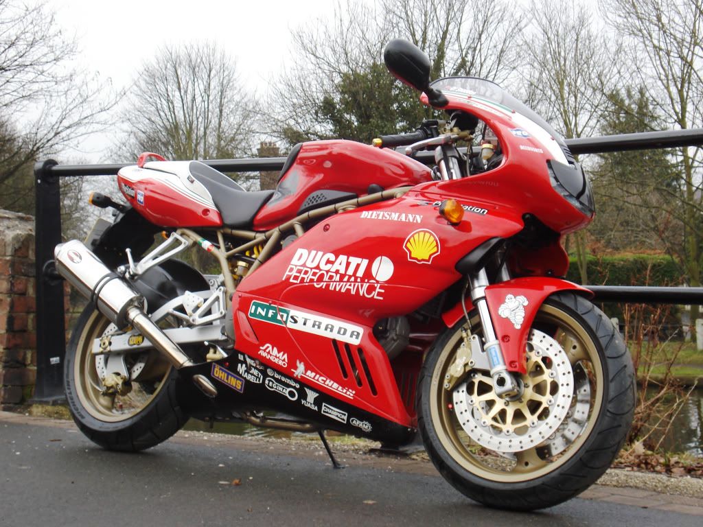

Actually I have a Ducati ss 750 ie, but I am a Bimota fan!

Hi Michele....and welcome to the Forum........Used to have a Ducati 750ssie myself....a nice enough bike although a little underpowered once you got used to it...and non adjustable suspension....but still a nice bike.

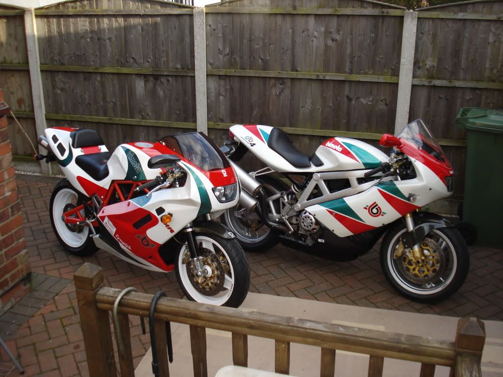

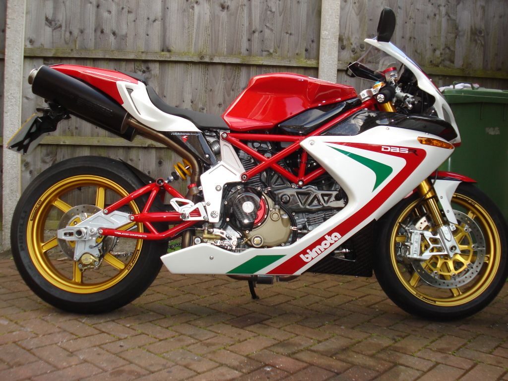

I have a Db4 tricolor and a DB5R.....easily the better bike is the DB5....just as light but with 10-15% more power....better brakes and better suspension...The Db4's usually have Pailoi or Ohlins rear shocks...and the DB5 has Marzocchi front forks and ExtremeTec rear shocks...if it was an R version it would have Ohlins front and rear which are much better....if it was used in a Supertwins cup race series I would imagine that the suspension was changed to Ohlins front and rear?....for which different yokes are used on the headstock.......
The Db4's are a nice bike and would feel lighter and more powerful than a 750SSie....I wouldnt bother with a Db4ie unless you can test it to see if it fuels correctly.....My choice would be a Db5 though...seat height is lower if this is a concern...and the footpegs can be lowered also as they have 3 levels on them.......Both bikes are comfortable over long or short distances....Db5's have either early pegaso ECU's or later Walbro ECU's....early models had bad fuelling at 4-5thou revs....

I also have both a DB4 and a DB5R . I have also had a DB5S twin seat.
The DB5 is a better bike , more power , easier to ride, better build quality and finish.
The 5S with the marzocchi forks and extreme tech rear shock is built to a budget. The forks are over damped and the rear shock very poor. An early mille is a better buy with ohlin forks and shock, but can have injection issues.
The 5R has the later ECU set up of the 5S and the ohlins suspension and carbon parts.The DB5R chassis is far superior to the engines ability and can therefore seem a bit boring and remote to ride.
I have no experience of the DB4IE so can not really comment on this bike.
My DB4 tricolor has the sport kit fitted ( flat side carbs/k&N filters and free flowing exhaust). It is less powerful than a DB5 and a bit more old fashioned to ride. BUT it is far more fun and involving to ride than any DB5 I have ridden. I have also ridden a standard DB4 which is not as entertaining without the sports kit.
If I had to sell either my DB5R or my DB4 I would know instantly with one would be going. The DB5.
