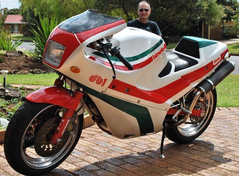

Found some pics !
That's not me in this photo!
Looks to be tidy, however not an original pristine example.
This bike will be ridden regularly so maintenance is important.
Hope the pics help.

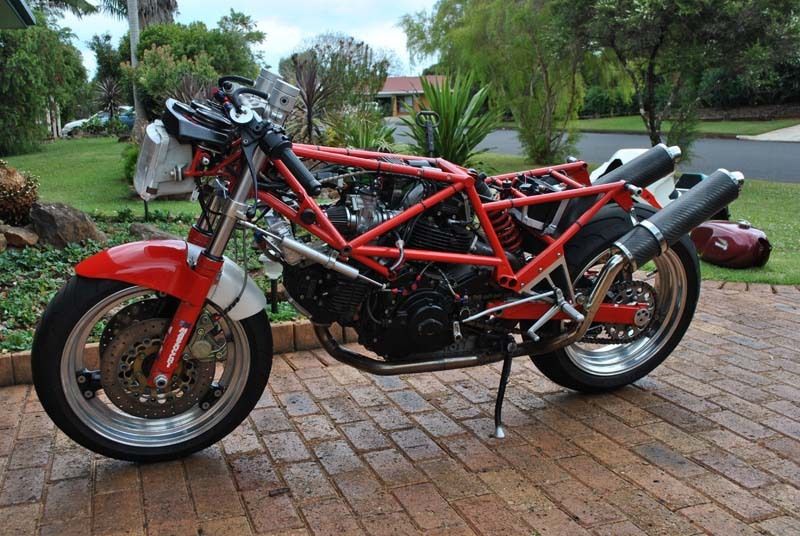

PostPosted: Fri Apr 22, 2016 12:07 pm    Post subject: Reply with quote
Now thats what I call information and exactly what helps us on here...and photos also on your first visit to the site....congratualtions...theres folk been on here for years that still dont know how to post pictures.....Guys...you know who you are.
Bike actually looks very original....and a proper professional engine conversion done as well....handmade tailored exhausts (Ducatis exhaust would never fit so nice and tight to the crankcase...)
Bike has original forks, original front discs (old rattly cast iron jobbies), original calipers on the front....seemingly original bodywork...although evidently repainted....they never said "bimbo" on the rear seat unit...normally desmo...but I kind of like that touch by the painter....
Seems to have holes in nose fairing for "california Vitaaloni" mirrors..which are still available and quite cheap really....
Rear swingarm is original Db1 with rear wheel concentrics....looks like original Marzocchi rear shock that normally has a remote twirly knob adjuster on the RHS swingarm....
Footpegs are original and gear lever...hangers are original but have been cut out where they are normally just recessed....
Sidestand not original...original fitted to the exhaust cross branch and is a suicide unit...which is pants.....so presumably this one is a Duc item bolted to the crankcase....
Clocks oriignal....etc etc...
Still has the brake and clutch reservoirs atop the marzocchi M1R forks.....twist to take cap off to retop up....BUT...BUT...if removing the reservoir itself on either fork top...be sure to be know that they are also the caps for the forks and a big spring will launch itself out and pop an eye out...be warned.....
Still has original round radial Brake and clutch masters with non adjustable levers.....These are a bit of a pig as they bend dogleg...but the wrong way...and after only a short while I suffered cramps in both hands pulling the clutch and front brake....possibly the seals shouldnt be trusted either after 30 years of service.....So get the lady to check if she can pull the clutch and brake constantly...hold it in and repeat for 20 mins...I changed mine for a better ratio gold series masters on both sides....but kept the hose link to the reservoir pots for originality...adjustable levers and better ration makes easy riding........The bikes are teeny tiny and perfect for a woman due to low low seat height...but even a 6ft 4 bloke can get on and tuck in.........
battery relocated to where the airbox/crankcase breather used to be...so no problems there.......
Discs front and rear are cast iron...so surface rust occurs but fine afteer riding...even though only single pot calipers its more than enough to pull it up...M1R forks may need a refresh...but I think you know your stuff......
Those wheels look like same as on the original Ducati 900 Superlight...alloy rims mag spokes....the rivets/bolts were known to crack/snap...so worthy to check....Ducati discontinued them after the first superlight.......
Thats about it for now.....gas her, start her and ride like the devil....

Hi Ken.....evidently check the age of the tyres also...should be a three or 4 digit number stamped on LHS of tyres....pre 2000 had say 797 meaning 7th month of 97...post 2000 have 2615 say...meaning 26th week of the year 2015....or the other way around I forget which.....Age....not so good...
One thing I have to point out which is MOST worthy...I see it has blingey blue red anodised banjos and braided hoses feeding the oil to the heads on both cylinders....evidently not standard...BUT...and its a big but.....take one of the anodised blingey banjos out and see if its a "mere" brake line banjo...or whether the hole in the banjo is suitably sized for tranferring oil and NOT much thinner and less viscous Engine oil....the hole should be about half the diameter of the threaded part of the Banjo...and not a tiny hole like it is on brake line banjos to provide pressure.
Wrong sized banjo holes on the heads can lead to Oil starvation on the top ends...and ultimately Seizure, blown cams, rockers, valves etc etc....seriously.....Blings OK...for some...but not necessary when they arent visible anyhow.........Another person on here bought a DB2 and found the same darn thing....incorrectly sized brake line banjos with fandango anodising in place of the proper Banjos for Ducati heads.......The proper banjos can still be bought from Ducati and are in stock at the factory....around 7gbp a-piece...as I've just ordered new ones for one of my bikes....they are a bugger to find on ebay as really quite specific to Ducatis....and not any other bikes that I know of.....The main hole along the length of the bolt is also a bigger diameter......
So check those puppies out first........

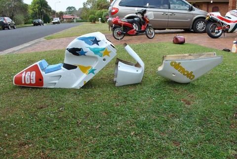

There is some spare body work as well.

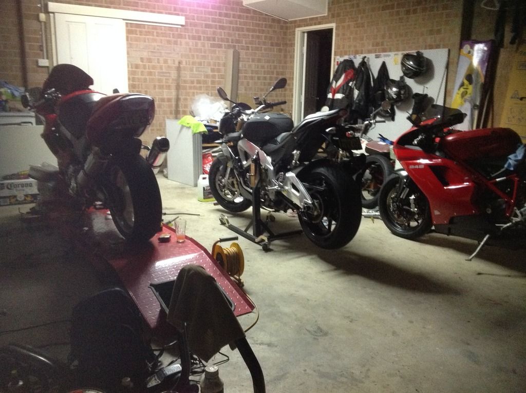

This is where it will be in the Man Cave.

Spare clothes also? Nice Bonus....possibly Airtech race stuff still available for sale in the USA...but over $2,000 plus shipping plus taxes plus would need painting....Original Bimota stuff is fibreglass and really very thick...Airtech do 2 types...thin race clothes and ones with headlight cut-outs for road use...
Still looks like original swingarm with concentrics to me.....original cast iron rear disc...original caliper bracket and caliper...original front calipers also on cast iron full floater rattly discs (check for wear on bobbins...around the rotor...side to side flap is OK...)
