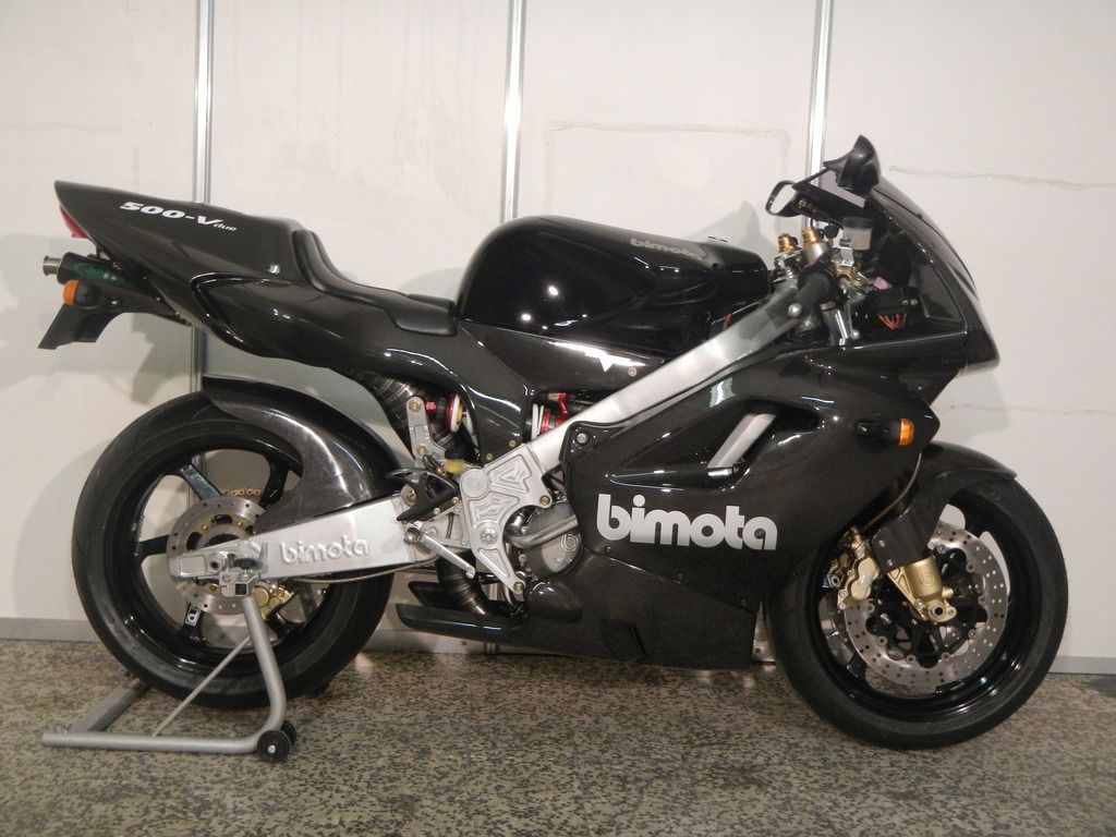

The bike is brand new - Carbed version with the updates and it has the race engine in. It has the race package, Jolly Exhausts and ECU upgrades and Carbon fairings with the exception of the Tank, it also has PVM 6 spoke wheels, and its from Piero.
He has called it the Carbon bike and has made 2 and I believe he is keeping one of them for himself.

Looks NICE Very Happy Laughing
Few subtle changes , shock,forks etc , that coolant pipe and the RHS side fairing moulding around it look different , and is that an alloy rad I can see through the fairing aperture ?
PostPosted: Tue May 03, 2016 12:53 pm    Post subject: Reply with quote
Sparkly Sparkly...shiney shiney...someones treated themselves to an early Xmas present eh?...
Looks like a Paioli rear shock...which were to be fitted to the Vdues....but only ever seen Ohlins on them before.....
Nice carbon bodywork....saves polishing ....

Please get this weighed accurately when you get it (with empty petrol tank or at least known contents) . With the wheels and carbon it would be very interesting to see a 'wet' (oils and fluids) weight. (Better do it when new cause road dirt could add a considerable %ge to the grand total when its used!!)

I will have to wait until I get the bike to have a good look at it without the fairings on and will let you know about the radiator. I will get a few pictures of it at this point.

Hi Yes Paioli rear shock and probably a Christmas present from last year!
