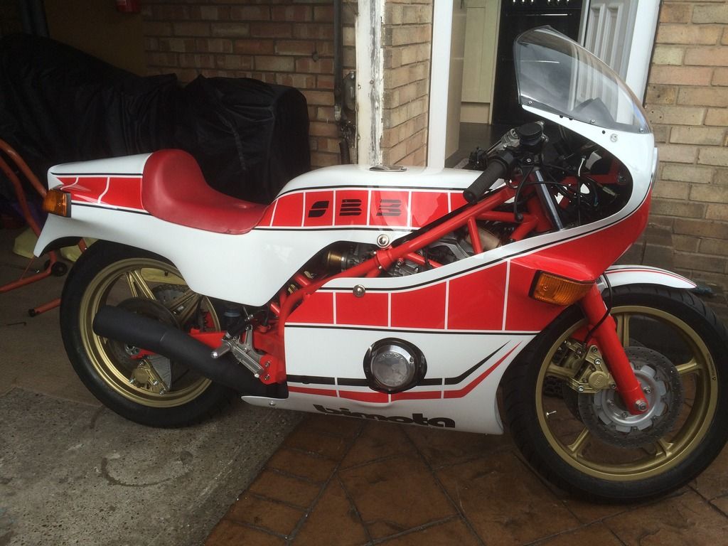

What wheels do you have , original speedline a or campags on? Either are tubeless. I've Michelin pilots on mine and my KB1 and they are fine 😄. I'm just sorting the front speedline out to complete.
waiting for pics 😄
Nige
[img] [/img] _________________ KB1x2, SB3 SB4 BB1 DB2 Vdue Evo YB11 RB1 Ducati MHR Suzi GS650 |
