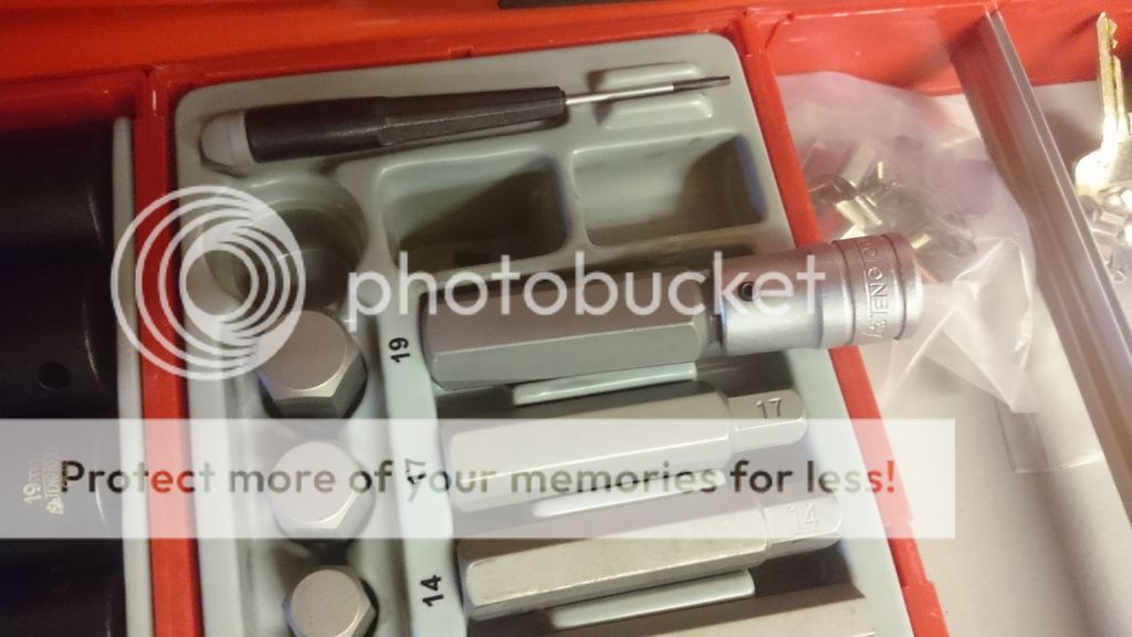

PostPosted: Tue Jun 28, 2016 12:12 pm    Post subject: Reply with quote
I use this set when removing my wheel. It has about a 50mm reach as hex is quite deep inside spindle.
I can't say exactly which hex drive I use, its either the 17 or 19mm , but can check for you over the weekend when I get home.

PostPosted: Fri Jul 01, 2016 10:54 pm    Post subject: Reply with quote
I suppose you have to hope its not the 18mm....as that tool kit hasnt got one...
As I said, that is what I use , so therefore not an 18mm.

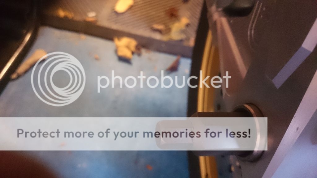

Checked for you Falcolion and both mine the same, 19mm
And like this when mounted in the socket drive.
