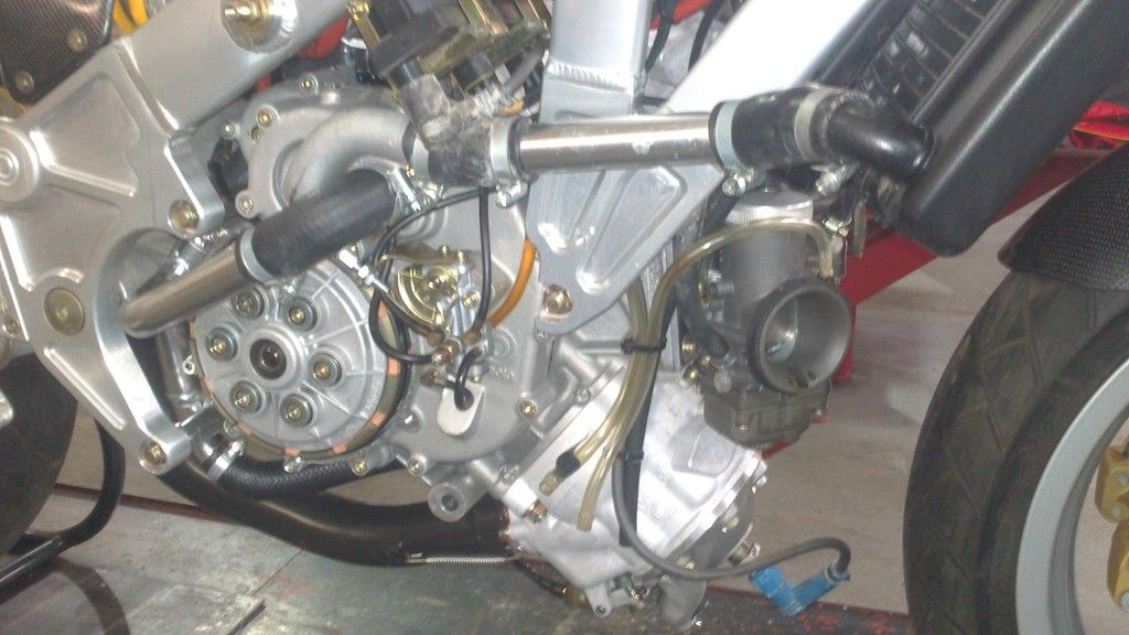

Here are some images, if you could maybe give me your opinion as to where this one might fit in?

What kind of air boxes do you have on that one (assuming they have been removed for the pictures)?

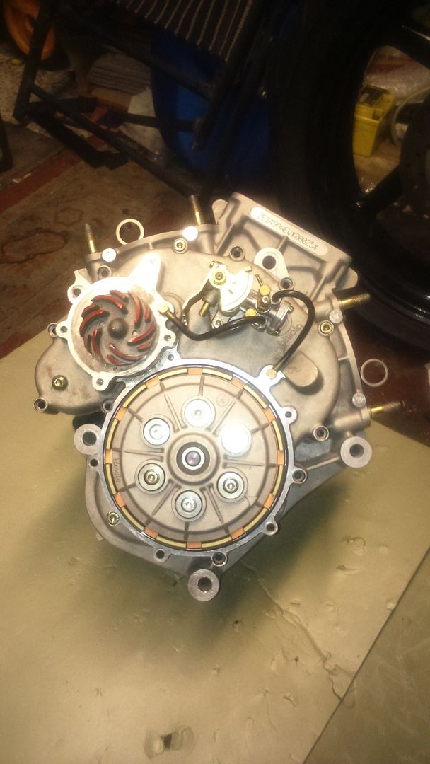

I know of a few early ones 003inj , 50 trofeo , 218 EF10, that have all got Piero mods , and one other thing that seems to be evident is they all have 500+ engine numbers , so maybe that would be worth checking.
