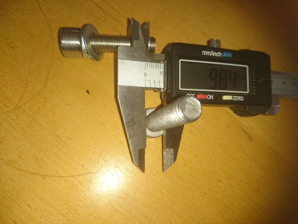

Thanks for clearing that up. You have already sent me pics and a drawing of your plate thanks, I did wonder about the spacers and bolts though, could you tell me info on the bolts and spacers please, diameters/lengths etc,

The "New" longer bolts (2 No.) that screw into the crankcase LHS of the engine are M10x40mm (threaded length is 40mm)....and the spacers are ally 10mm thick, 20mm OD and 10mm ID....and I use a locking washer on the front face....so its locking washer, bolt through this and through the sidestand plate/bracket, then the 10mm thick ally spacer and into the engine casing.
Looking at it closer with it off the bike I can see that the back alloy tube spacers are there to allow the repositioned spring to "travel without hitting the engine casing....and that these spacers could in effect be just 5mm max really
Sidestand in "open" stand out position....held all by itself...as the spring has been relocated past its pulling point in one direction and into a pulling position in another direction to keep it open...
Sidestand in its closed position "up"...a simple tap with your left boot pushes it back to its closed position and retracts and stays up....
I'm assuming that the same original springs are used....and that the top spring fixing is simply being relocated some 20mm or so from the hole on the black steel plate onto the added ally plate 20mm or so further along to give it its "2-way" holding position....so that it can stay open or closed/retracted..

Thanks for the pics and explanation great stuff. Just one question, what are the sizes of the long spacers and the bolt on the one which attaches the ally plate to the steel plate the stand is pivoted from?, is the spacer on the front side a stop for the stand when fully out ?

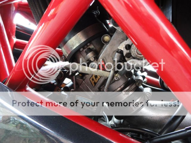

Forgot to mention TVRich....on the photo here of your carbs, LHS you see a steel plate going horizintal across the FCR41 logo....and to the right of this a spring with a cable attached pointing vertically down.......Flip up this black brake cable lined unit and you should find this is your idle adjust for the Keihin Carbs.....should be a loose cable with a knurled adjuster on the end....I cable tie mine up and to the left so that I can adjust the idle on the go at traffic lights etc or use as a "choke" when cold....you'll find the running increases the idle when the carbs are hot on a hot day....goes from say 1500rpm to 2300rpm....

That hole on the original sidetand is threaded....the bolt is an M6x50mm long bolt...and each of the spacers are 10mm OD and 15mm long at the front and 20mm long at the back.....spacers not a necessity...you could just use a further couple of nuts to lock it either side of the sidestand main plate...and one each again either side of the ally additional plate....the front part extension for me is a bit of engineering overkill...it just means you can locate a spanner on it to check and keep tight the nut on the bottom of the bolt under the alloy fabbed bracket...but if you used an allen headed bolt you can forget the "extension" long bolt and just use a M6x30 bolt with the lock nut behind the black steel original plate and a further 2 nuts either side of the alloy plate beneath that...that would do its job....as the extended length on the front face isnt a stop for the stand when fully out....the stand still stops in its original suicide stand position.....and hold there as the relocated spring now works in a different direction as the opening of the stand has pulled the spring past the pivot point of the stand...keeping it open....and with safety of a good 15-20 degrees of movement back before it auto retracts back.....a video may be the best way of showing you its action...so I'll see what I can do...maybe eve with a commentary.....a simple solution when you see it in action...although I take no credit for coming up with the mod to make it work....
