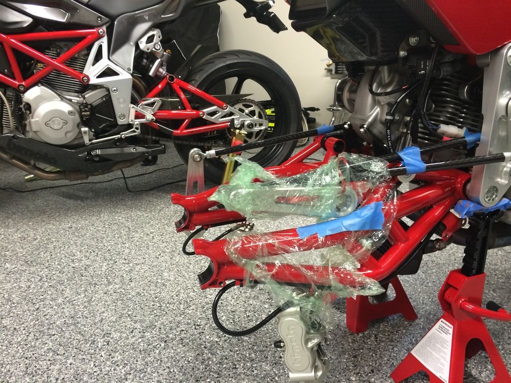

PostPosted: Fri Aug 26, 2016 11:02 am    Post subject: Reply with quote
Hi Franz,
I had the same problem with my tesi 3d, the location of the bobbins is so close to the alloy torque arms that any stand would interfer and cause damage, l couldnt find any stand that could do the job.
when l need access to front wheel l get a friend to lift front of bike and pop two axle stands under front of engine support plates. This will give great access to front end.

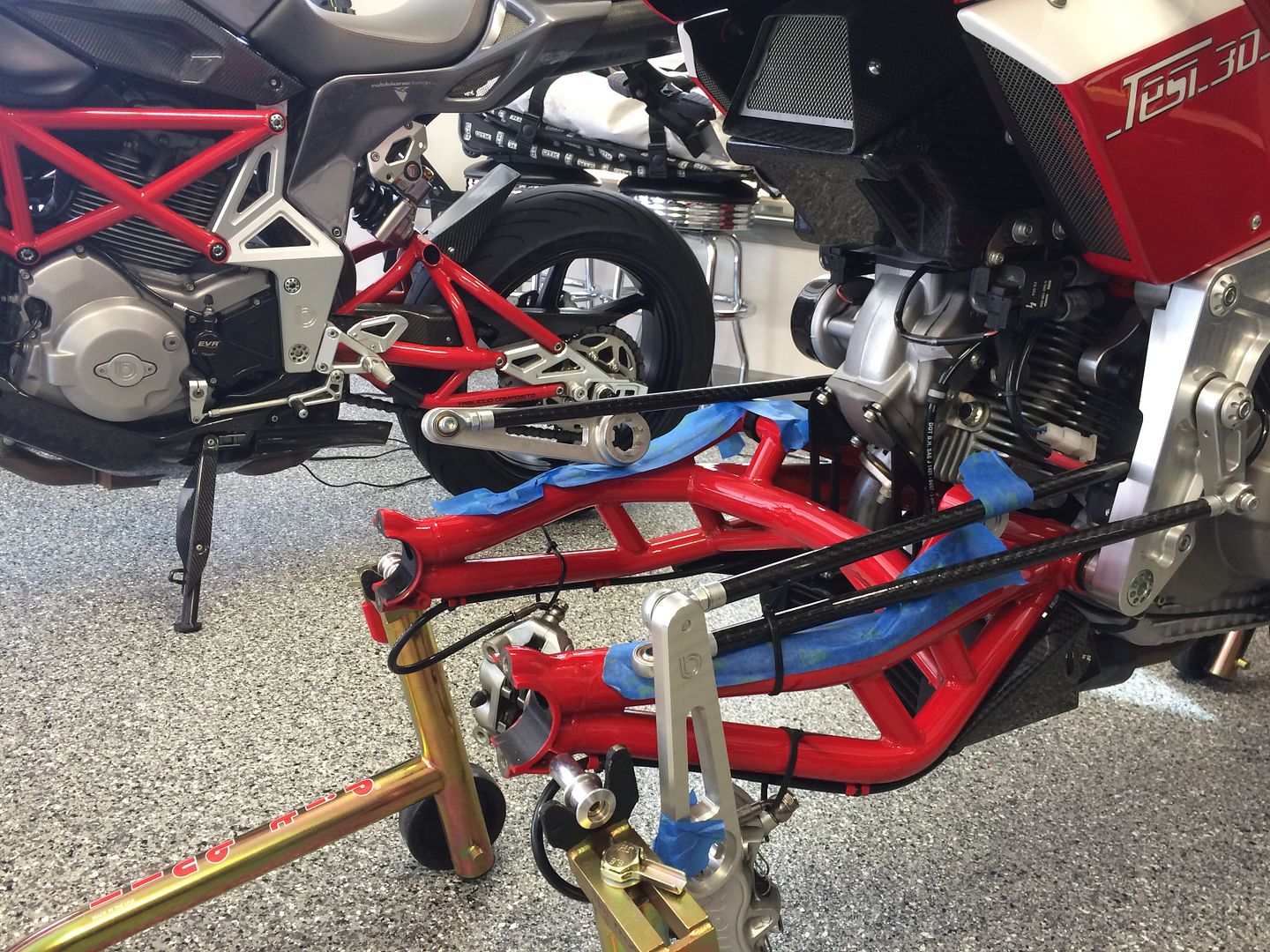

PostPosted: Tue Aug 30, 2016 2:43 am    Post subject: Reply with quote
You can use a standard rear stand like PitBull. There are two threaded holes on the front swing arm that you can attach stand spools. I used longer bolts and found aluminum sleeves that were the correct size. This will get the spools the correct distance from the swing arm. I raise the rear first and then the front. I took off the front wheel with no issues and the stand was not in the way.

PostPosted: Tue Aug 30, 2016 4:44 am    Post subject: Reply with quote
I used Waggy's system the first time I took the front wheel off. It worked well also.

PostPosted: Sat Sep 03, 2016 2:37 pm    Post subject: Reply with quote
Thanks for your pics, i'll try your solution with the rear stand in the front Wink
