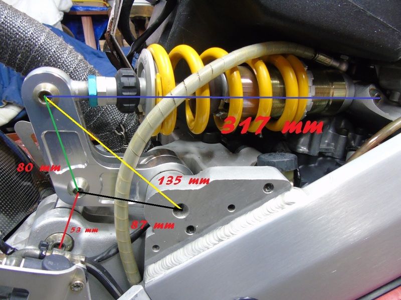

Okay, computer-tard is gong to try to post pic.....
1998 SB6R production date is 5/97 #000016
Swing-arm linkage with measurements ...
Center to center + - 1mm
Off picture, rear axle spread is approx 235 mm.
Built 5/97

Nice job with the pic and dimensions Wink

Nice pic, it almost encourages me but my head is being practical

I thought, if this could help one way or the other ...what the hay.... while I had her torn down, why not.....
Funny thing...Tearing the bike down was easier, for this old fart, than making the program on the computer actually work...LOL
I am, what I call....computer "UN"-literate....LOL.
