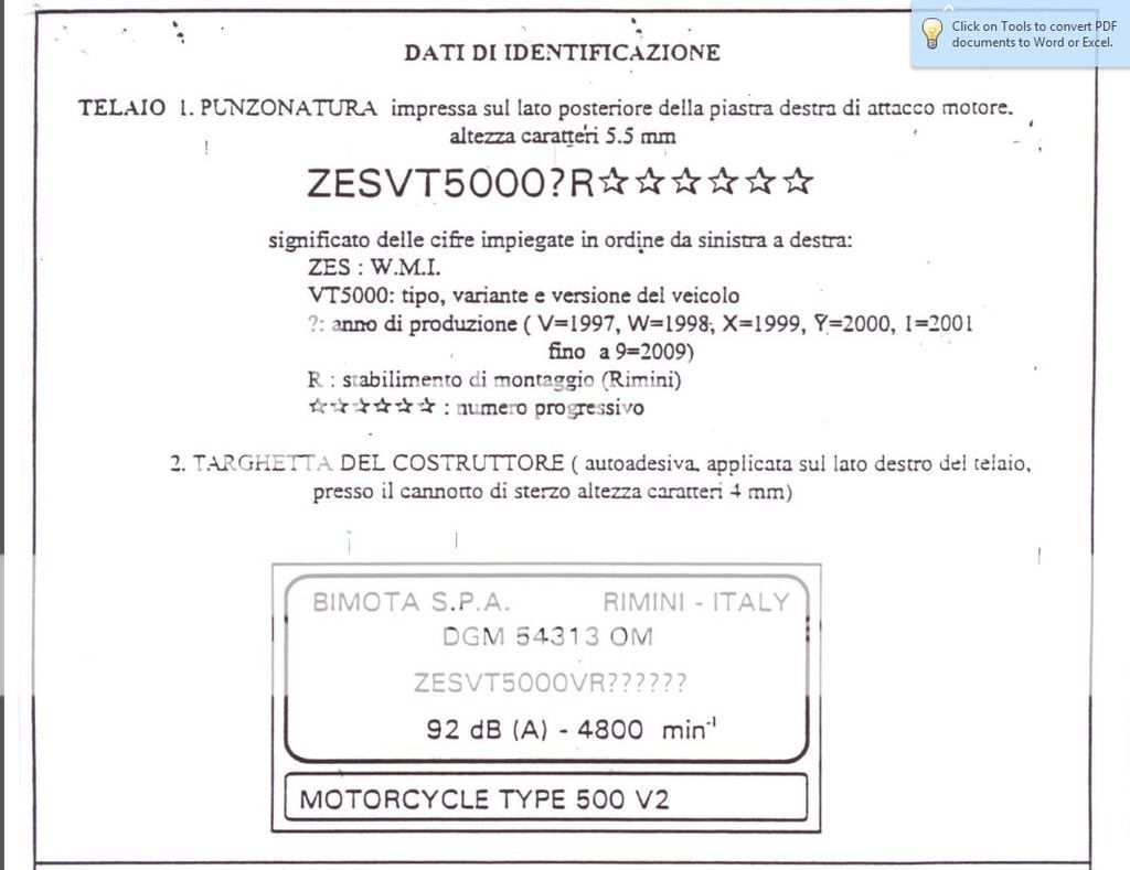

Vdue chassis numbers are like this
So W is 1998 , which is as your DB3.

Yup...its as Vort says......For some reason the USA got to number their bikes separate from UK and Europe.....and each year was registered different to that number stamped on the headstock....the number on the headstock is the "real" true identified number for the production run...supposedly 454 in total made between 1995 and 1998........at least your number of 313 on the frame isnt shown as being owned by another person on the only existing register as below:-
http://www.bimota.ch/register/register_bimota_db_en.html
Bob steinburgler of BimotaSpirit in the USA would be able to confirm...there was a US collecter that sld off a few Bimotas in the last 2 years or so whereby each Bimota, including a DB3 mantra, was claimed to be the First i.e. 0001 of each production run.....which we now know is a "run" of bikes for the USA where the USA got to number them differently for each year...starting at 0001 again each year.....The "R" in the serial number is for place of manufacture, that being Rimini

So, if I am reading all correct. My fame is #313. But when registered in the US, it was assigned #1 as the first 1998 registered.

Yup....thats correct.....and heres the original advert where it was described as vin tag No 0001
