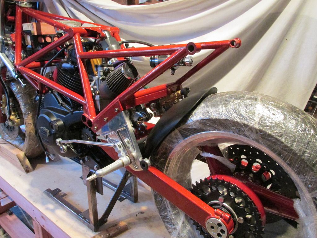

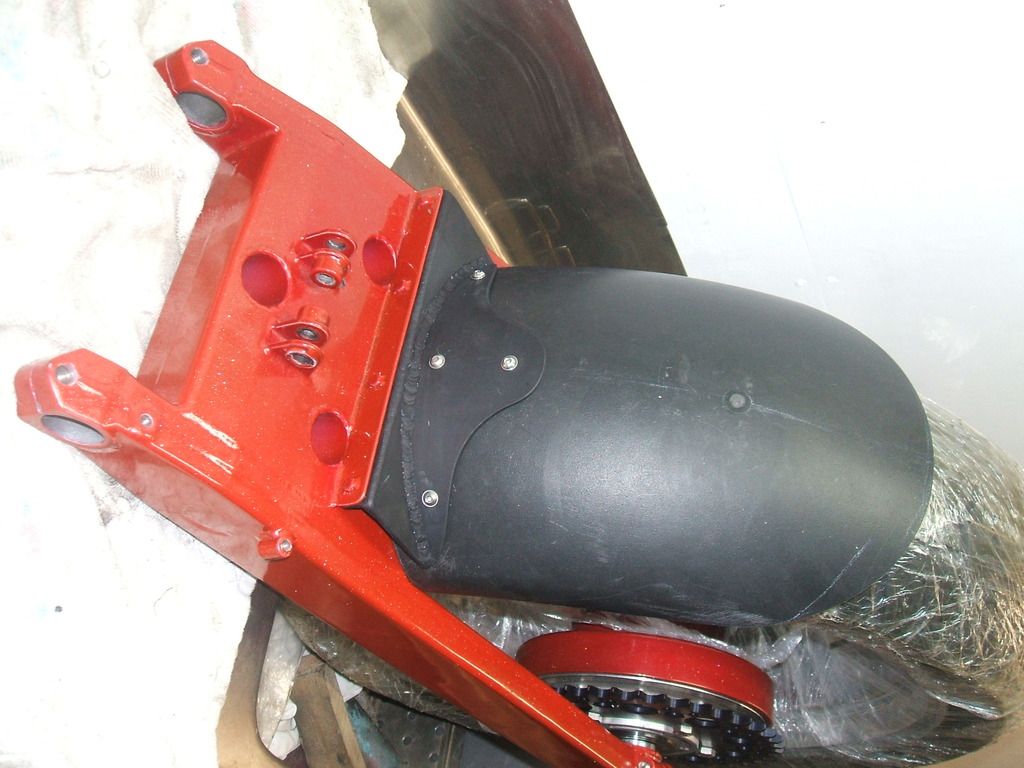

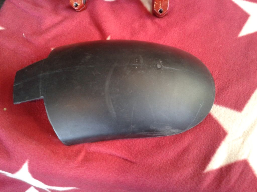

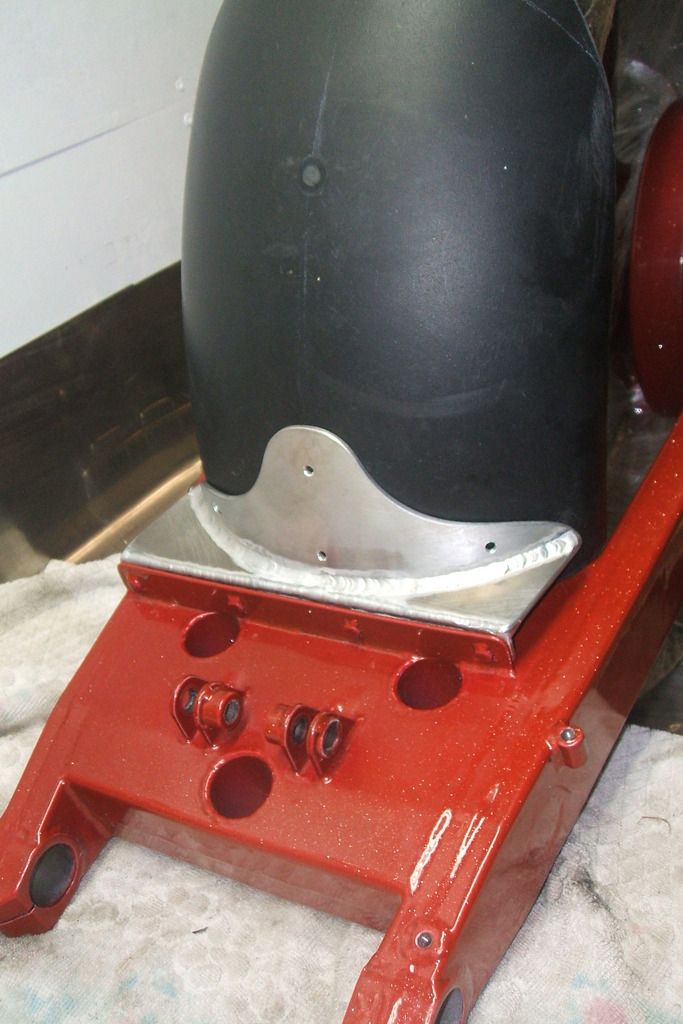

I used a hugger from an 851 Tricolour that was parted out (16" wheels). I cut it down and freshened it up to suit then had Steve Bridge at F1 Engineering make up an Al mounting bracket that was then painted black.

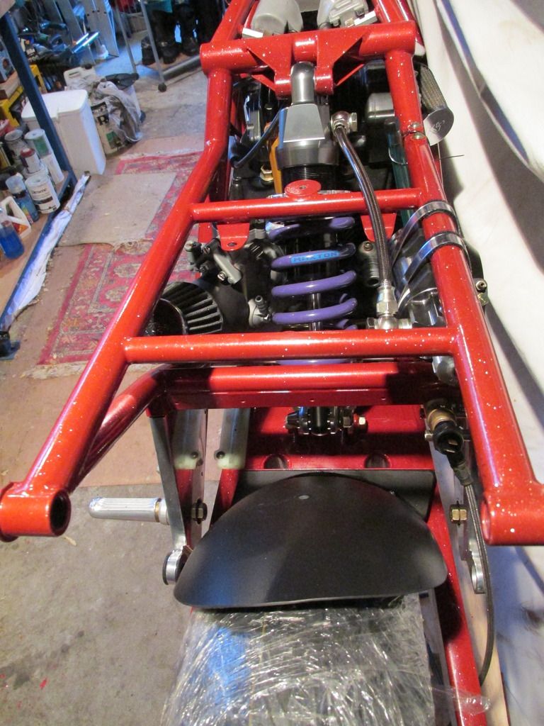

Is that a Wilbers shock that I can see, are you happy with it? as that's what I've ordered for my DB1

Shock is Maxton with high and low speed damping, M1R forks have also been fitted out with Maxton cartridges compete with compression and rebound damping adjustment; they did a great job and even retained the reservoirs on top of the forks. I can't comment on performance of the suspension as the bike is still coming back together; however Maxton have an excellent reputation when it comes to road and track set ups.

Nice touch. The hand made bracket is very Bimota Wink

Now that you mention it I can see the name Maxton on the spring in photo number 5.
