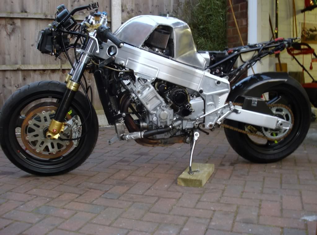

Cheers Who...I was kind of stabbing in the dark as my YB11 had the airbox removed and a set of Keihin FCR41 flatslides installed with K&N cone filters....presumably the inlet holes match up with the holes in the frame...matching to the inlet holes in the front nose fairing?
And the alloy tank etc... Rolling Eyes
I must say the best direction to go in... Twisted Evil Very Nice!

That's a mountain of work he's done there. Is the front of the tank a dummy to allow the air through to the pods?

Yeh...was a bit of discovery by the minute when I picked the bike up...Bimota Workshop manuals aren't the best...written by the office cleaner no doubt....and this one had lots different.......Big Bore kit, 1044 of somesuch....polished gas flowed head, carillo titanium crank rods, six speed box...that thwarted me for ages until I contacted the previous owner..."oh yeh...I dropped a six speed unit in"....I had countless going up and down counting gears through the box thinking my counting was out.....3 spoke Carbon dymags....AP racing billet 6-pot calipers up front...vented AP racing CI discs...AP racing billet brake master.....billet HD clutch pack.....extra rad added for cooling linking to existing...and that alloy tank with foam baffle filling and link tubes front to rear all done pre CNC days...just good old panel beating/bending and welding....Ruddy thing would do 95mph in first gear before the red line....shortly after I sold it to AN other on here....I just don't need a bike that still has 5 more gears left after 95mph..... Embarassed
No...front of tank holds fuel...you can see the rubber link pipes from front to rear section...previous owner with a mate used to ride this and his DB2 from London to southern Portugal...and he wanted a longer range tank for less stops....what with the thirsty flatslides though it probably just took the range back to what it was before the engine work......After I bought the bike and his similar very highly tweaked DB2...he sent me all the receipts for all the work done on the bike....even after he bought the YB11...he then garnered a further 14,000 on modding it...similar to what he did with the DB2....which I still have

If the front of the tank blanks off where the air used to come in, I'm amazed it's able to breathe. Perhaps he'd tuned the motor so much it only needed fuel and didn't bother with air any more Laughing

The tank did extend way deep down...but only at the back of the tank....the front space where the original intake was was left open and free.....with washing machine style tube intake ducting run from front fairing through frame holes to ram air to the tunnel section of the tank....corrugated K&N cone filters give something like 50-100% more surface area for intake than a normal flat foam filter...

That would do it and I can see how it would have made for an entertaining ride. I salute the man who set those flat slides up, given the pain it is to get the carbs on and off a YB. I can see why he moved it on - he must have been a gibbering wreck by the time he'd done - not to mention wielding the junior hacksaw on the frame brace to get them in Laughing
