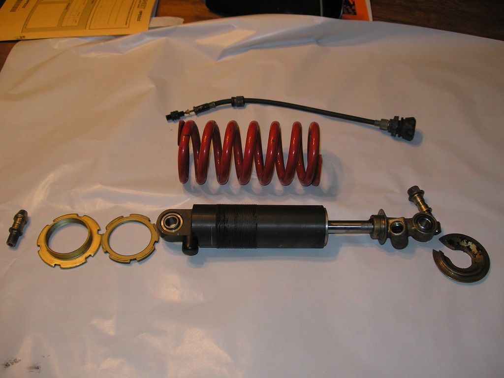

I pulled the old Marzocchi out of my DB1 and have replaced it with a Maxton unit. I have the old shock laying around the place somewhere. I'll try and dig it out tonight to see if the bump stop can be re-used, it's of no use to me any more. However I fear it will have perished and not be of use. I can post a pic when I find it so you can see what it looks like. Meanwhile this is what I have dug up from photo archive

PostPosted: Sun Feb 26, 2017 4:23 pm    Post subject: Reply with quote
Hello,
if the rubber bump stop has disintegrated, how do you fit a new one? Would you have to disassemble the shock?
Cheers, MikeJ

PostPosted: Sun Feb 26, 2017 5:01 pm    Post subject: Reply with quote
It looks like that is the only way. The bump stop itself is quite shallow. If one could find a flexible alternative it could be possible to cut it vertically then pass it around the 16mm piston rod and superglue it together./ I now have two shocks, my original alloy bodied one and a NOS steel bodied version, unfortunately the bump stop has disintegrated on both!
Resigned to have to get the shock rebuild.

PostPosted: Sun Feb 26, 2017 8:20 pm    Post subject: Reply with quote
You have to remove the eye end of the shock to replace the bump stop rubber. Glueing a split rubber in place wouldn't last one speed hump.
