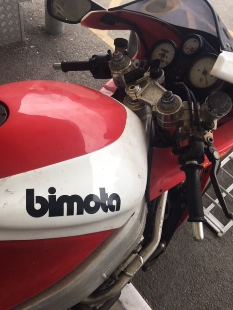

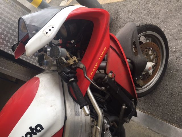

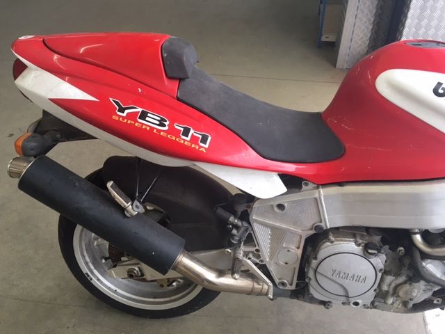

Pictures here:-
PostPosted: Sun Mar 19, 2017 11:56 pm    Post subject: Reply with quote
Don't worry to much about the rusted brake discs, they are an iron rich metal which rusts up, the discs will rattle on the carrieRS (gold inner) too. You can clean the worst of it off with some petrol on a rag (wear gloves)
PostPosted: Mon Mar 20, 2017 1:58 pm    Post subject: Reply with quote
Bit dusty but looks like it would make a good project for someone.

Do you have the missing fairing part and wing mirrors ??? Have a look around they're probably somewhere
Sarahfry
Joined: 18 Mar 2017
Posts: 4
PostPosted: Wed Mar 22, 2017 10:16 am    Post subject: yb11 Reply with quote
yes I have the fairing and wing mirror.
