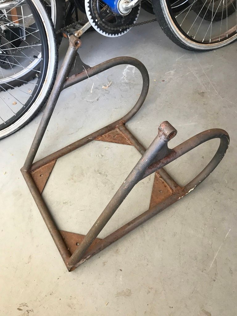

I am about to restore the rear wheel stand, which I was told was a Bimota issued product. I am planning to use this on my YB10.
I am missing the support cross rod. What are my alternatives?[/url]

Not a very good pic but it's simply a long bar with an 'R' clip in one side and a "top hat" on the other end to stop it pulling through

Ok, I guess I need to make one. Will go for the largest diameter rod that the stand will allow. Nice refinish on yours. Did you powder coated it? How can you keep it from having the paint scraped off?

Measure the spindle internal diameter rather than the stand.
or use one of these with a paddock stand http://www.ebay.co.uk/itm/BIMOTA-SB6-SB6R-VDue-SB7-DB-YB11-YB4-Paddock-Stand-Through-Axle-Bobbin-Kit-/282445062410?&_trksid=p2056016.l4276
