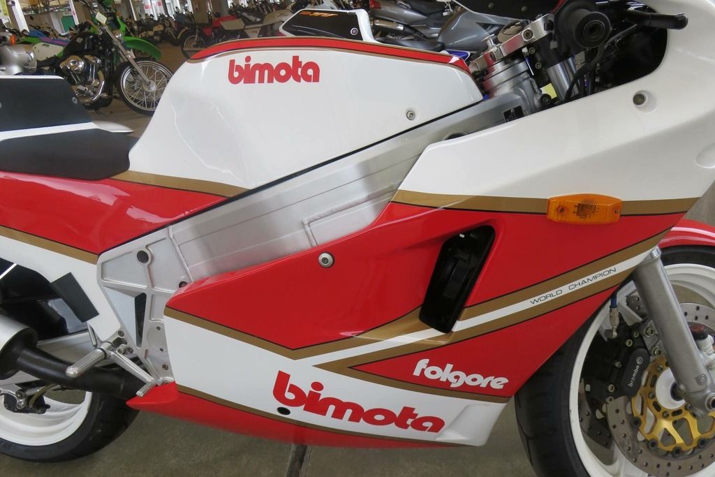

PostPosted: Sat Aug 05, 2017 6:22 pm    Post subject: Quick pic of the new toy / money pit Reply with quote
[img][/img]

I see you still have the anti-dive valve on the leg of the right fork. When I had my forks overhauled by Maxton, some decades ago, they took that off & chucked it in the bin. Other than that, for such an old fork, the M1Rs work pretty well.

Posts: 836
PostPosted: Sat Aug 05, 2017 9:32 pm    Post subject: Reply with quote
Looks nice & clean
Posts: 525
PostPosted: Sat Aug 05, 2017 10:14 pm    Post subject: Reply with quote
Nice clean looking bike. Is it coming from Japan?
btw the adjuster on the right hand leg is rebound adjustment.
PostPosted: Sun Aug 06, 2017 8:39 am    Post subject: Reply with quote
Welcome to the forum Kevin. Your bike looks fantastic mate

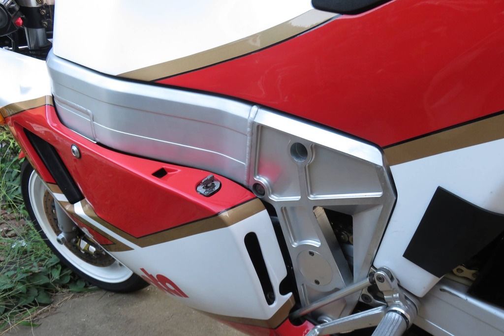

PostPosted: Sun Aug 06, 2017 9:19 am    Post subject: Some more pics Reply with quote
[img][/img]
[img][/img]
It appears to be in very good condition for a near 30yr old bike, ticks over and runs perfectly with no hesitations at all.
Just need to wait on delivery then it will be getting used pretty much straight away. Very Happy
