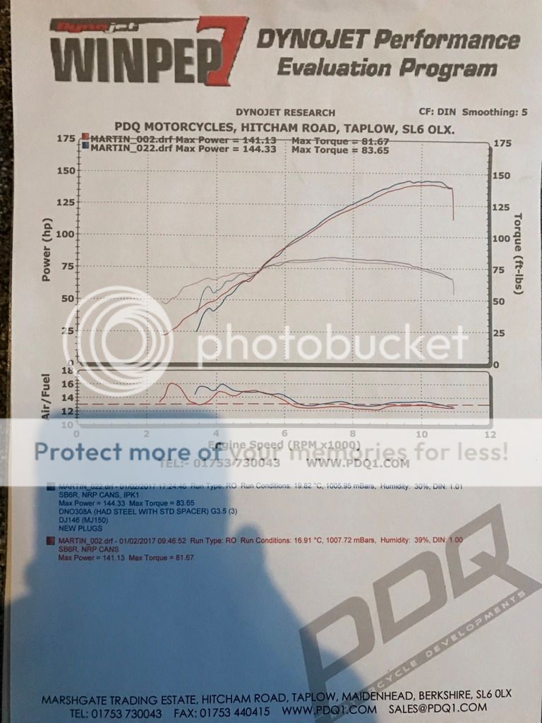

Exactly the same on mine. Here's the dyno chart from PDQ. You can see they have cleaned it right up and it's massively improved and a much nicer ride. Larry said most of the issue was lack of use and the general amount of crud, gunk and corrosion in the carbs. They need to be used or properly drained down.

GeeKay, I would check one or two other things before you change the pilots: if you still have the fuel pump in the air box - it needs to be removed and binned. If it hasn't had the valve clearances done yet (every 7,500 miles) - that may well help. I'm on the original pilots and it's very crisp on the pick-up from idle.

I do intend to keep the original jets - just think they need cleaning out as the bike has been stood for some time - much the same as Spongebob's. The fuel pump will be removed at the same time as the carbs are cleaned. Interestingly, the tick over was set at 3000rpm................

For it to have been set at such a high idle suggests another problem I'm afraid. Ethanol in petrol attacks the plastic fuel tank, or its lining. As the fuel/plastic combination separates in the carbs, a white-ish deposit is left in the carbs. This deposit naturally blocks the smallest jets first - namely the pilots, preventing the thing from idling at the prescribed 1100 rpm. The solution is an ultrasonic clean of the carbs and a re-line of the tank. If you just clean the carbs, the problem will be back again in short order, necessitating another ultrasonic clean of the carbs. You will be able to see if you have this problem when you pull the carbs, as you will see the throat of the carb, downstream of the butterfly, streaked with the white-ish deposit.
I have seen this problem explained away by sellers of bikes as being the result of the 6R being like a race bike that only runs properly once it is opened up. Complete tripe of course, because the motor is from a road bike!

I've read that Bimota put a pump in to address starvation issues at full chat. However, it is a vacuum operated pump, so it is operating from idle, where it can give rise to over-fuelling. With the fuel tank higher than the carb float bowls, there was no reason it shouldn't run on gravity, which it does and I've never been conscious of starvation further up the rev range having removed it. I removed the vacuum hose from the manifold and blanked off the spigot and the hole in the air box. I then re-plumbed with a "1 in - 2 out" Pingel fuel filter replacing the original fuel filter and "Y" piece. To be fair, I replaced the heavy exhaust and increased the size of the main jets accordingly, which may have addressed starvation further up the range which I might otherwise have experienced, absent the fuel pump.
In the opinion of some, the 6R suffers from too small an air box. Whilst it doesn't seem to struggle feeding a big bore motor, if true, it could only be helped by taking the fuel pump out.
