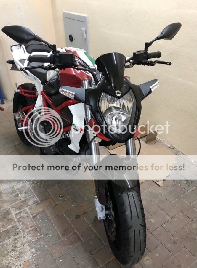

PostPosted: Sun Jun 17, 2018 7:28 pm    Post subject: Pics as requested Reply with quote
Thanks for the response. I think you actually answered both questions so very much appreciated. I just assumed the light would dip the wrong way so that is music to my ears Smile

Very nice

PostPosted: Sun Jun 17, 2018 8:41 pm    Post subject: Reply with quote
Psuedo "R"....has a few of the bits for an "R" but missing a few...nice bike though and not seen one with the tricolor painting on tank and tail before....I can help you reset the service light on your dash also (comes on from mileage at 1,000kms and again later)...indicated by the red spanner....just phone on my mobile that I have sent you as a private message

PostPosted: Mon Jun 18, 2018 9:06 am    Post subject: Genuine Factory R Reply with quote
Hi, this is a genuine bike and not a copy. There were a lot of added extras from new which pushed the purchase price through the roof. It is a one owner bike so I absolutely know the history.

PostPosted: Mon Jun 18, 2018 10:29 am    Post subject: Re: Genuine Factory R Reply with quote
Oh dear...I really hope that I havent upset you...especially if it isn't even in the country as yet.....emails/typed words can often be "mis-construed" hence why I sent you my mobile phone number....
Yup...its a genuine Bimota....what I was trying to explain by saying "pseudo" "R"...which was a hidden joke/reference to a fellow member on here...and a good buddy of mine...is that it is NOT a genuine R model of the Db6, but one with a few extras to reference/clone it into a DB6(R)......
Thanks for the YouTube clip...I saw that about 10 years ago the first time around.
The bike is missing the lightweight silver wheels and brembo discs...it has the standard DB6 wheels from a cagiva Raptor and wavey braking discs...it has the engine with the standard alloy crankcase covers and not magnesium covers painted gold...It has a dry clutch but not the £1200 extra option of the Bimota Branded STM slipper clutch found on the DB6R complete with slash cut carbon cover with the Bimota "b" logo milled billet cover.
It has standard coffin pot brembo brake and clutch masters and not radial brembos...It has aftermarket brake and clutch levers that have "rounded" and not round ball ends that will fail on the MSVA test that you will have to put the bike through to get it V5 registered as it is less than 10 years old as I presume you dont have the EuroCoC for the bike.
It does have the bespoke ExtremeTec steering damper on it and the DB6R logo'd carbon wing spates protecting the radiator/oil cooler and the triangular carbon infills and side spats in carbon below the tank and what looks like carbon front mudguard as opposed to fibreglass...but it is also missing the triangular moulded carbon fibre bimota bespoke cam belt covers.
Still a nice bike...and TBF...a lot of Bimotas in that period rolled out with different specs and pieces all depending on either customer request OR whatever parts Bimota had available to build a complete bike.
Congrats on posting up piccies...still willing to hope and hoping I've not widdled on your Bratwurst.....you must be eagerly awaiting its arrival....And then the process of NOVA...MSVA test...MOT and Insurance and V5 application...all of which I can assist.....
Theres only 3 DB6R's in Britain and less than 10 DB6's in total...so wherever you go on it...chances are you'll be the only one on a DB6...and likely also the only one on a Bimota itself.....you'll be wanting to get a cat free pipe on it from Zard...and I have a contact at the factory for that...and then junk those quiet monstrously heavy cast iron end cans (although you'll need those parts on to pass the emissions and noise lever Dba tests at the MSVA test centre (you'll need a rubber strip on the leading edge of the front mudguard also...sharp edges they say...Standard end cans weigh 14lbs....Zard squishy carbon units roughly 4lbs...same also for Arrow Titanium units......

PostPosted: Mon Jun 18, 2018 3:07 pm    Post subject: Reply with quote
3 DB6R's in UK ???? really ?????? Are you sure ????
Debiassi.
As 2bims says its close but not an R. All Bimota R's can be ultimately identified by having 2 ' R ' in the chassis number 1 R stands for Rimini , place of manufacture and in ALL bimota chassis numbers , the second R is indeed for the R-model. ( commonly people see 1 R and think it is enough)
R has carbon bits, lighter wheels, master cylinders, steering damper/rear shock and slipper clutch, like this
There are a few variations to be honest, later ones have OZ not marvic wheels, some have Ohlins shock/forks.
Carbon side panels and mudguards make there way onto standard bikes, as do the steering dampers and shocks but I have yet to see a copy with light wheels on it, most owners draw the line at £2.5k wheel upgrade .
