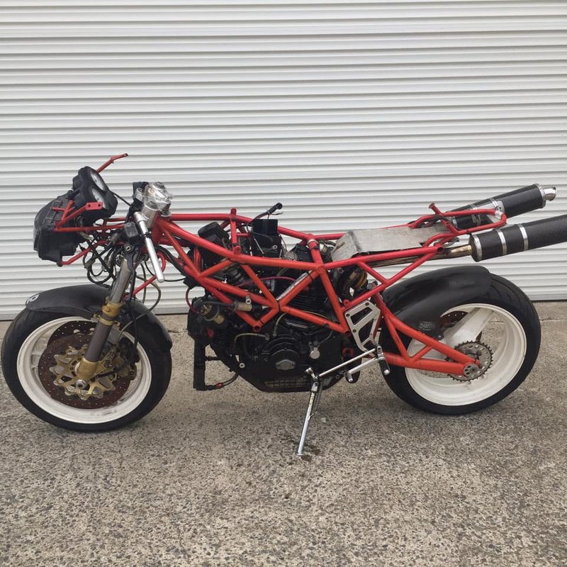

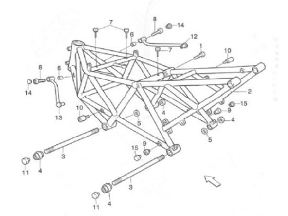

Rebuilding my DB2 half fairing and currently test fitting the top/main fairing
Can anyone who's got one explain how the front stays work. (parts 12 and 13 in attached diag from the parts manual)
When I got the bike (Centre Point Australia!) it had the arms attached (see above) but I dont put much faith in anything they have assembled as my bike had bits missing and incorrect parts fitted when I got it (quite apart from the more obvious missing bits!)
I am assuming that one end is bolted to the main frame (in place of the normal bump stop) and that the flat pad end (photo 2 goes against the fairing and the indicator securing screw uses that as a fixing point?
In any case would appreciate confirmation on this

Sorry Jaguar. Somehow missed your post.! Thanks for your offer in any case.
The fairing mounts are basically as shown in my photos and yes the indicator stem fixing screws go into them. Didn’t help that my LHS mount had a slight bend in it . Managed to bend it back to almost the right position and then use a rubber washed behind the fairing to bridge the small gap left. Onwards and upwards!
