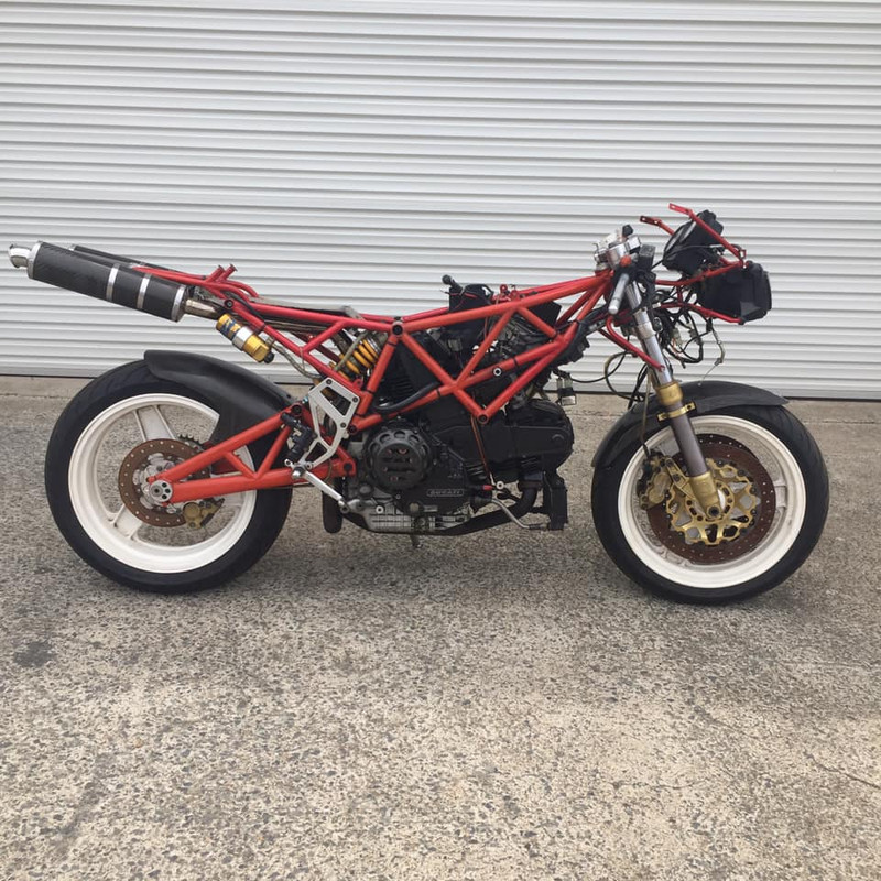

but....eventually with a Bimota shaped hole in the garage I succumbed and took pity on an early DB2 (half faired) that was on sale at Centrepoint bike dismantlers (sorry sales!) In Qld Australia.
As is obvious from the photos, not actually a complete bike (we are talking Centrepoint Rolling Eyes ) but I've always liked the idea of a HF to show of the classic Ducati engine and decided that as 'retirement' looked to have overtaken me I should have a 'retirement' project (or at least another one!)

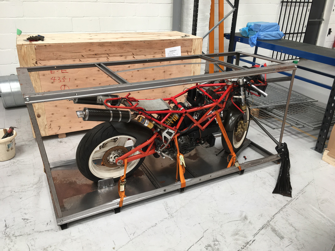

Well after some negotiations with Centrepoint (why advertise 'best offer' then refuse to budge below the posted price?) they actually were pretty quick in crating and despatching.
Some weeks later I scuttled to Southampton to take delivery of my crate (I used a friend's warehouse so I could unpack there and bring the bike back in a van... cheers Kevin).
Soon unpacked
The good parts were still there, aftermarket exhaust from headers back wards and the Mikuni TDMR 40 carbs
even the full key set
and some miniature Vegimites.. (don't you just love those aussies!!)

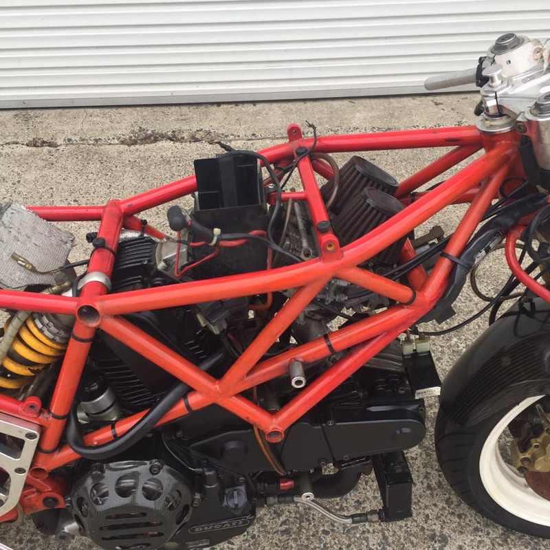

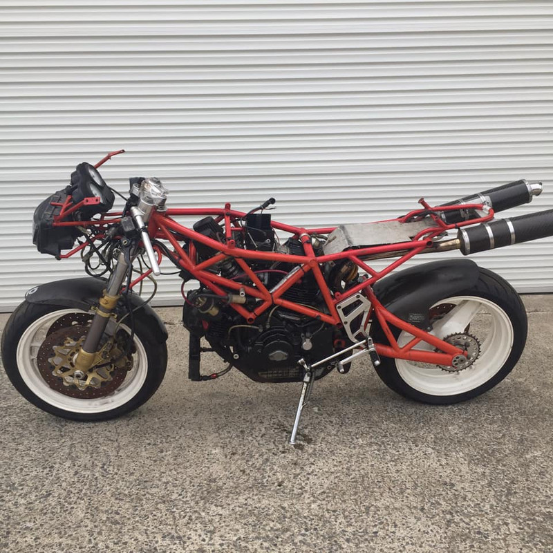

However a quick once over showed that along with missing items (seat unit and fairing (incl indicators and mirrors) petrol tank, chain, throttle assy and reg/rectifier there were signs of worse than hoped for corrosion. I think Japanese bikes can be either beautiful or to be frank worse than those in Europe in this respect. I think the fact that many bikes in Japan are kept outside in cortyards (garages a rare luxury for many) and that they have coastal cities with some very humid summers and wet winters doesnt help. You also see a few horrendous bikes on Yahoo.jp that I can only assume were caught in the great Tsunami of 2011 (although not suggesting that with this bike.
In contrast the front end around the headstock was liberally lubricated and looks like blown seals on one/both steering damper/forks.

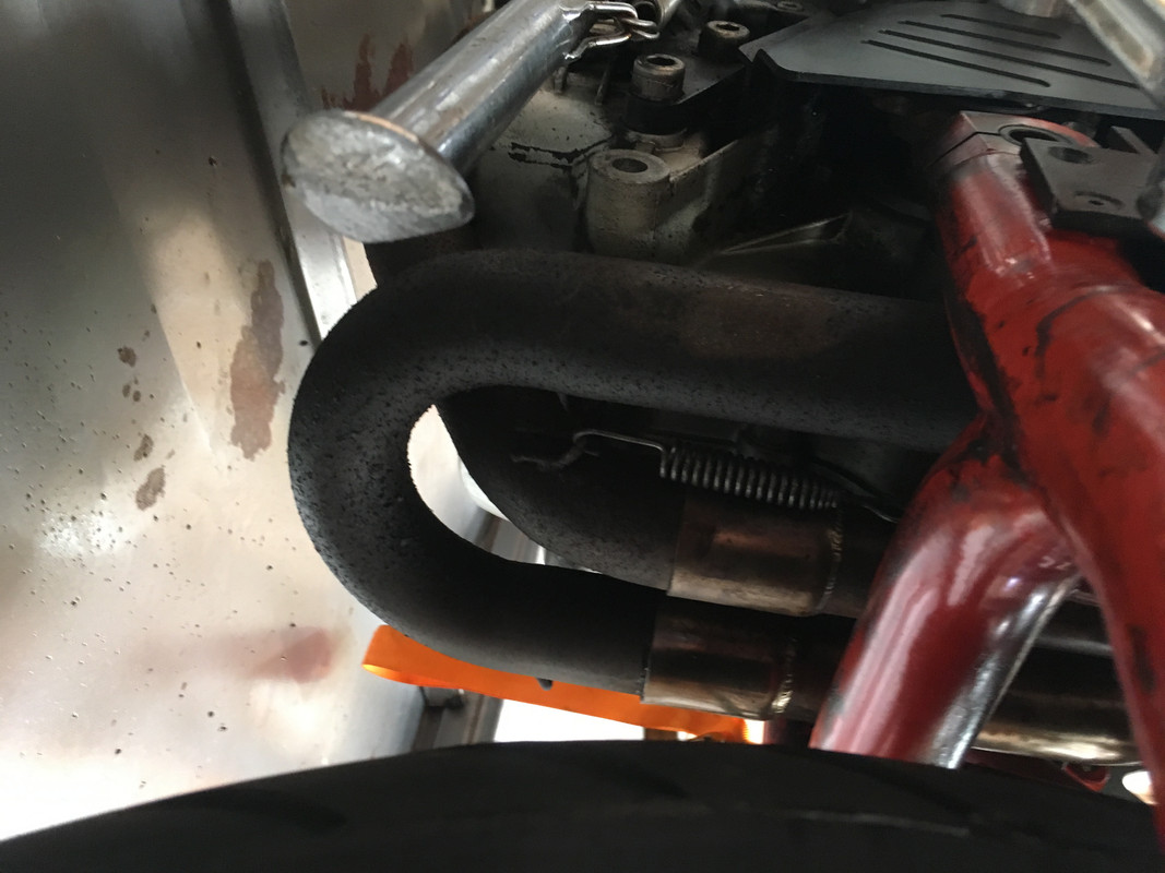

But look at the exhaust and fasteners. Mmmmm!
and frame paint seemed very faded
as did the rear shock (probably performance and cosmetics!)

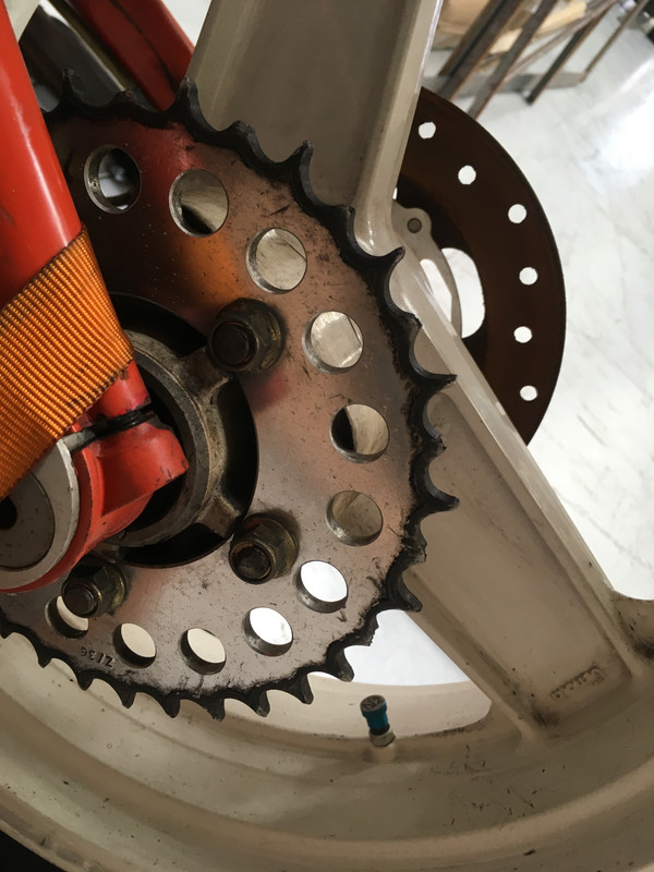

..... and as for the rear sprocket!!!
I'm pretty sure I knew what had caused that but for now it was time to tidy up the warehouse and van the bike back to sunny Monmouth!

Looks like it might have had the wrong pitch chain on it at some point.

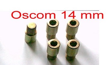

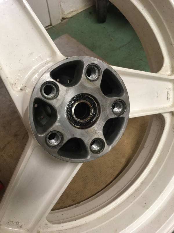

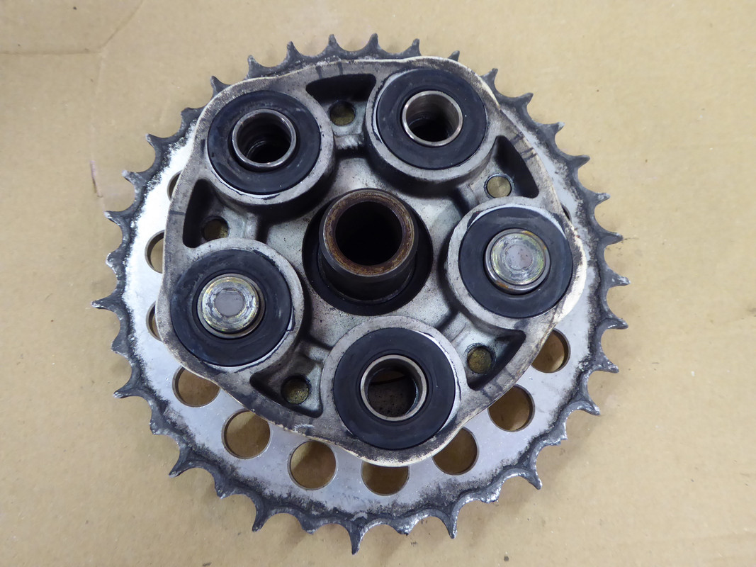

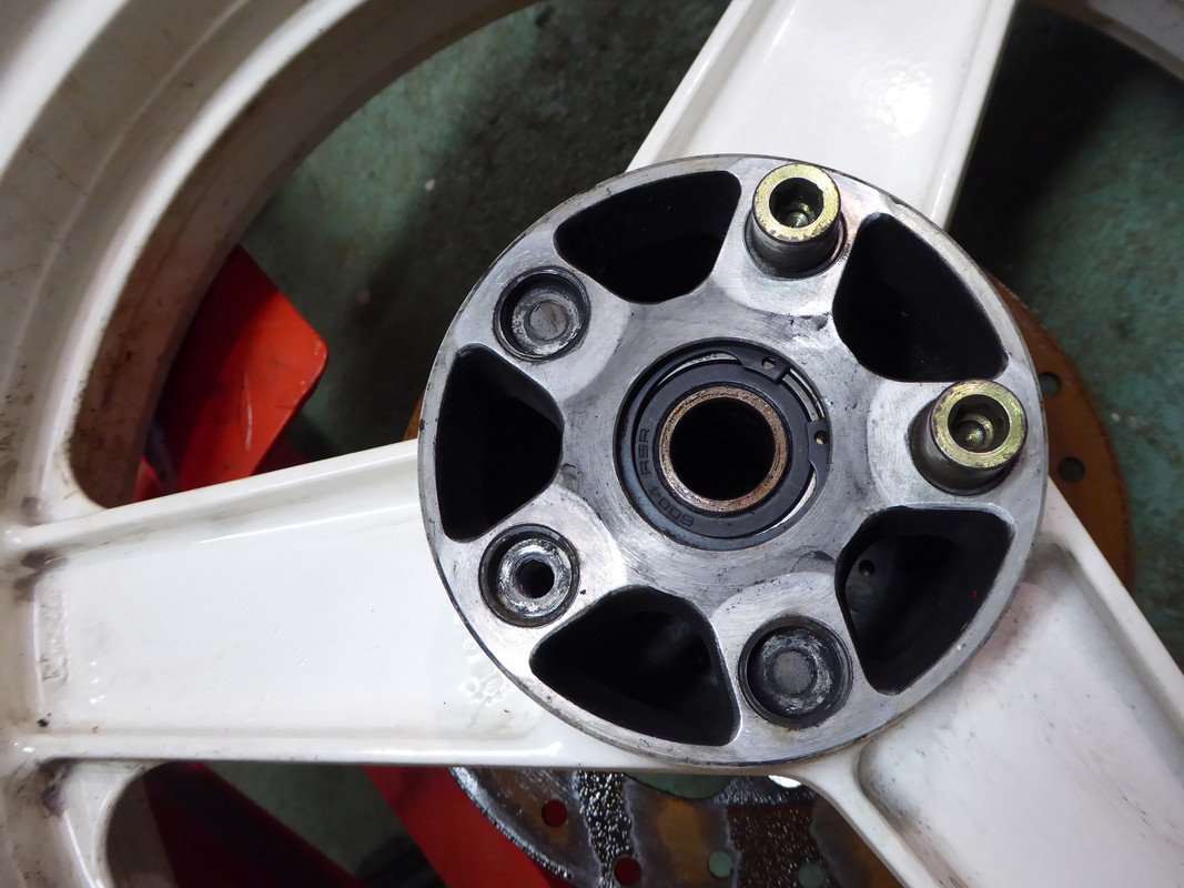

This is the very likely reason for the sprocket damage!
There are only two of the five cush drive pins still operating (sort of). Two have sheared and one is 'missing' altogether. As there is no way for it to escape I can only assume that the 'missing' pin was also sheared and in the dismantling of the bike for shipment to Centrepoint in Aus (or their 'rebuild' LOL!) it went walkies.
OUCH!!
This was a known issue with the originally fitted pins which only had an M10 thread into the wheel, clearly not up to the V-Twins Torque delivery! (although this is the worst I've heard of) The factory I believe changed to M12 and finally M14 threads in the course of production. Fingers crossed I could source some of the upgraded parts (also replacing the rock-hard, aged rubbers at the same time!) and that the wheel itself could be rescued.
Joined: 05 Dec 2009
Posts: 564
Location: NE London
PostPosted: Fri Apr 17, 2020 9:50 am    Post subject: Sprocket damage Reply with quote
I caught my Oscams early and just re-coiled the holes in the wheel and re-used the original pins. I’ve had 30 ensuing years without issue. It wasn’t that the pins weren’t up to the job, but they couldn’t be adequately tightened in the ally wheel.

PostPosted: Fri Apr 17, 2020 11:04 am    Post subject: Re: Sprocket damage Reply with quote
Is that on a db or sb or by bimota??...same wheels used on all 3 but I've only seen issues on the db series.....mine had one sheared bolt....but no head of the bolt on there....so dome muppet saw the issue...and thought....naaahhhhhh.....4 bomts is fine....ill6jyst remove the head anyway to scare the next new owner.....then he'll check through the whole bike when he finds this....and I did...

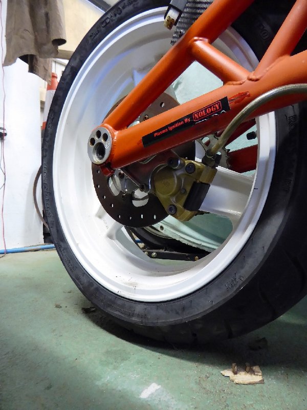

Well, I managed to get the wheel repaired at a local shop run by a long retired ex speedway racer/engineer. Mainly busy with classic and vintage car stuff.. Workshop a collection of old lathes, milling machines, swarf and shelves upon shelves of well thumbed manuals and data books. He doesn't advertise and nothing outside his unit to indicate... took me two attempts to find him!
I think he only took pity on me because he likes bikes! Says he prefers to stay hidden as he's got more than enough work to do and 'old stuff' never takes less time than customer thinks it should!
Anyway after 90 mins of charged work I had a wheel back with broken bits extracted and M14 THREADS IN PLACE! Very reasonable since he had to extract the sheared pins and then make a tool to centre the drilling and tapping. One thread was touch and go due to previous damage but I managed to screw in a new M14 'test pin' to all threads before taking the wheel home and packing it off to the powder coaters.
The cush drive pins with M14 threads!!

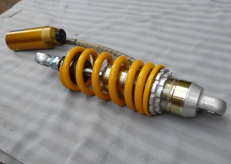

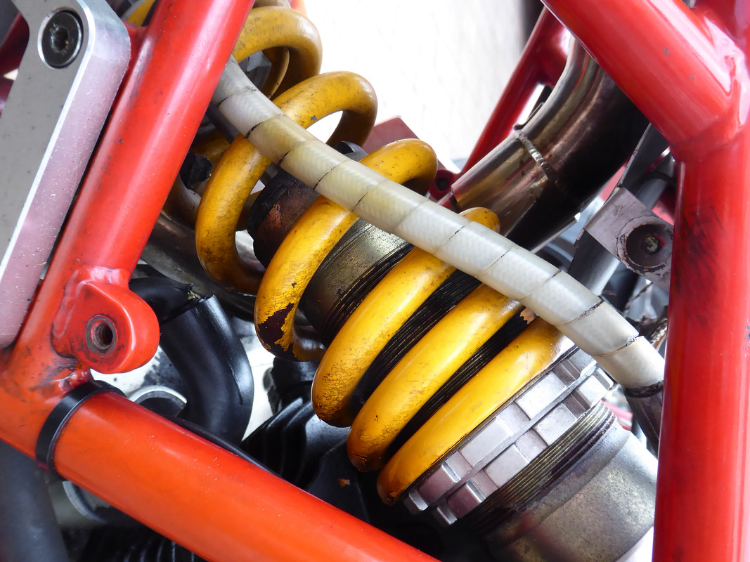

Of course at the moment its very difficult for anyone with a project using outside resources (ie about 99% of projects !) Either the supplier is closed or one of their sub-suppliers/subcons is closed. Currently I have suspension, frame parts and an engine 'in limbo' at suppliers and bits I cant send out even if I want to. Ah well better times will come and at least there are no event deadlnes to work to and last minure dashes to IOM TT or Spa Classic! Next year methinks!
Anyway nice to report the small successes as they are.!!

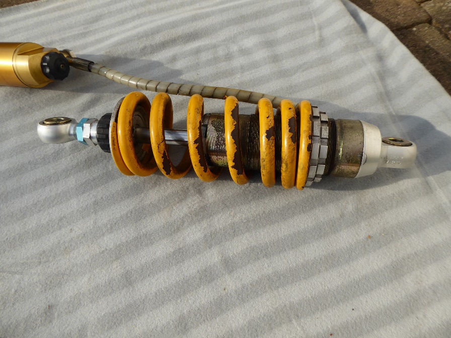

Rear shock.... was in a SHOCKING state! (please excuse)

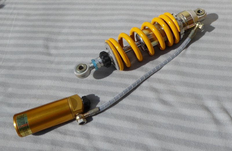

and then after a full rebuild and refinishing
oops! and now with some new cable-tidy/spiral wrap!
The forks are also in for a rebuild but when I picked up the rear shock (4 days before the big lockdown) the forks were still at a subcon who had just gone into self isolation. Very happy with the rear shock so hopefully good things do come to those that wait.

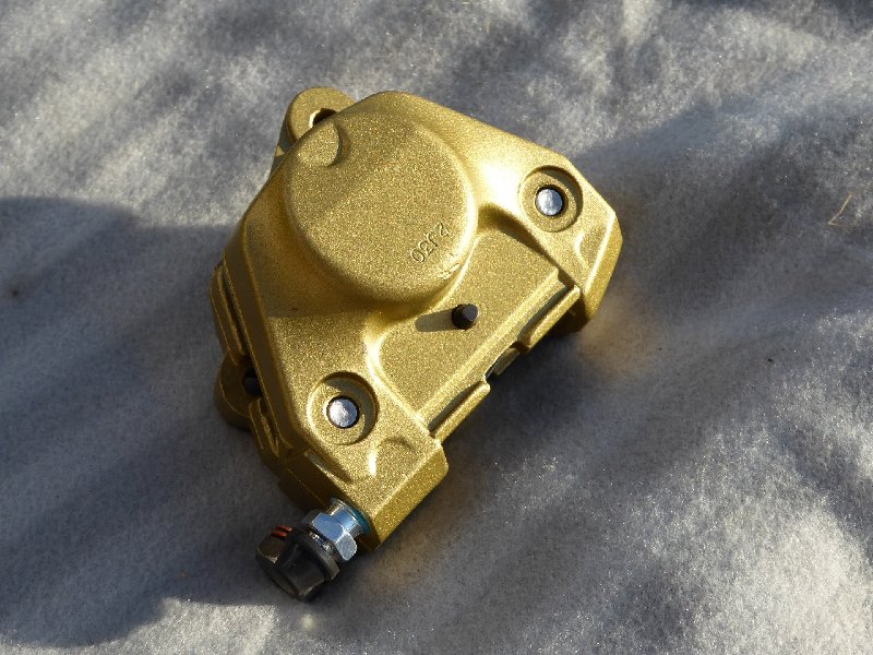

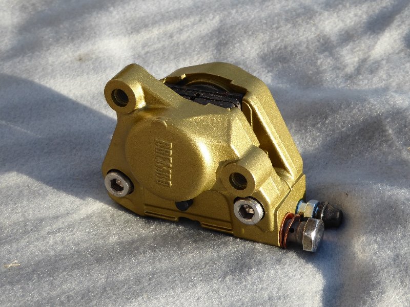

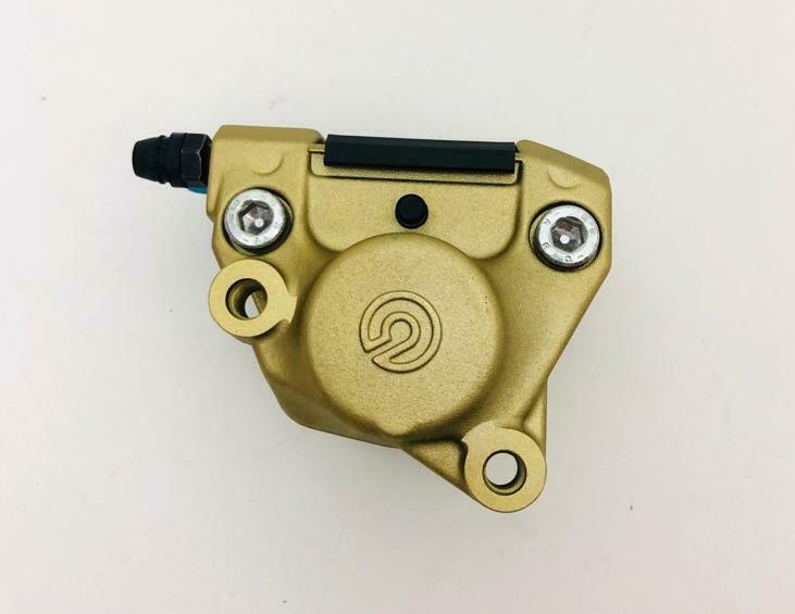

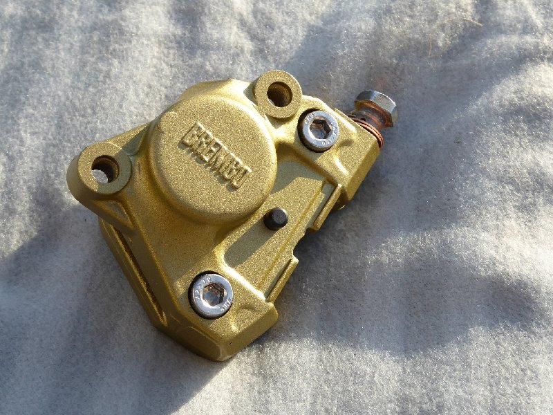

The rear caliper needed servicing so looking at seal kit as a minimum. I never seem to have much luck with pistons and seized bleed nipples (painful!)...its also very hard to get the original gold finish back to a nice state once grubby and ingrained. (The caliper was worse than the photo suggests)
I could have bought a new P32B caliper (£70-£110) but the newer ones dont have the 'Brembo' script on them (just the logo as per the pic below) and I wanted to keep the looks original.
In the end I went for a full service/recondition by Powerhouse (advertise kits and rebuild services on EBay and elsewhere) £78 and returned in 10 days from me posting. Very pleased with the results.
another piece for the 'clean shelf' ready for the rebuild!
