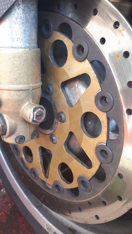

It turns out that the later YB9 SRI used different forks and discs than the original YB9.
Mine has 43mm forks as opposed to 41mm on the earlier models but the discs are also different.
I was on to Rudy at Bimota parts .de as 2bims recommendation was good enough for me but his YB9 discs are different to mine.
As best I can measure with the discs still on the bike my offset is only 5mm as opposed to 26.5 and the disc centre is about 65mm as opposed to 80mm on those.

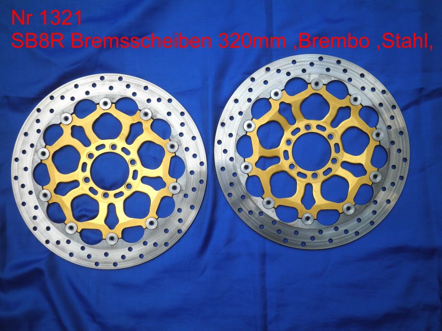

In the middle of writing this I have been looking through his site and just seen that he has a pair of secondhand discs for an SB8R which just look to be more like my size..... I am going to ask him now if he can check the measurements on those as he did not specify the specs for these.
And would any SB8R owners be able to confirm or deny what I am hoping to be a solution......or any other model that used this size??
My SRI front end
Earlier YB* front end
SB*R discs
And no need to point out I need to spend some time cleaning the bike, I know I do!

YB9SR had marchesini wheels, 3 spokes and cast iron brembo full floaters that I call Pizza slices and Pork Pie chunks....narrow hubs on the front meant deep dished brembo discs...you can always identify the offset by the pattern of the rotors used......
YB9SRi had heavy wide hubbed Antera 3 spoke wheels.....and thus used the flatter Pizza slice and pepperoni carrier discs.....Both the discs you've shown....Ducati 900 Superlight also used these.....Not the Mk1....but the original superlight....rare discs....The SB8R discs you've shown should fit and be the right offset as they are used by Bimota on bikes with the Same Antera wheels....Bimota Vdue, DB4, SB6R, SB8 YB9SRI....wheels are the critical key.....Forks are irrelevant....all are 320mm diameter....

Thanks Steve, my bad. I never realized the earlier yb9 had different wheels but it makes sense when you think of the widely different offset.

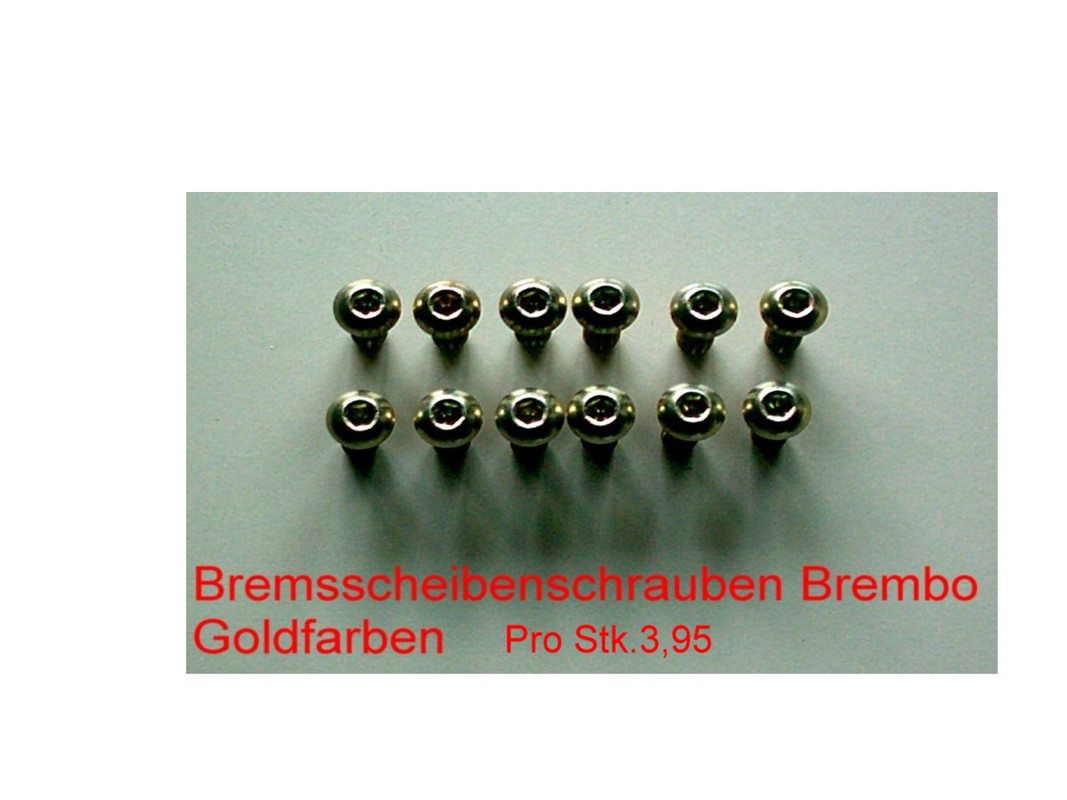

Anyway I will go with the SB8R discs so when I hear back from Rudi. I decided he was the man to deal with as soon as I saw the funky gold disc bolts he also has to match...

Yup....Rudolfs a good guy and can be trusted...only takes bank transfer last I bought anything...but that worked fine...and yup...you'll need new bolts when you try and remove the old ones they normally chew up like soft toffee in the midday sun

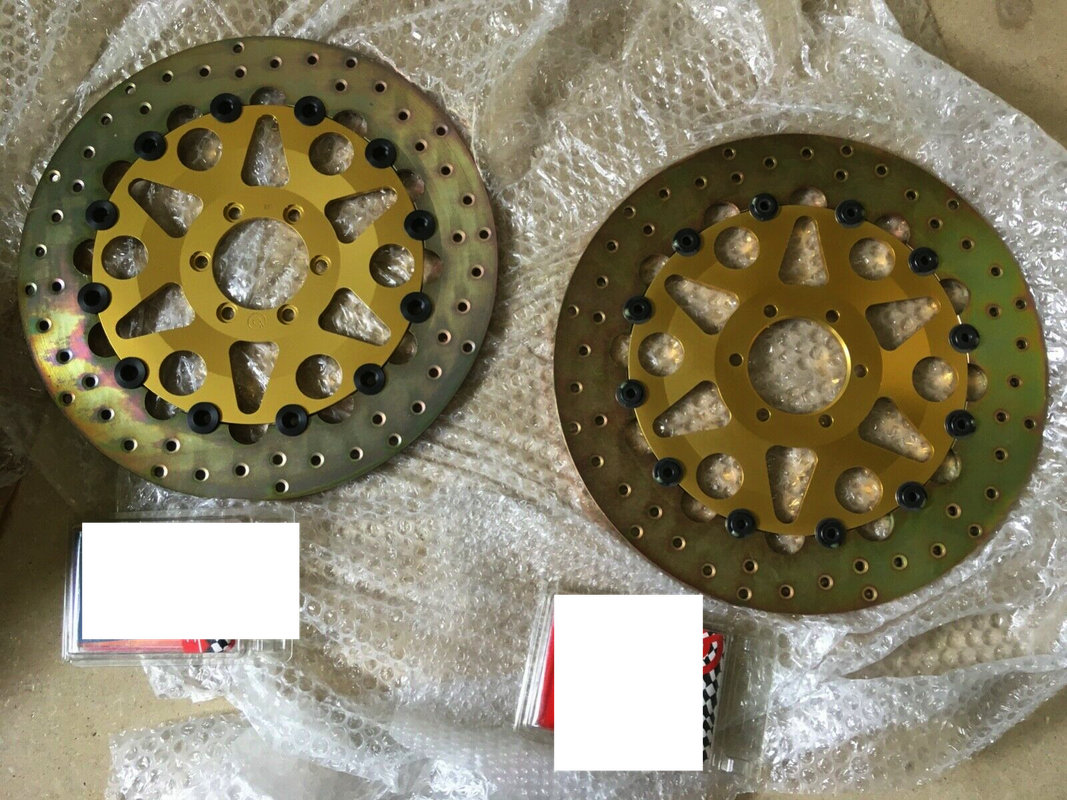

And then late at night you find these beauties which are superb and i want so much but not that much.... available here https://www.ebay.ie/itm/114787562620?hash=item1ab9df347c:g:ahcAAOSwb6tgi9WH
but landed to Ireland would amount to €1100 and change. cast iron and with sexy wear indicaters. Thankfully I am not drinking anymore cos the buy it now option and my wife's credit card details.... easy way to die!

They are lovely looking rotors for sure..... just under $1800 Au delivered to me Shocked
