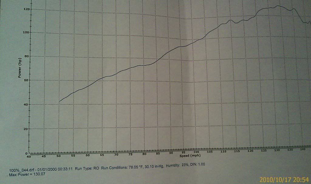

Update: After fitting a fuel pressure regulator at 40psi (to combat the massively over to the top 60psi pump pressure), the SB8K is currently getting a tune up with TPS and throttle balancing being done - current status is at 129bhp and a very nice curve getting there. I am to be honest over the moon with that especially as this exhaust is much quieter than the old one which got burnt out.

Update: bike has passed its MOT. Its showing just over 130bhp at the back wheel with legal exhausts now too. Cool

can you post the dyno maps?
or did you draw them by hand? Wink
I want to see where you got the extra 7bhp from. Very Happy

Hi GeeKay at long last please see below the dyno map...
