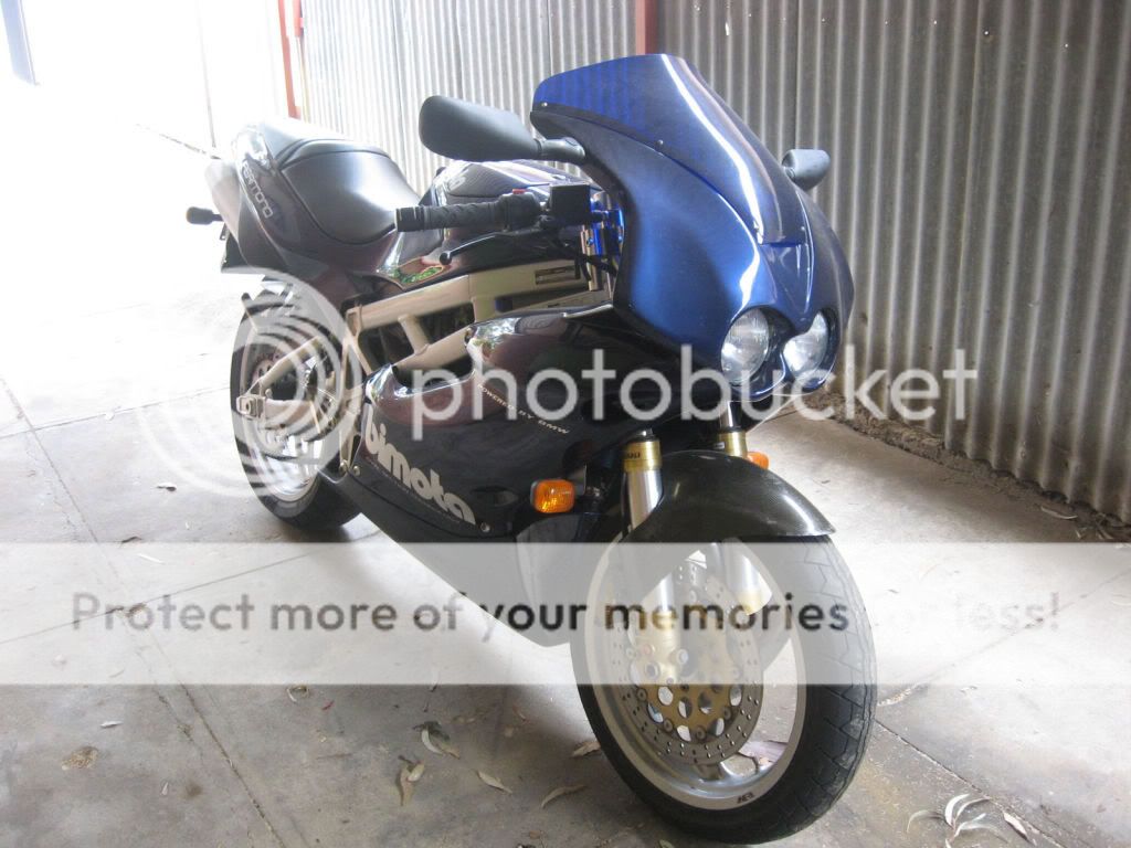

I dealt with the vibration by trying to isolate myself from it. I added another 1/2 inch of foam to the saddle and fitted 'convertibars'. These are admittedly a bit ugly for a Bimota but took some weight off my wrists and cut down the amount of vibration transmitted drastically.
http://i658.photobucket.com/albums/uu307/fearenside/bimota/convertibars.jpg
