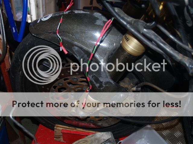

.The Mk1 crescent has been on the bench with it's fairing off for a couple of weeks now without any progress and it may soon be going to a new home so it needs to come off the bench, into the corner with a sheet over it but first a couple of little jobs that have been offending me.......
...first, chocolate blocks on the indicator leads....really?...
...soon sort those out. Soldered joints, heat shrink and extend them a bit so they are easier to connect up.....
...job done Wink

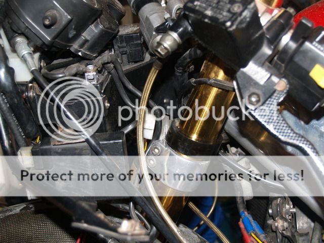

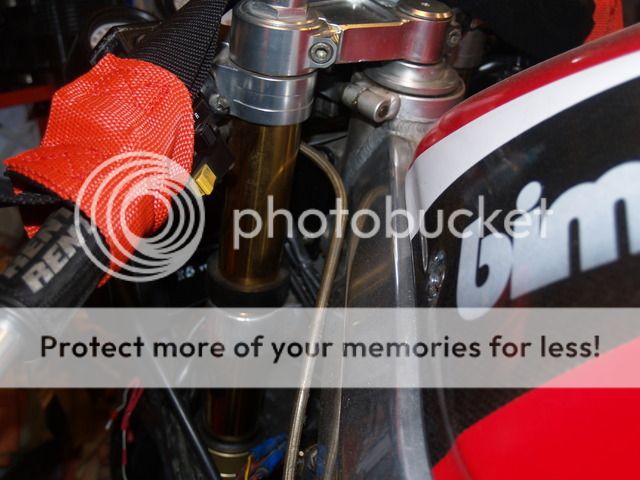

Next up, clutch hose is routed wrong. Catches on the fairing when the bars are turned Crying or Very sad ......
...off with the top yoke to make things easy.....
....re route the hose around the outside of the fork leg.....
and replace the top yoke with loads of copper grease on the bolts...
